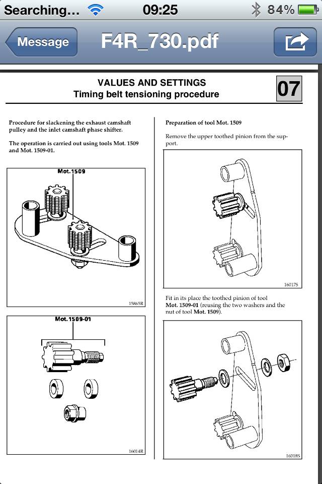

You used this tool?
Just worried as if not correct you could potentially knacker your engine. These aren't any normal 16v cambelt job.

You used this tool?
I've just brought that an the other required tools from renault 175quid, but as you said do it properly or it'll end tears
