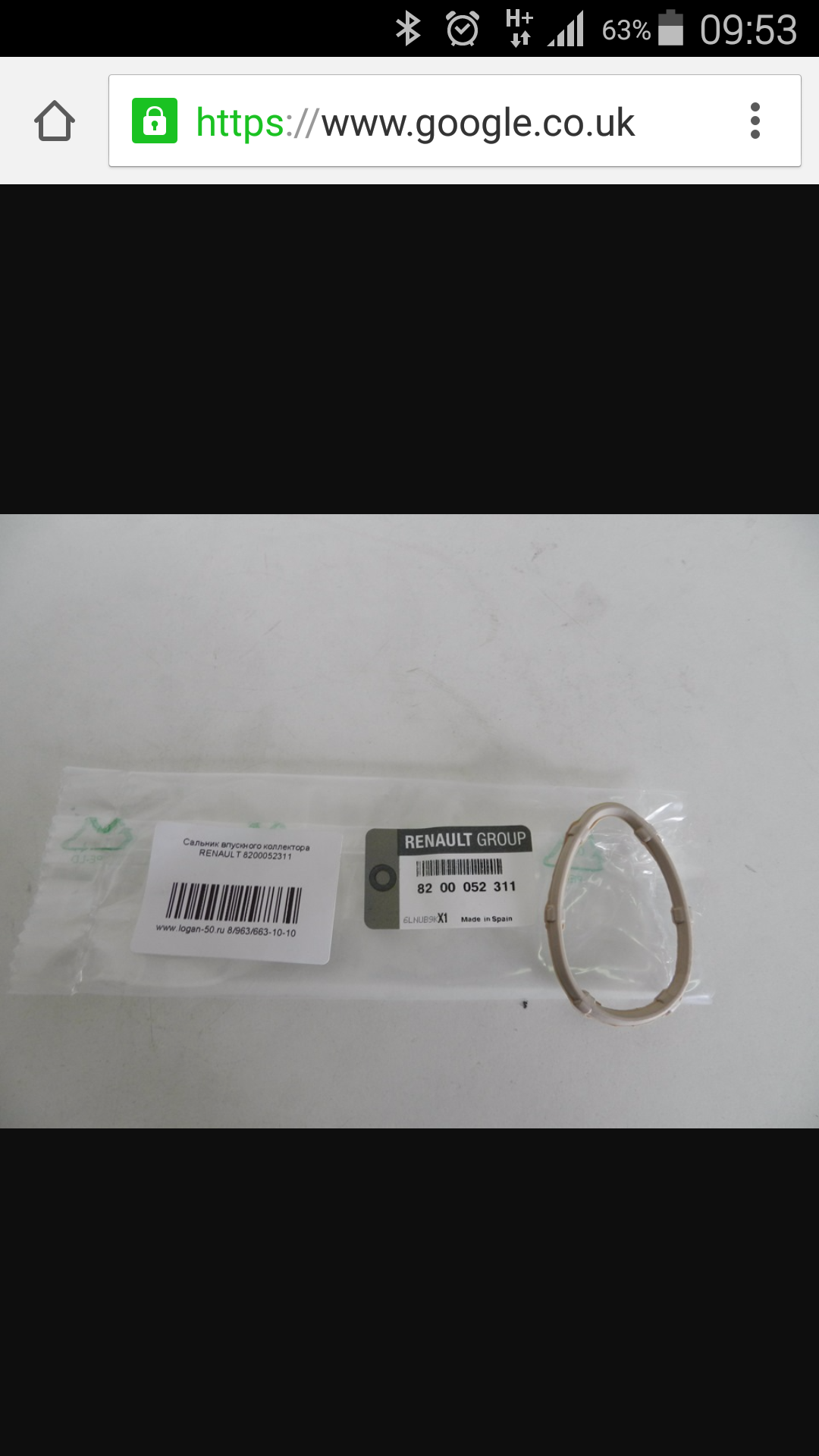

Hi guys is there anyone on here that knows the part number of the manifold seal that sits between the engine and inlet manifold? And the best place to get one other than Renault themselves? Cheers Richard.
The lower inlet manifold or the egg shaped gasket on the top of engine to upper inlet?
Here you go
No worries, had a bit of work done and car now idling at 2500. Removed top part of maniforl and discovered ring missing and a load of instant gasket badly in its place. Think this might resolve issue
It certainly should do, I did some work on one a while ago with the exact same symptoms (albeit with higher idle speed) and once proper gaskets were in it ran spot on
