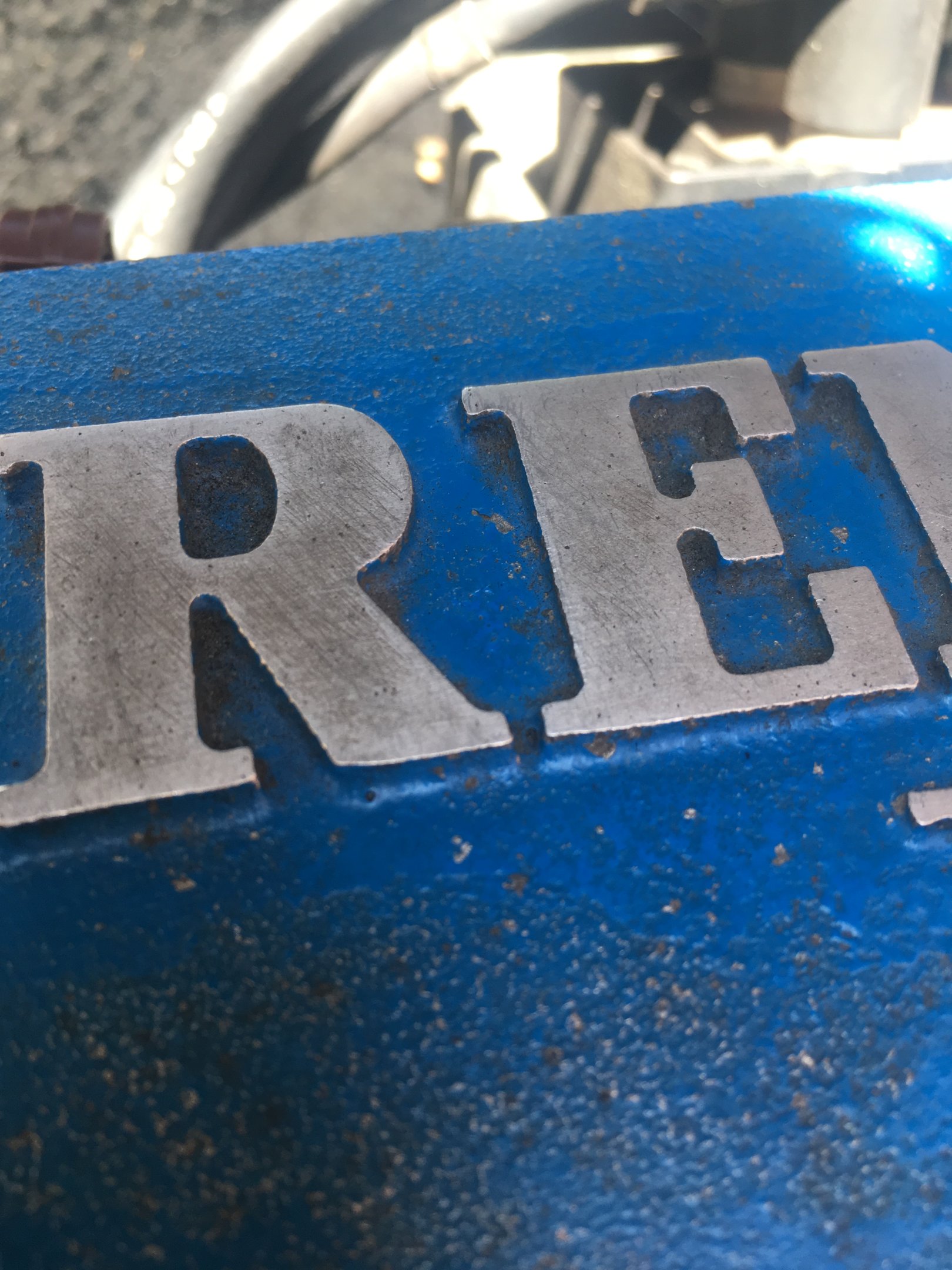

Just about to spray a few parts but the inlet on mine came with some naff blue brush on paint and is not very neat around the letters, also the letters looked pitted. Anyone have any advice to make sure the job is done fairly neat?
chris blue
  172 Ph1 2001
just stripping a set of inlet manifolds with an electric drill wire tool, and its doing a good job
Will then use gunk degreaser and jet wash, fine wire wool
Was then going to use suitable (Manifold) high temperature paint, probably silver, but if I use a different colour would spray the whole lot, then carefully file off the paint on the wording.
Unless someone can advise an alternative method
I have some spray paint stripper Ill try, its not bad it managed to just about get most off calipers with some scrubbing. This paint looks quite flaky so shouldnt be too bad really.

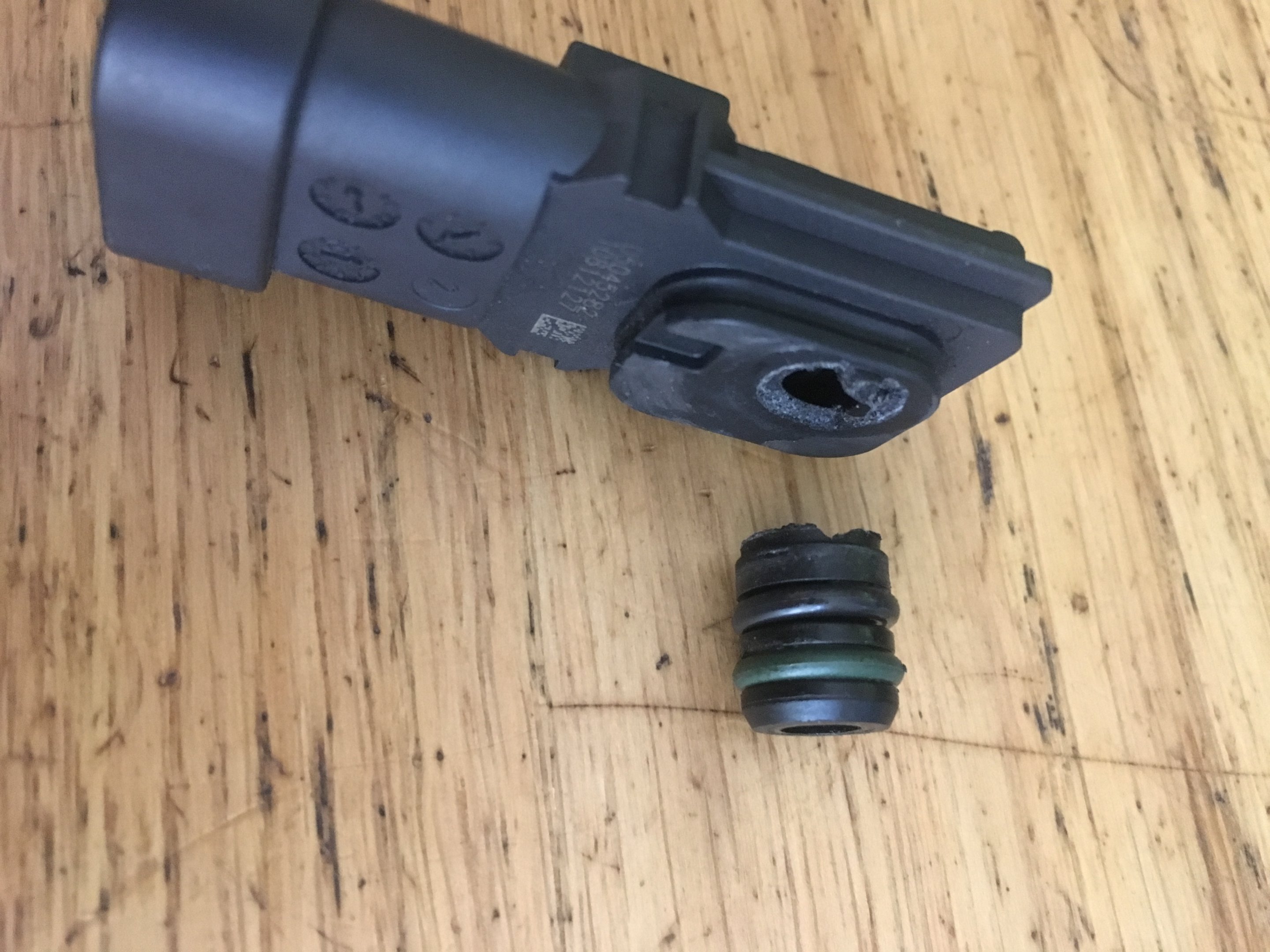

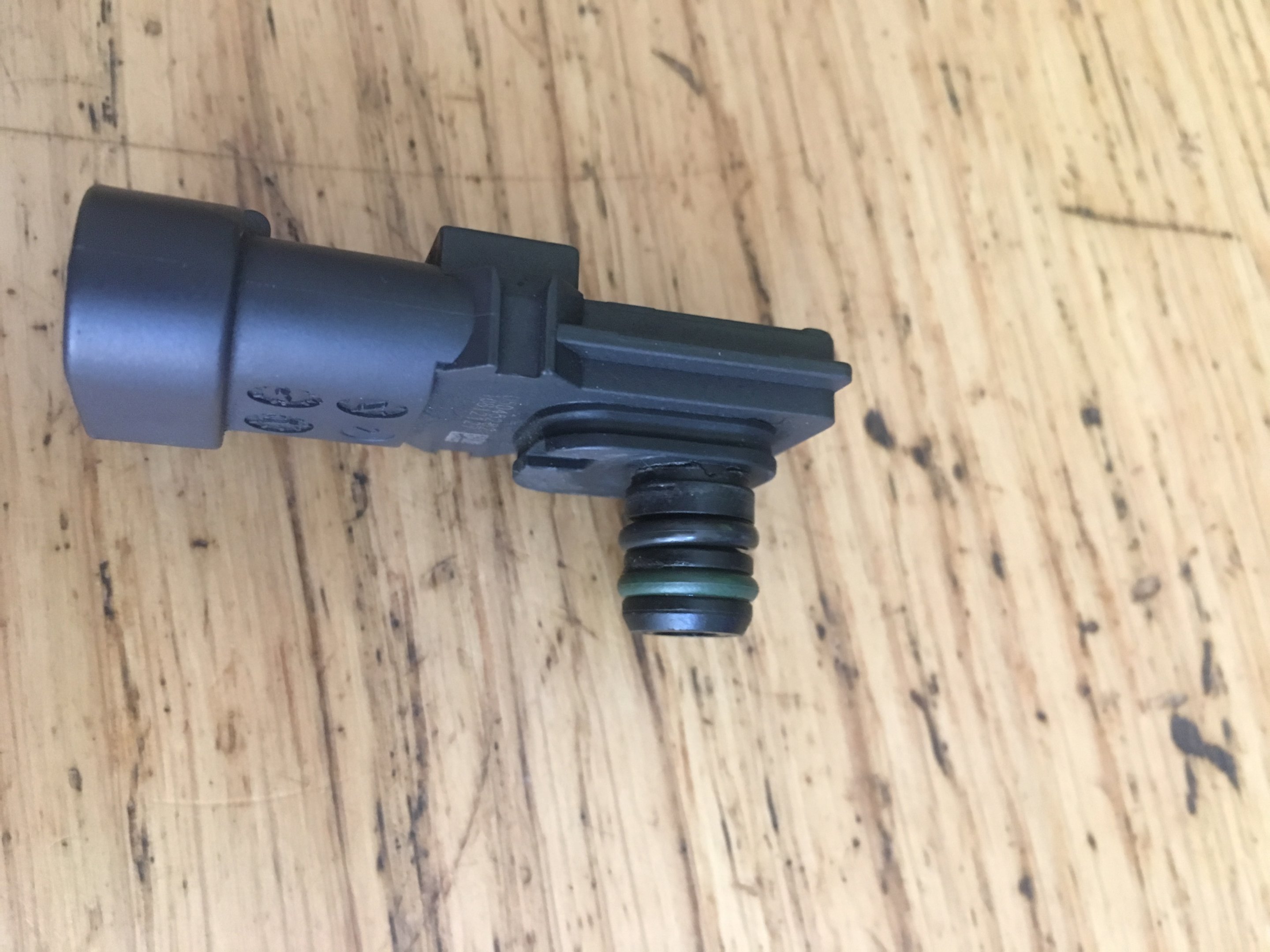

I left a goddamn bolt on! Well in fact I undone one on top the cam cover instead ? All off now though and broke map sensor :)
