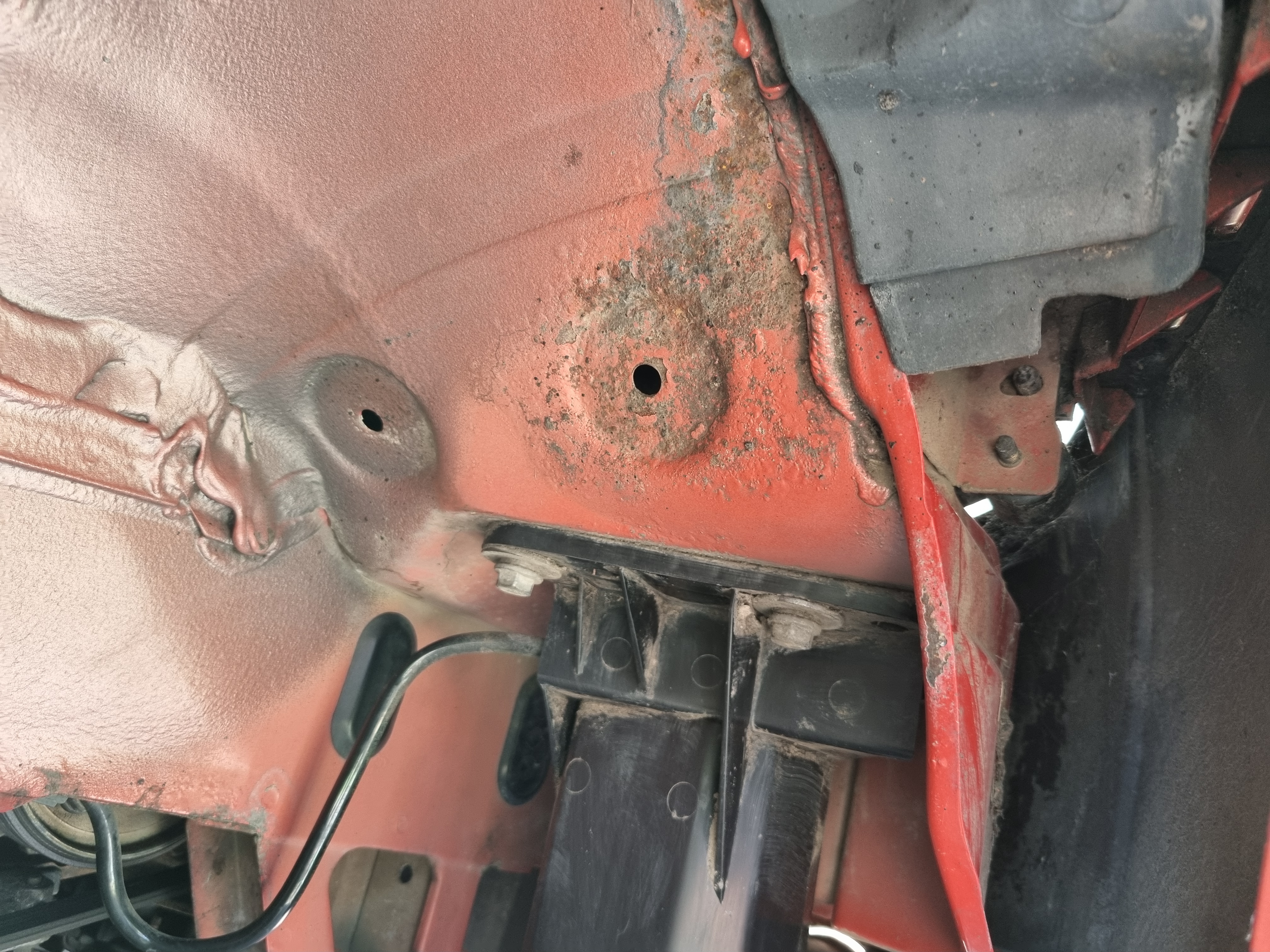

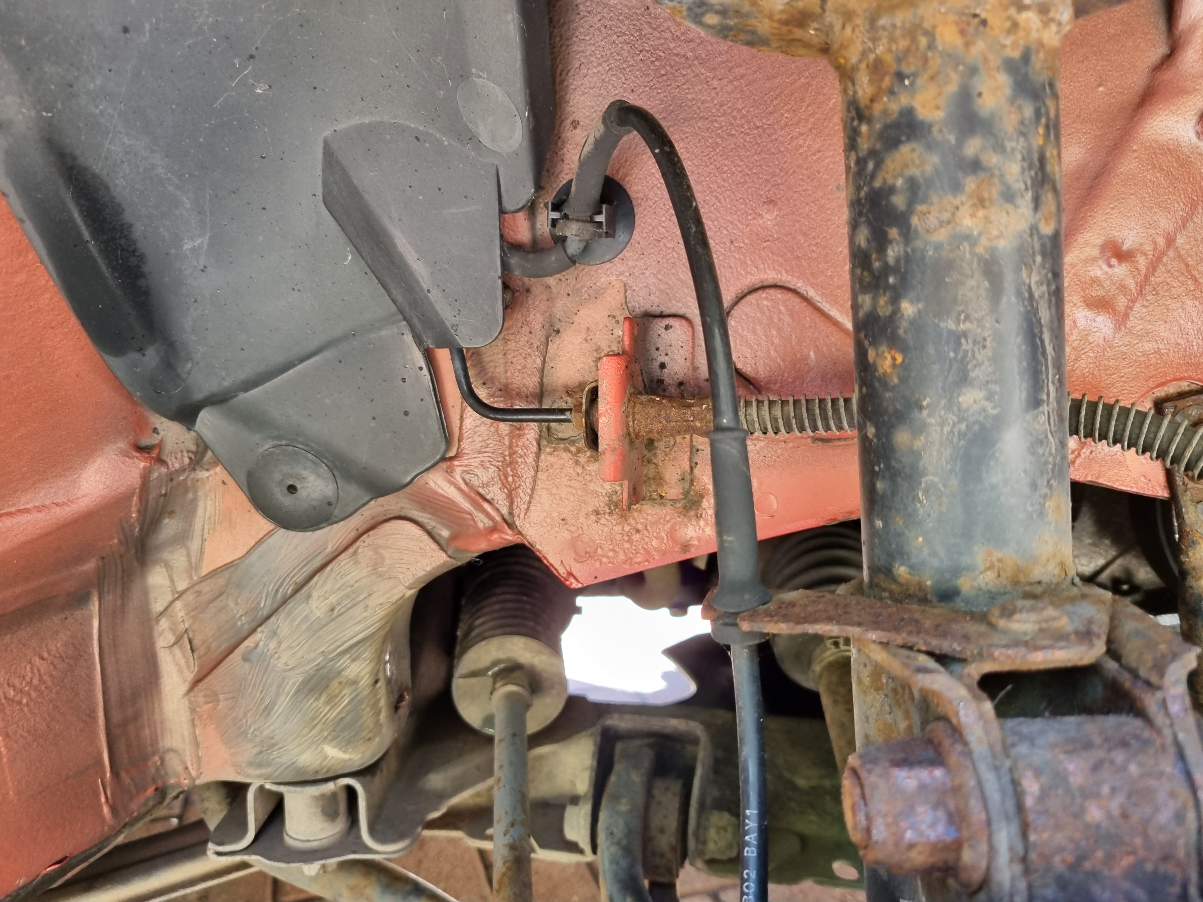

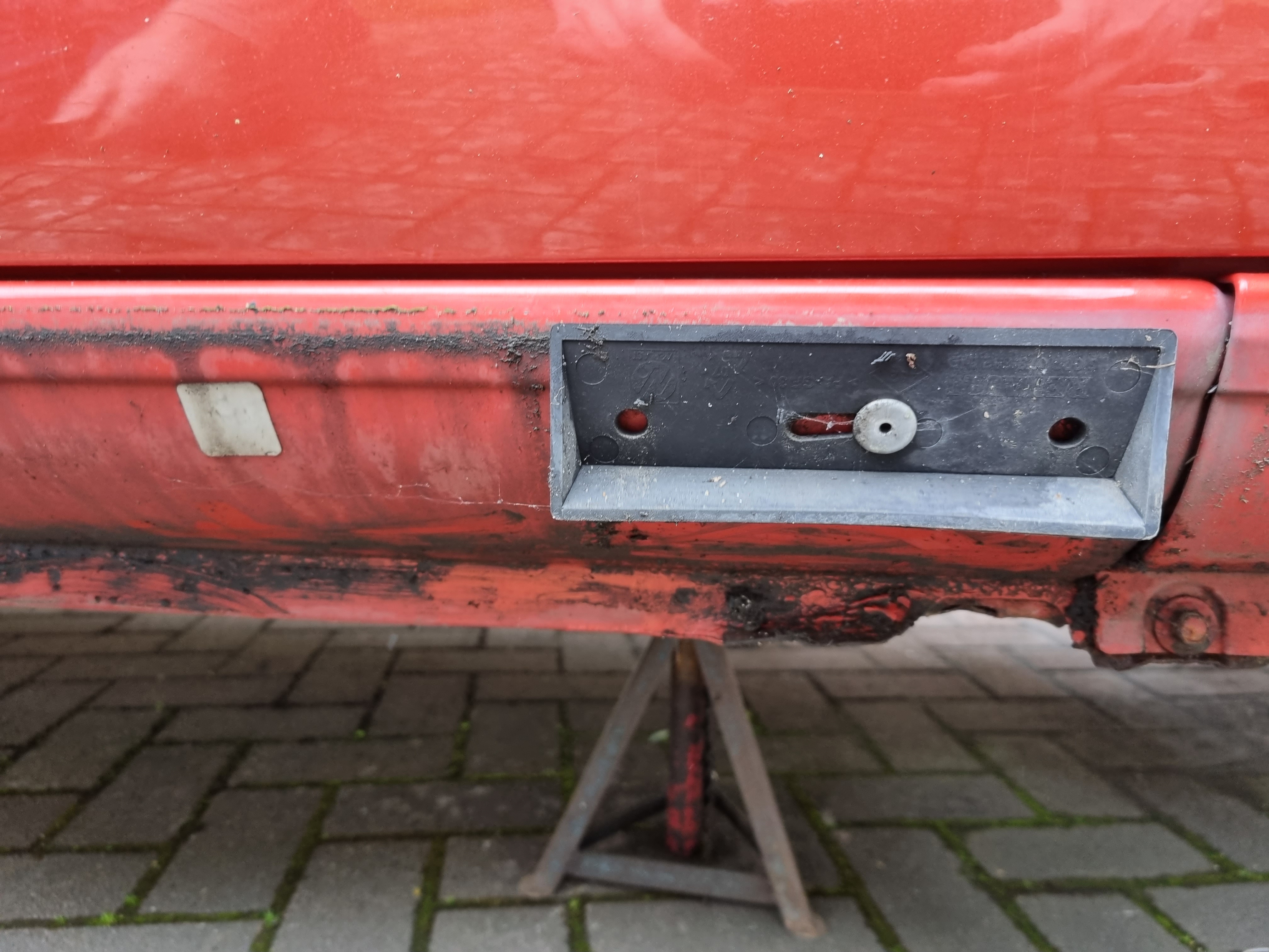

Hi all, been gradually going through my 182 (when the weather allows), cleaning it up and removing the worst corrosion where I can see it. In the front wheel arches there is corrosion behind the front liner and also a small amount along the back edge.
However I am a bit stumped about what to do in terms of finishing / painting. So far I have been using Electrox primer and then coating with Inferno spray paint. However, the wheel arch is a much lighter colour so I am thinking that it would look quite patchy with inferno bits here and there so I only see three options:
1. Inferno Spray the whole arch (not massively keen)
2. Inferno Spray the bits that need doing (might look a bit patchy, however not a massively on show anyway...)
3. Underseal the whole thing (also not massively keen)
Just wondering if anyone has any other suggestions or examples of what they have done.
Many thanks.

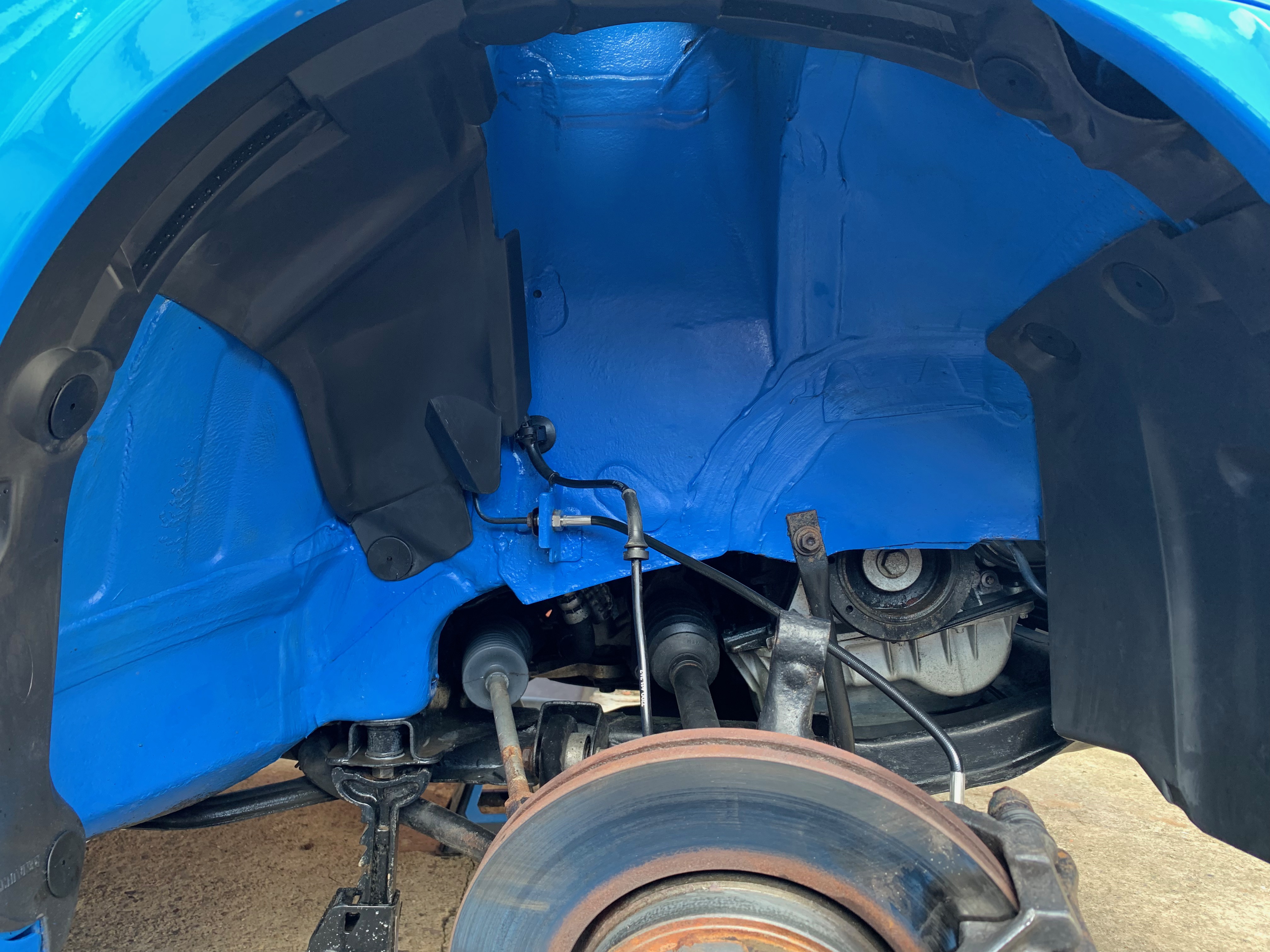

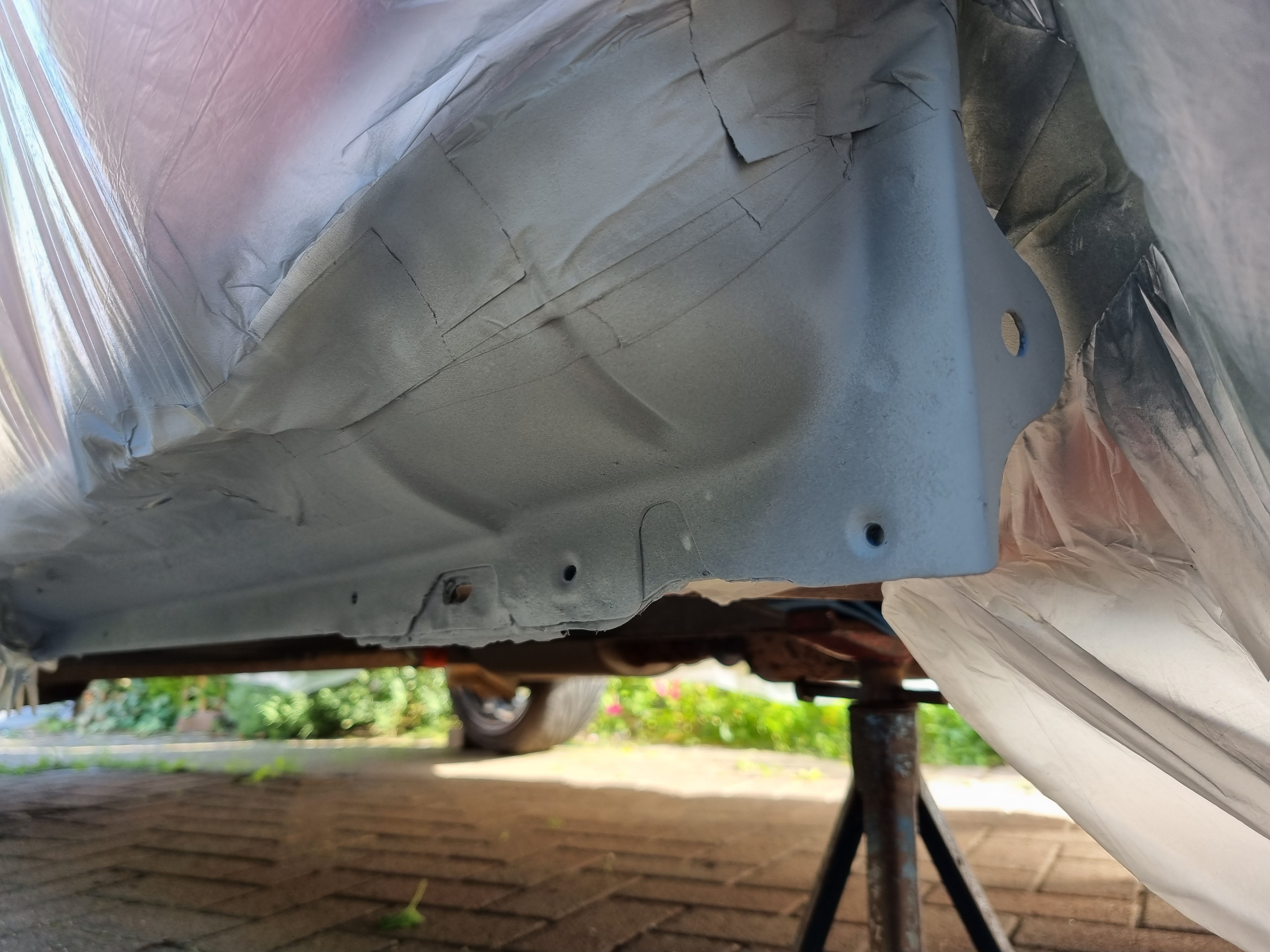

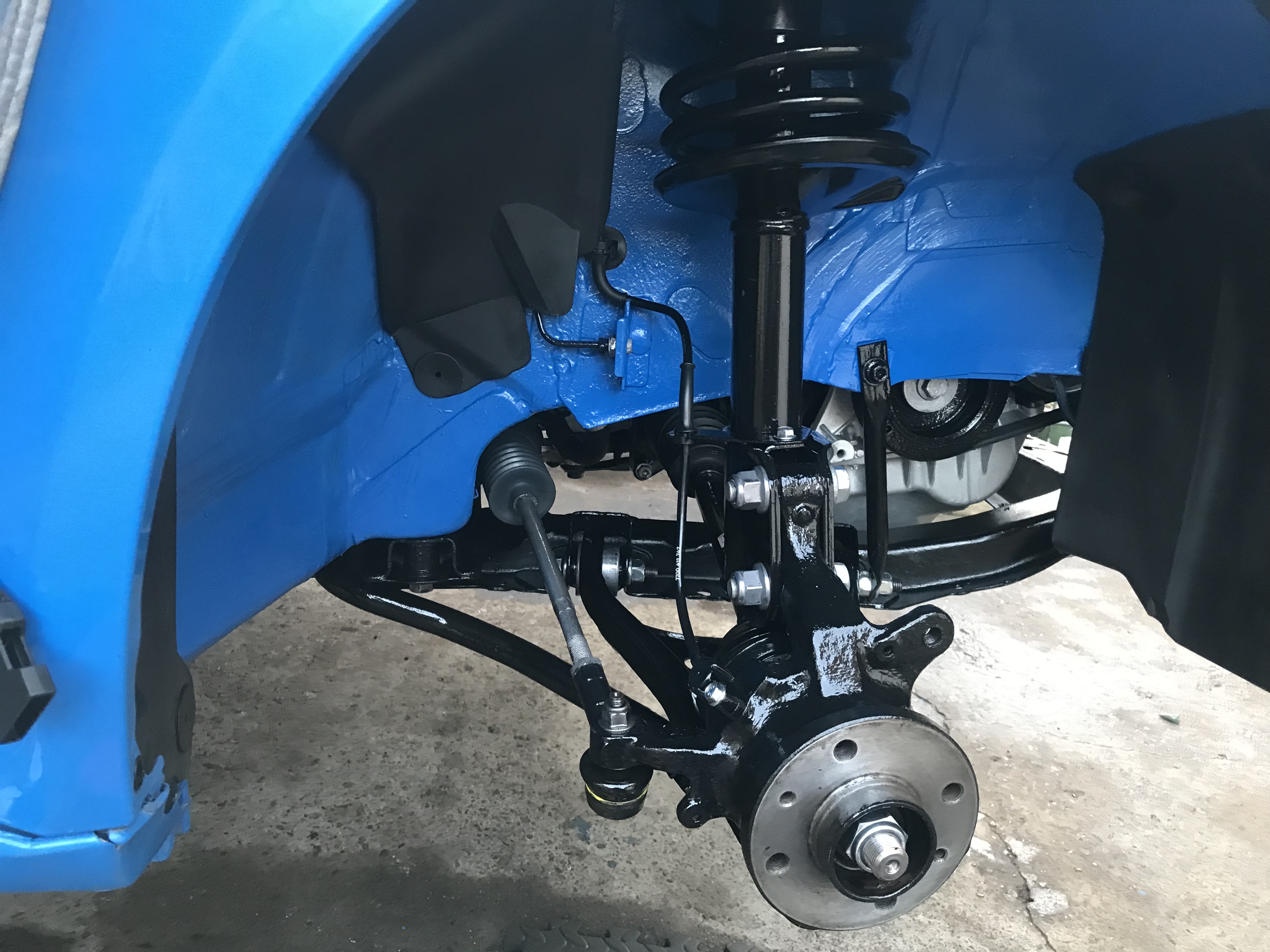

And this is mine 18 months later. Took this shot last Saturday after a quick wash down with Atom Mac and dried it with a cloth. I've since touched everything up again so it now looks like the above shot.
1. Degreaser
2. Agitate corrosion
3. Hydrate - 80
4. Electrox primer
5. Aerosol of paint for local store brushed on
The car is used on the road over the summer and stored outside over winter. I just keep on top of it and top up ACF-50 on other parts.

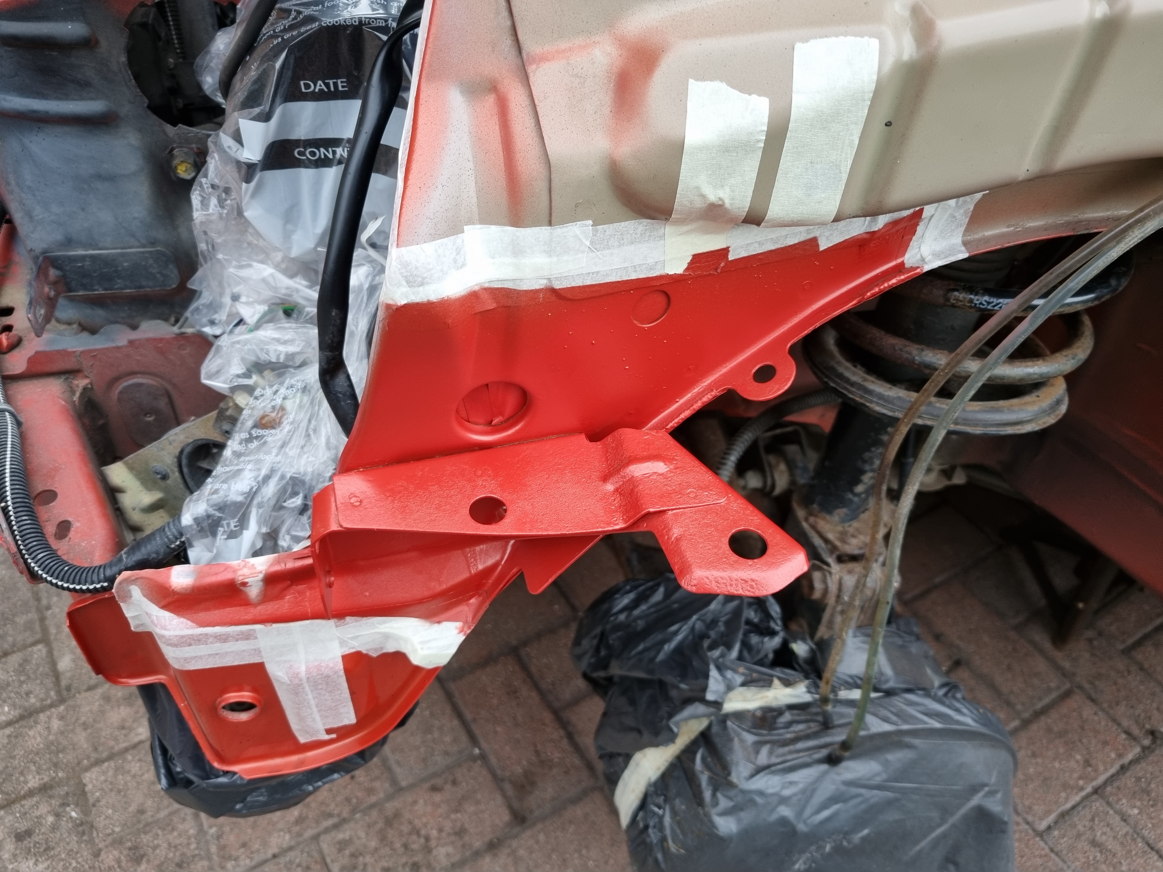

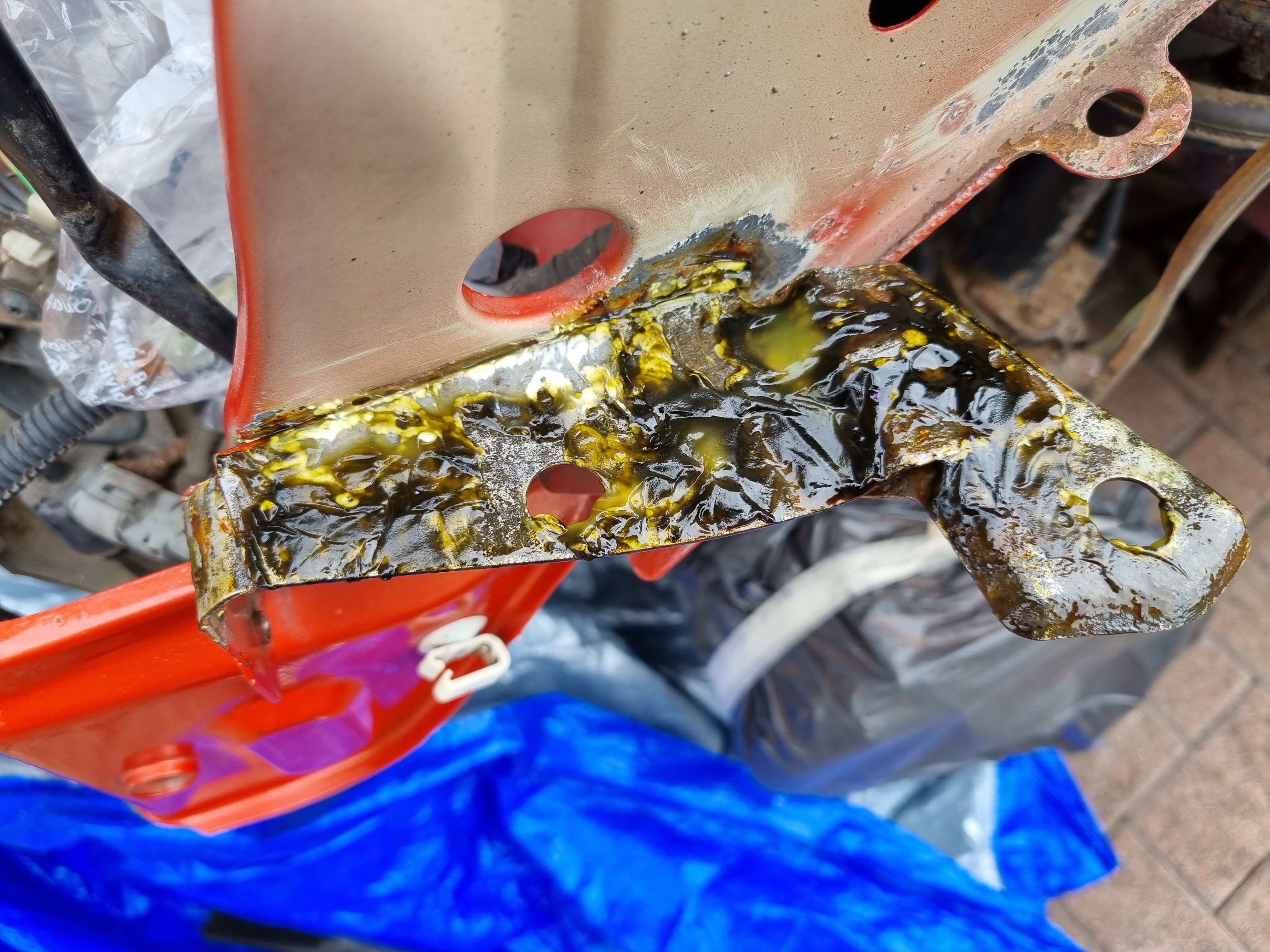

Thanks both of you, like you say it won't be that visible anyway with the wheels back on, I'm probably just overthinking it as it's my first time doing anything like this. I do think painting the whole thing is probably the best option, I was just worried about how "loud" it would look.
Love your work on the rb, been following your build thread for a while and it's top notch, I want to be that good!
Got the whole front of the car in pieces at the moment, already done the front bumper brackets (they were pretty bad actually), and started the sills yesterday, again don't judge the work 😂.

Yes. Epoxy on pretty much all those parts.
The process i used on those parts were:
1. Degrease
2. Descale
3. Deox-c (on really rusty stuff)
3. Hydrate 80
4. Electrox
5. Expoxy
6. Paint (where applicable)
The only one that I didn't do was that wishbone stabiliser and you can see how it's started to rust around the bolt in my 18-month-old picture. Other than that, it's been amazing stuff. I don't drive mine in the winter though, so not overly exposed to salt etc....
