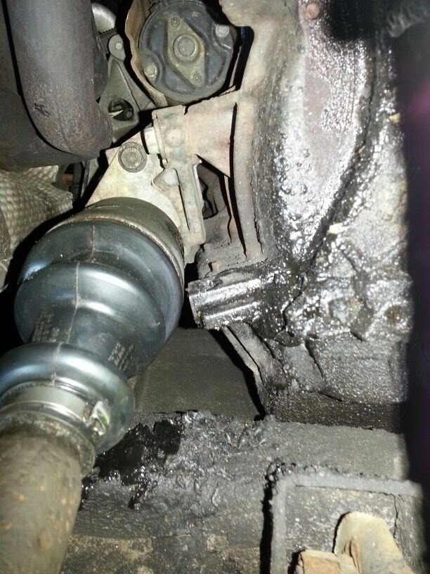

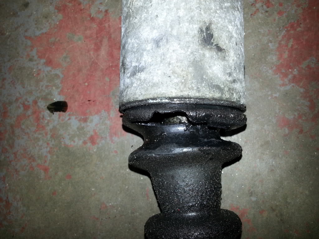

JHi all.. just been down to my mate to get my drivers side driveshaft replaced for the 3rd time, so the 4th shaft the car has had in a year!!
Had a look to see why the inner boot keeps bursting and discovered the rubber must be catching part of the engine.
Now, it hasnt done this since new so its obviously some sort of problem!
Anyone got any ideas or the same problem?
Old shaft
Replacent fitted
Is it possible to chop this part of?

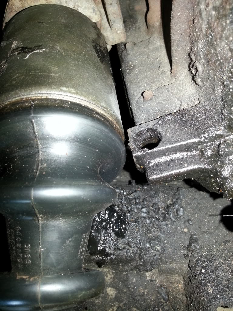

Back again... just finished fitting the vibratechnic upper engine mounting but the shaft is still pretty much touching the engine.
Could it be the apex lowering springs mixed with 15" wheels?
  Lionel Richie
its supposed to be "pretty much touching the engine" are these NEW shafts you're using or 2nd hand knackered ones?
Cro
  Meg'd r27
I grinded that corner off, once my old clio was low enough it was nicking it all the time. No problems after taking a bit back and I remember Ben172 did the same

  CLIO Iceberg 172
did the same thing, thought it was stupid only having 5mm clearance. the boot rubber expands as it heats up and spins up so i chopped mine back too. never had problem again
  Clio 172
Need to bring this feed back to life bought a new drive shaft from eurocar parts and its catching ive chopped the bit sticking out as much as possible an is still touching! Is there anything else to do? Dont fancy spending a fortune from renualt?
  Renault Clio182 bean
Euro car parts driveshaft's are crap anyway, I had a bad experience with them on my saxo after fitting x2 'q-drive' drop links and offside driveshaft.
The boot on the shaft was split within 3 months and the rubber covers on the joints for the drop links had split as well.
Replaced with genuine and they were still fine the day I sold the car. The joints are often slightly bigger the aftermarket car parts which will cause the rubber to foul where it wouldn't with genuine parts.
