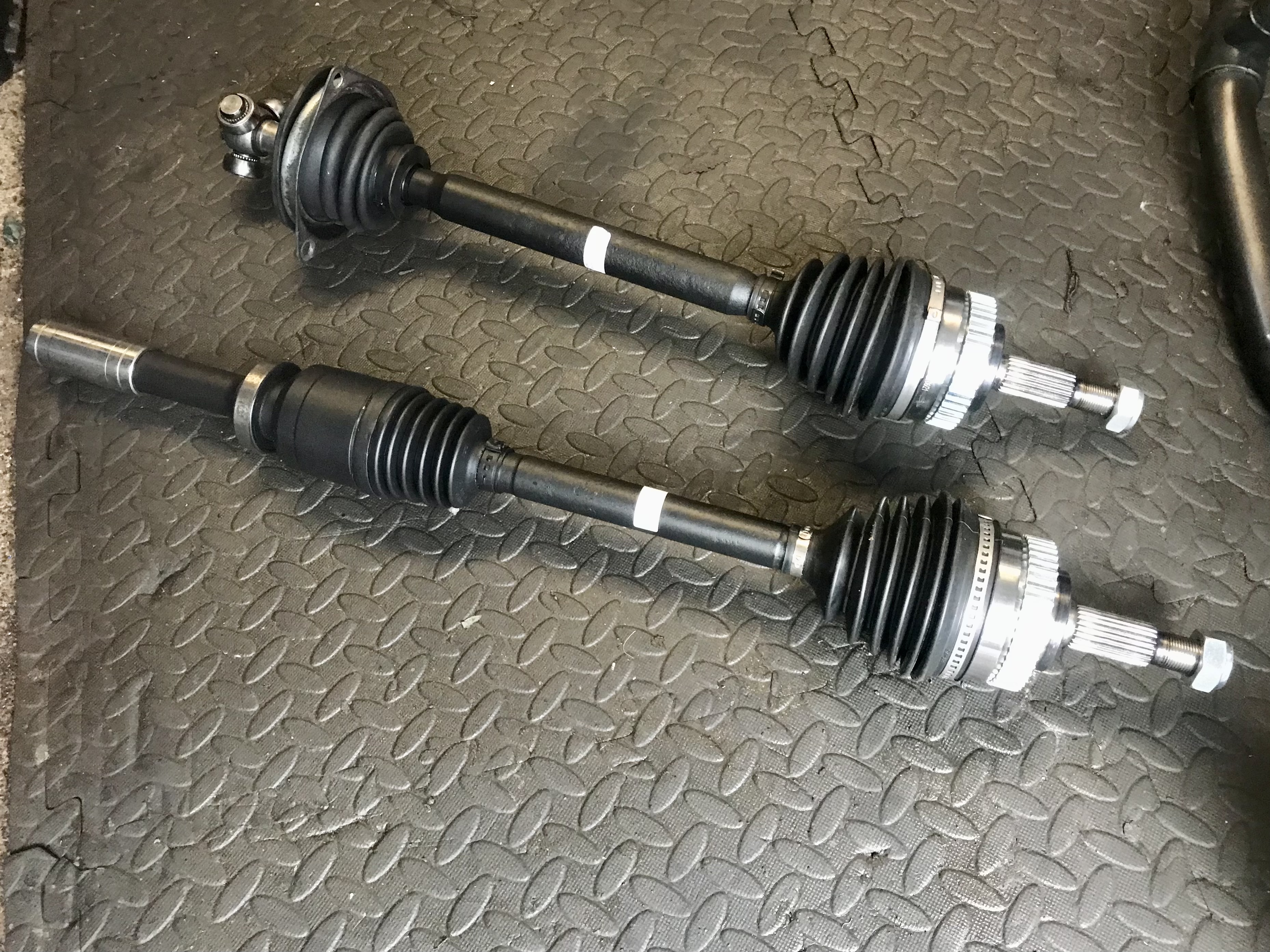

Shaftec supply refurbished genuine ones. I'd highly recommend one of those.
More money than the J&R but they're essentially a refurbished genuine part. You want R396R (OSF - Drivers) replaces 8200352042 and R396L (NSF - Passenger) replaces 8200372167.

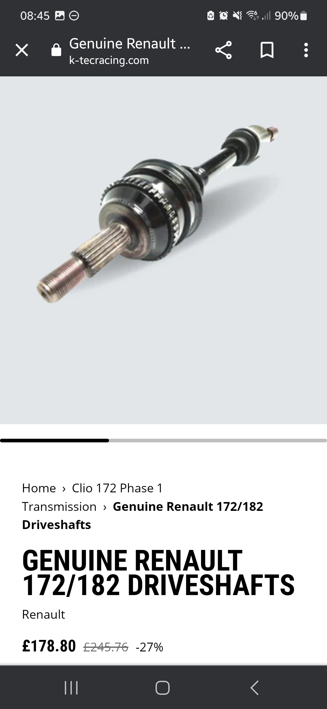

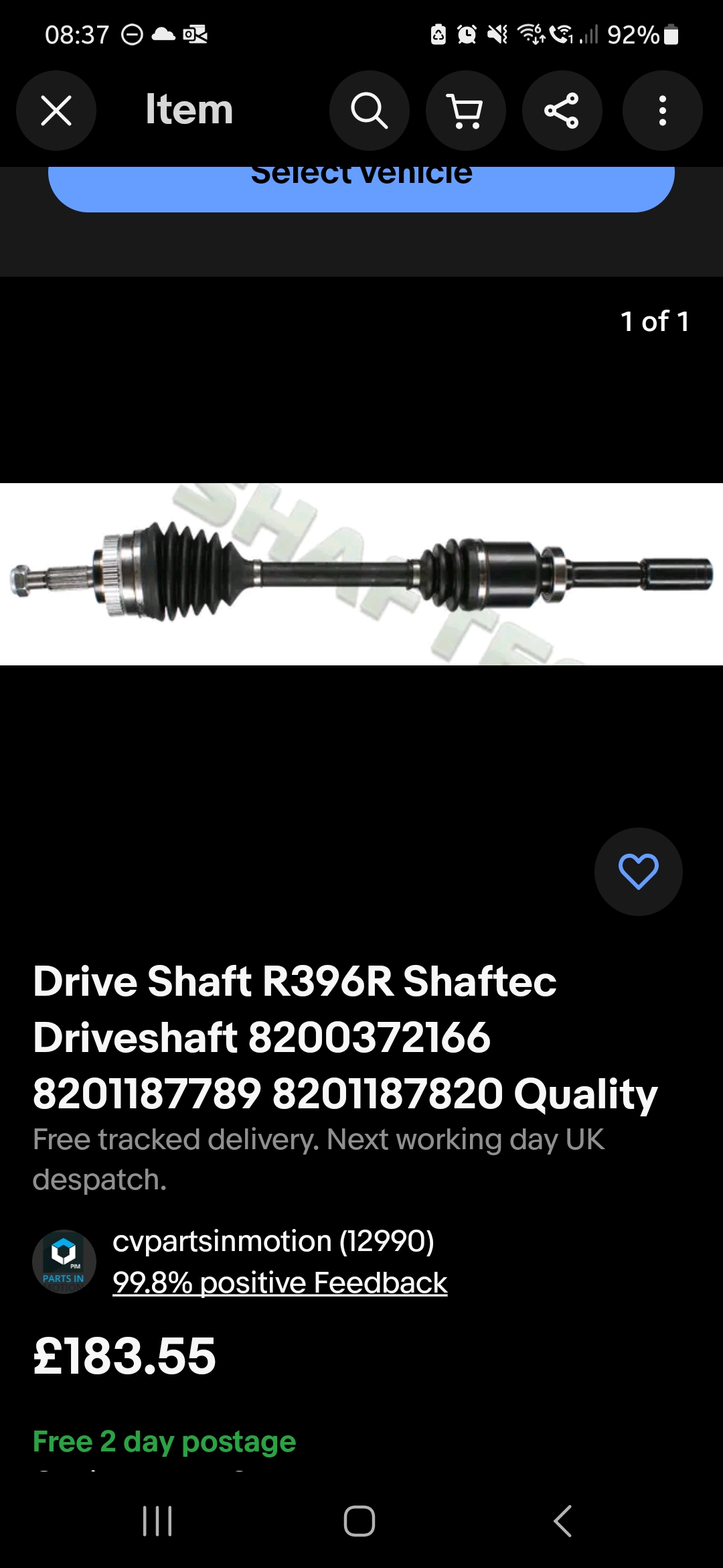

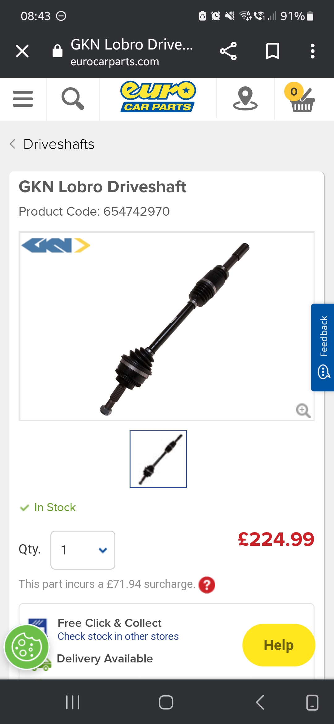

Ive had a quick look around seeing where i can get each driveshaft, as of right now ktec have offers on for there non 182 cup osf drive shaft which is making it the cheapest at £178 and then its the shaftec which looks to have the cup abs ring already on it at £183 and then the gkn which is about 220 and from ECP has a £70 surcharge so overall depending on what people r after id say the shaftec is the least hassle and the gkn would be the cheapest if u didnt mind waiting to be refunded that £70 after sending the orignial unit away. And then if the ktec is anything like the other stuff on their site then its gonna be great. But if the offers go off itll be the most expensive.
Hope the breakdown of the shafts can hopefully help someone but i havent tried any of these driveshafts yet so could be wrong🤷‍♂️

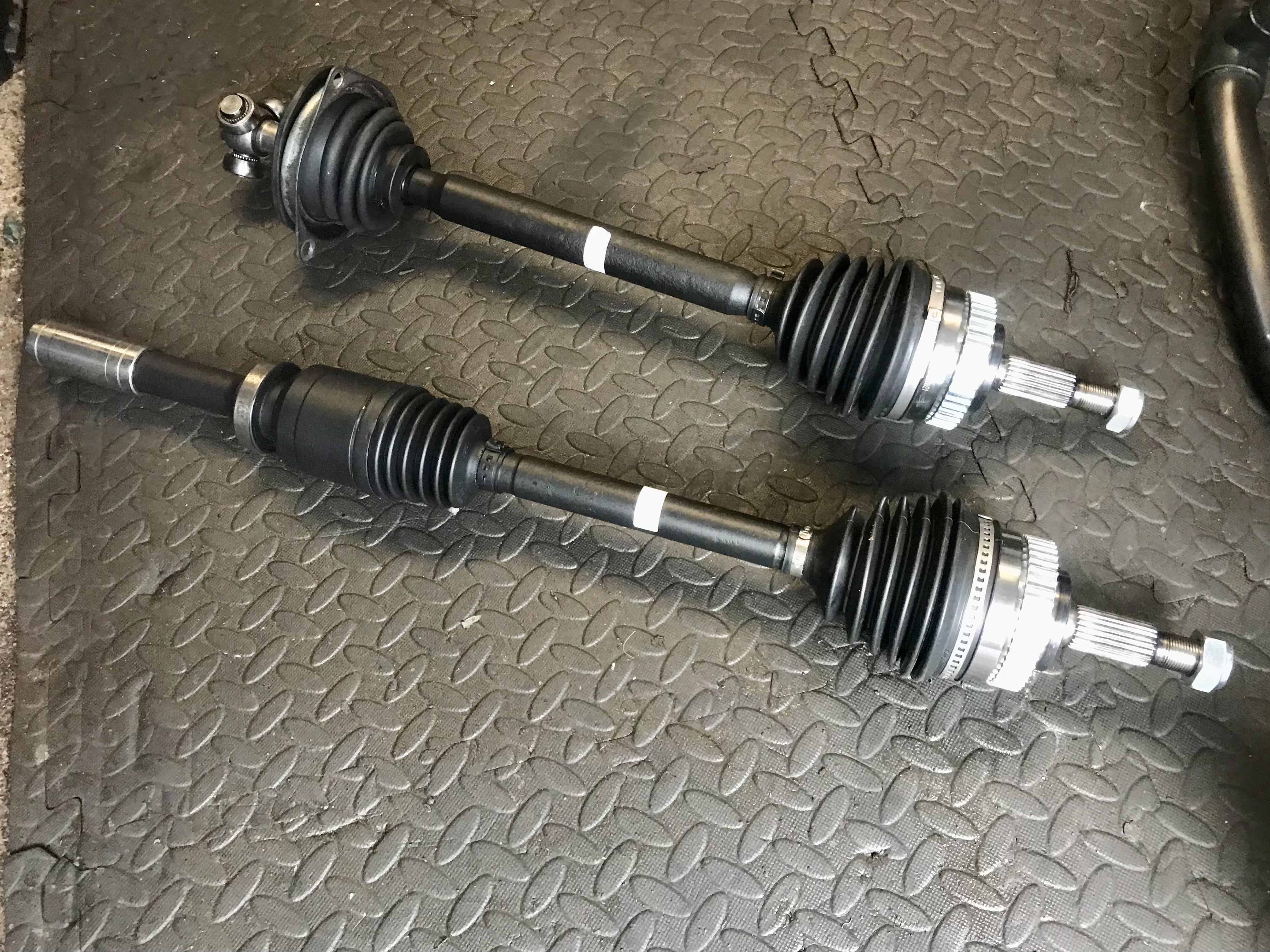

View attachment 1641111im definitely tempted the most by the shaftec unit as it seems to be a direct swap and i dont have to faff around with abs rings
Carparts4less you can either pick it up from Eurocarparts or get it delivered for free & can take the return item to ECP now, so with current 20% discount code BANK (always a code on, from 17-19% usually) and a lower advertised price, is £70 cheaper than choosing their sister company to give your money to!
