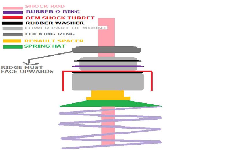

Any one knows how to fit the top mounts???
does exist a guide or a manual???
please help me I yust recieved the topmounts from UK and I dosent know how to fit them in my clio 172 phase 2..

so the number 1 is the spring hat.
and the number 2 is the renault spacer or the number 4??
The number 6 and number 3, I yust have to take them away??
where I have to put the nut??
number 4 is the correct gold renault spacer, 6 & 3 are not used with solid mounts :)
