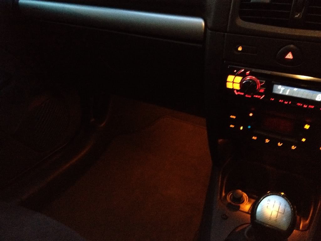

I put orange ones in mine to match the dash lights and they come on with the side lights... They just give a nice glow at night and are not to bright to cause a distraction !!!

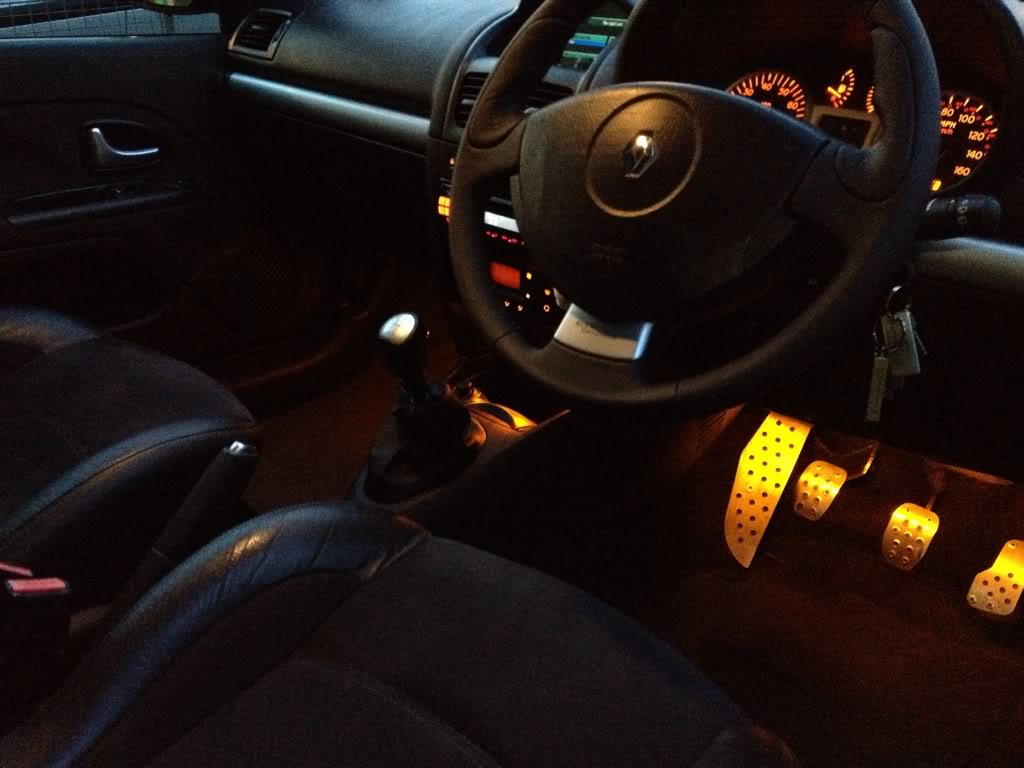

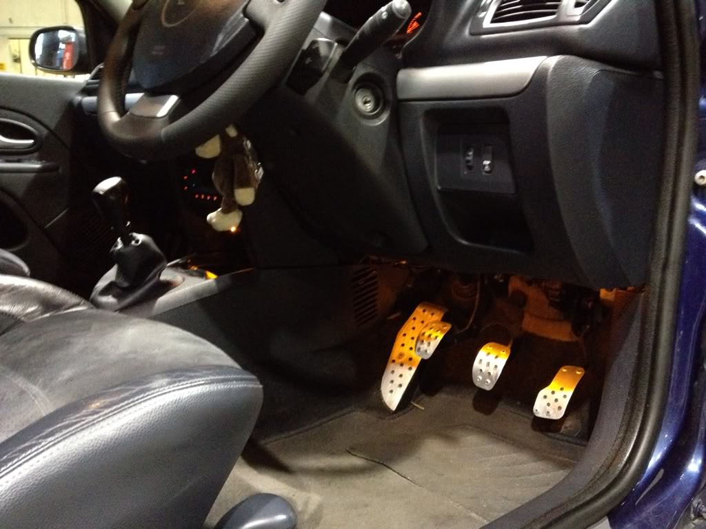

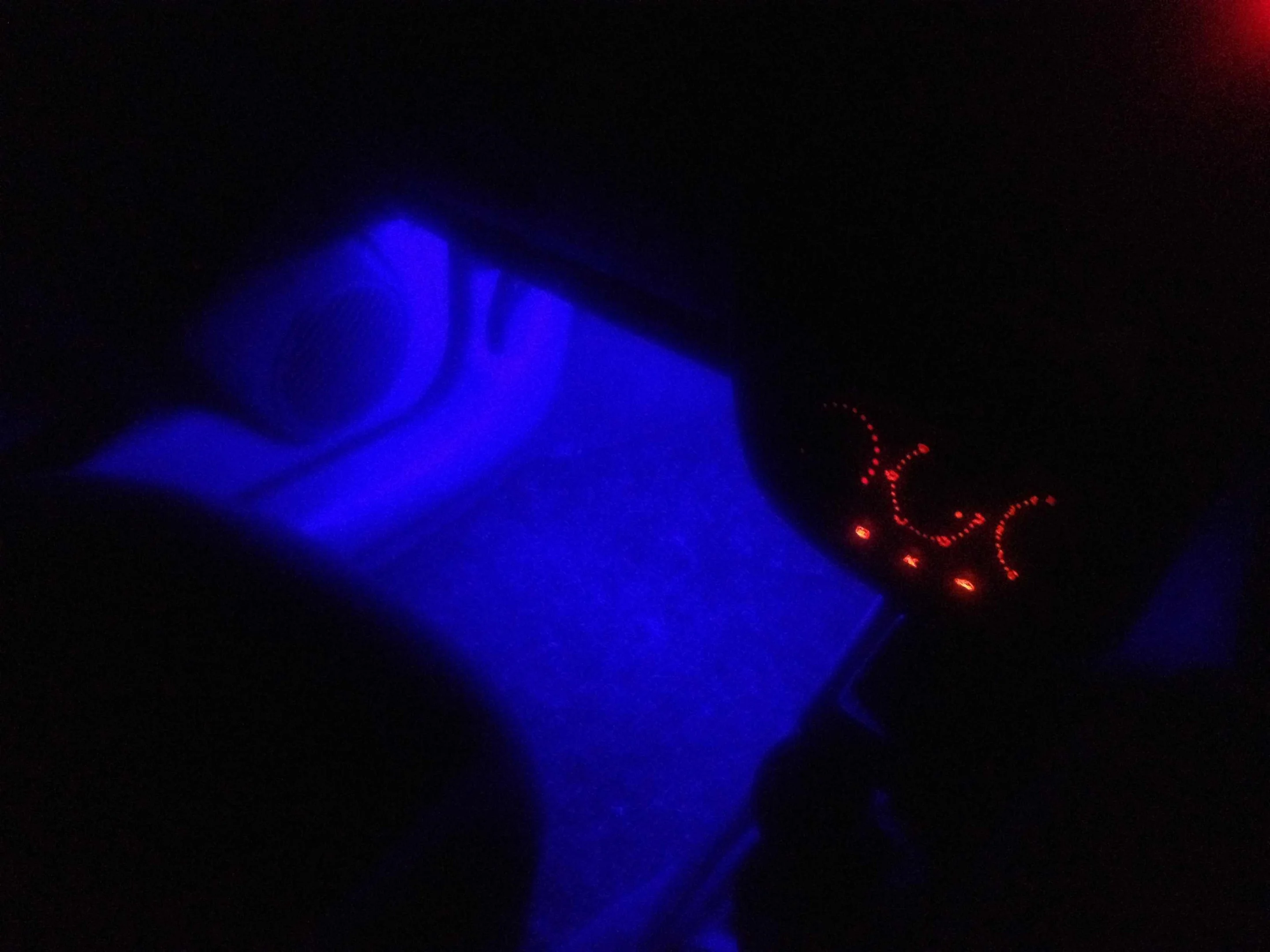

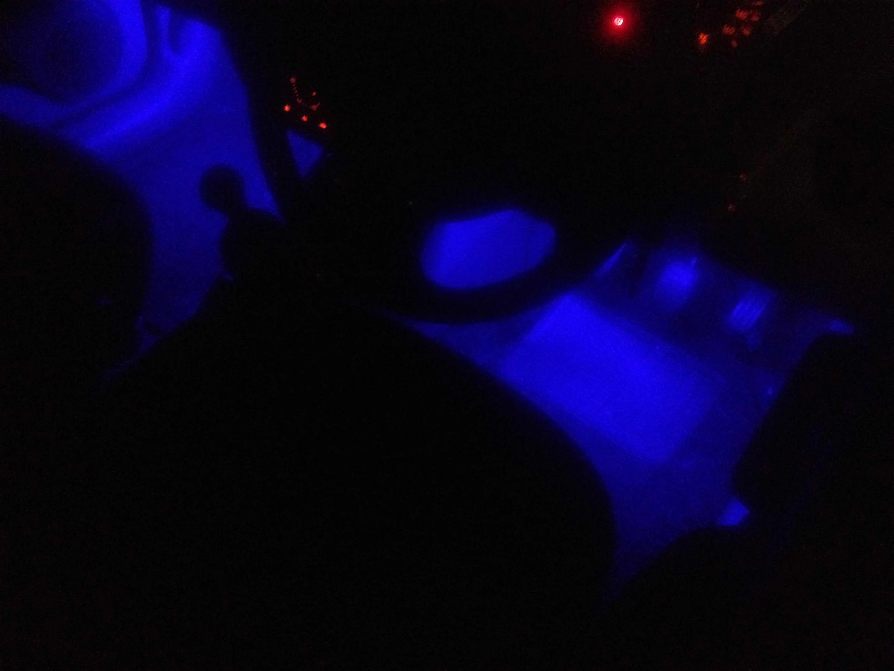

Finished it in the end.
Wired it up to the "Remote lock" button, created wiring to make it reach, and used plugs so I can unplug them to change them/remove them whenever necessary without having to unwire the whole lot.
Thanks for all the help/info you've given me.
Here is the finished product;
