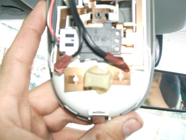

PM me at about 4 tomorrow and ill go get pictures of mine
Edit: Found a s**t quality photo on my laptop. Wire is wrapped under the metal track on the roof light.
This will be on whenever the main light is on (Not map light)
Will get better photo or make you a guide if you need one.

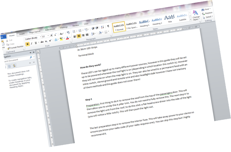

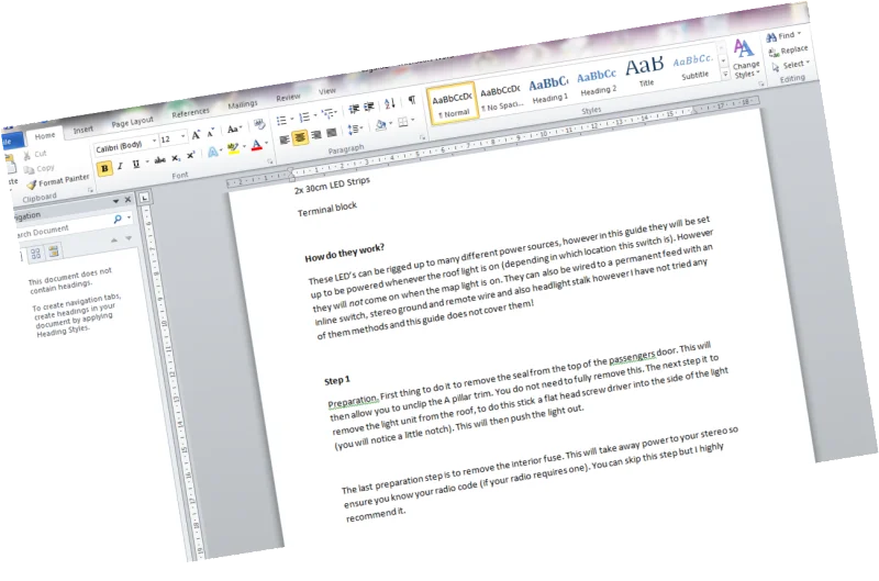

Make a guide, that way it can go in the guide section and i can use it when i get round to doing some for me :)
Here is mine for now

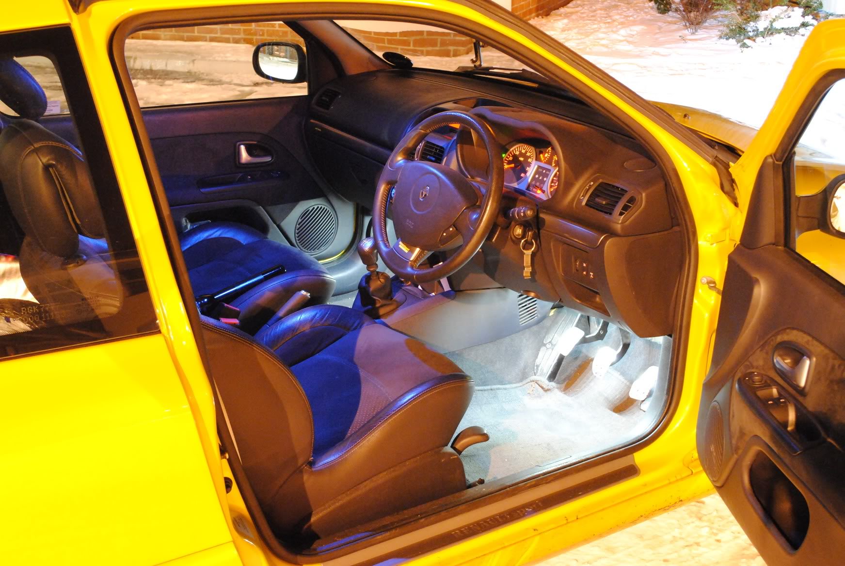

As above, though I would advise against this as it will be a huge distraction with the footwells lit up. On my 182 I wired them into the interior light so anytime I opened the door they came on.
as blue as they look my interior light LEDs were actually white..
This is exactly what I want to do, I want mine wired to the interior light so they go off while driving and come on with the doors etc , could anybody help in terms off links to the lights ill need and wiring ?

I've just " upgraded" to 40cm RGB with ir controller. Much better imo because brightness can be adjusted, or i can have any colour i want :D 40cm is definitely better than 30 too imo as the light floods the foot well nicer :)
