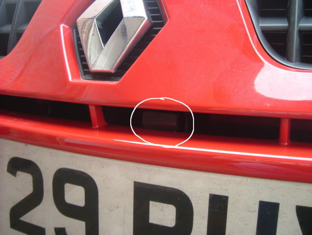

Finally got a day spare and will install my Lidatek LE-30 to the front bumper of the car.
Hopefully I'll be able to get away without removing the bumper completely, but I'll do what needs to be. However, the part that is a bit intimidating to me is the wiring section.

I assume it would be best to keep the actual central unit in the car out of weather's way (the transponder is water proof and warranteed against lens damage). What would be best to seal the car afterward ?
If anyone's done this before I'd very much appreciate any help. (Kwik Fit, Halfords etc won't touch it:rolleyes:)

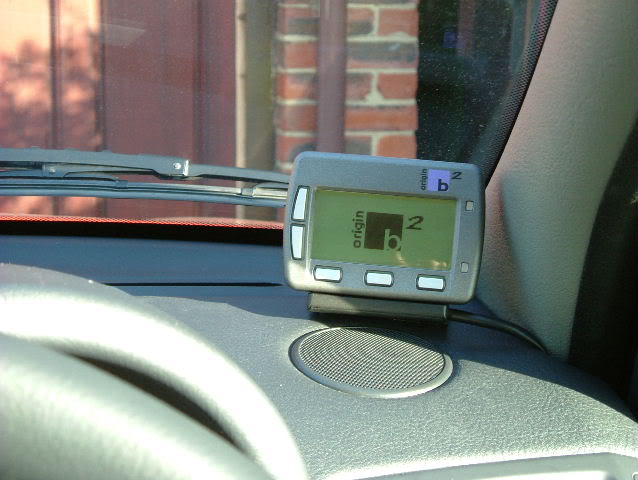

Yep I've installed my old Target LRC100 to my Trophy.
You don't need to take the front bumper off, just remove the front grill for better access.
I've got mine plugged into an Origin b2 (makes life easier).
7MAT
Brilliant stuff, how have you got it wired ??
Does yours draw power from the B2 ?? In which case, what's the B2 wired to ?

The LRC100 plugs into the wiring loom for the Origin b2. I took a live feed from the cigar lighter for the b2.
The LRC100 is attached to the car with extra strength outdoor felcro stuff from Halfords.

How did you manage to remove the grill without the bumper ? Looks like it's joined at the bottom.
Where abouts did you route the transponder cable ?

Either way, the unit is in now, ended up sticking some mastik on it. It's a bit more visible than I would have liked, but it's there and it works. Now to find a police speed trap to test it for real.
