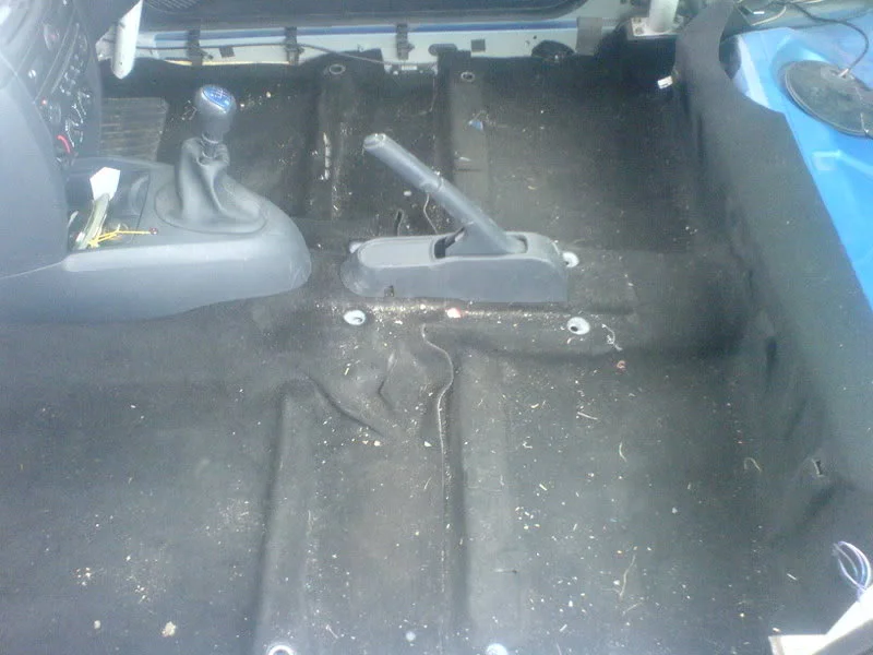

As title suggests, i'm having problems fitting my OMP 6 point.
Back and front legs are fine, its just the middle ones i'm confused by, they are shorter than the rest and don't reach the floor, i cant see where they would bolt into, any ideas??!

Thats the prob, i dont know where to weld the plates in, front and back is obvious and no problem, just the middle as they dont reach the floor, was thinking of a right angle plate and welding and bolting that to the side?!

I'd say it mounts to the actual floor just next to the edge of the seat base... can you do a pic with yours in to see how much out it is?

No pics at the mo, plus at work still haha! It got it off ebay from a bloke on here, was subway's then somebody elses now mine, roll cage **** been around!
You sound about right tho, where the seat dips away
