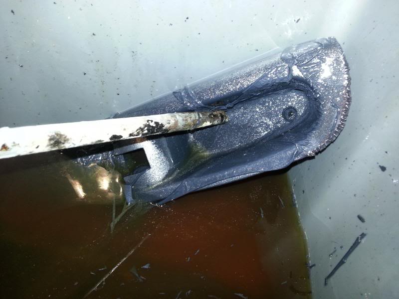

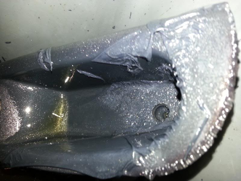

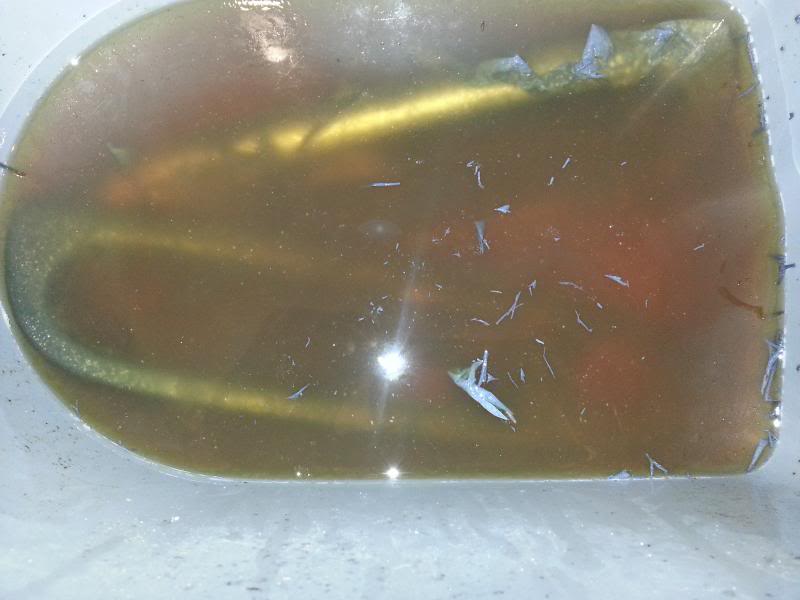

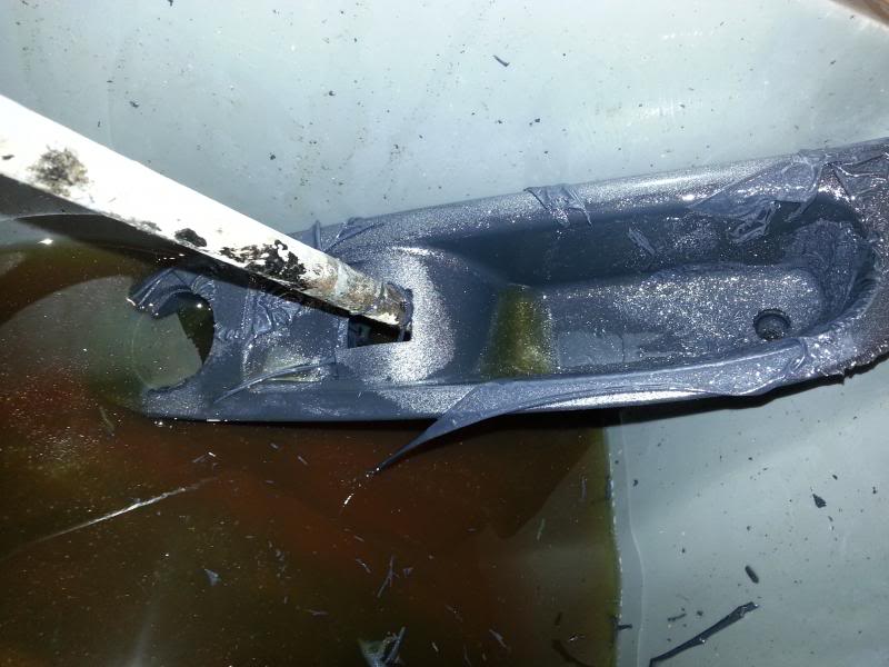

The easiest way to remove the rubber coating is to leave them soaking in Dettol disinfectant . I got this tip off a modeling website for stripping paint off plastics. Leave the handles submerged for 24 hours and the coating just peels off . It has to be Dettol though apparently . It's not surprising it kills germs when you see how quickly and easily it just comes off . You can actually see some kind of chemical reaction taking place as it gives off a vapour. I washed them thoroughly in cold water afterwards then sanded and primed them . I haven't actually got round to painting them yet as I couldn't find a colour close enough to the originals .

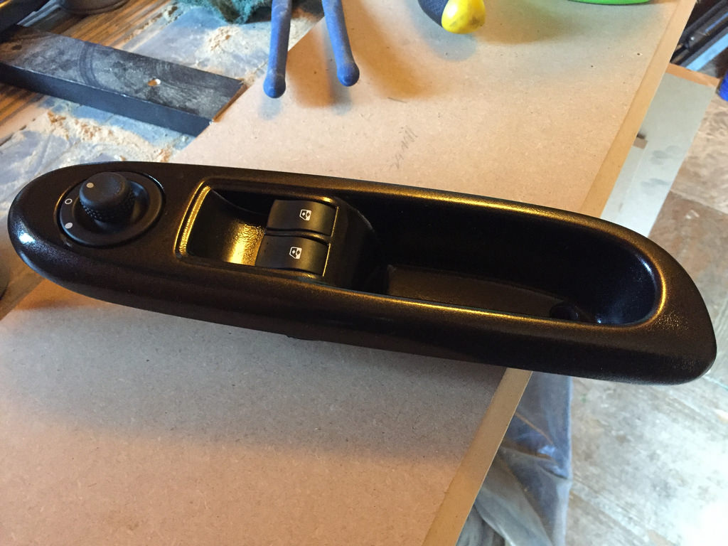

Well, they've been painted now. The finish isn't quite as good as the original (the lacquer makes it quite glossy) and the colour is darker but they are a whole lot better than they were. The non-sport option would sure have taken a whole less time.
