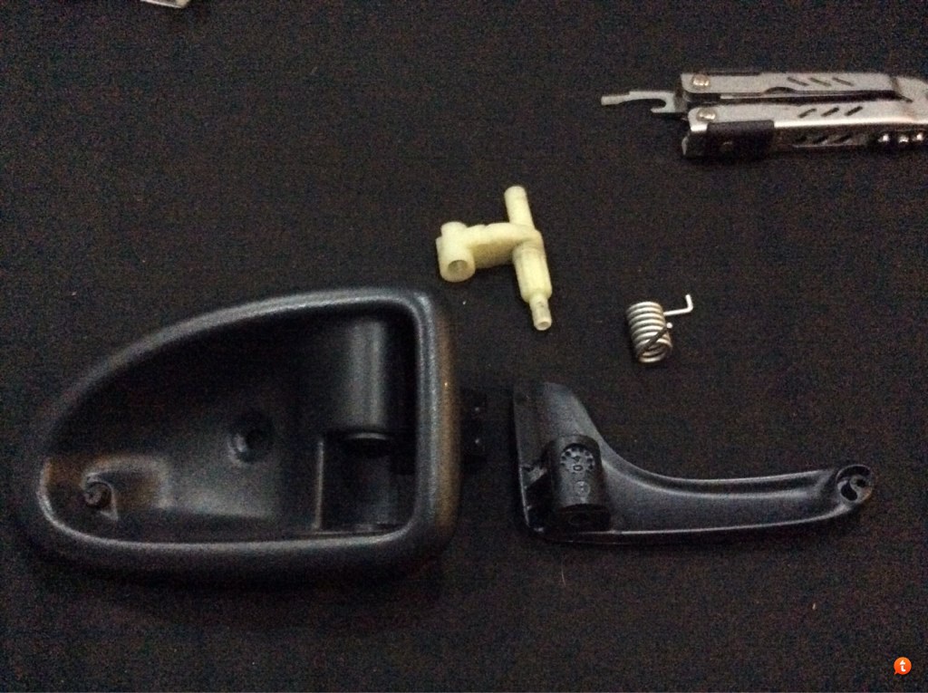

Sorry, I've wasted my own time typing this question up - I just took the plunge to see what I could do to the handles and managed to do it hassle free!
In case anyone comes across this looking how to do it...

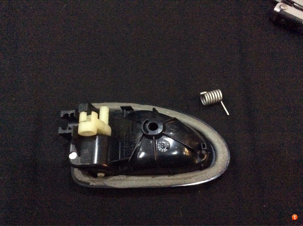

The handle looks like this from behind:

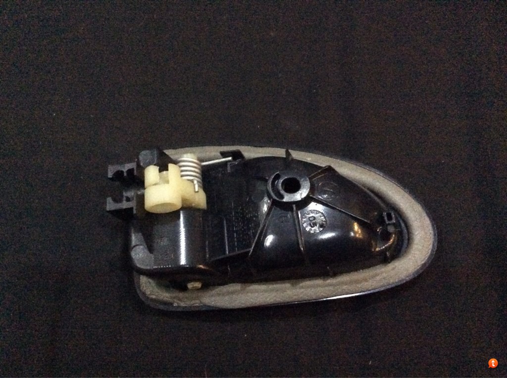

You then remove the spring:

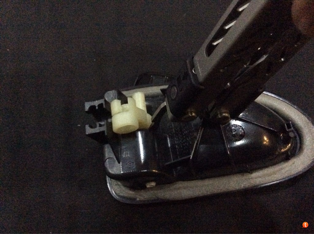

And then the tricky-ish bit - Getting the white plastic part off, I used the flat-head screwdriver on my Gerber to lever it off which worked quite well:

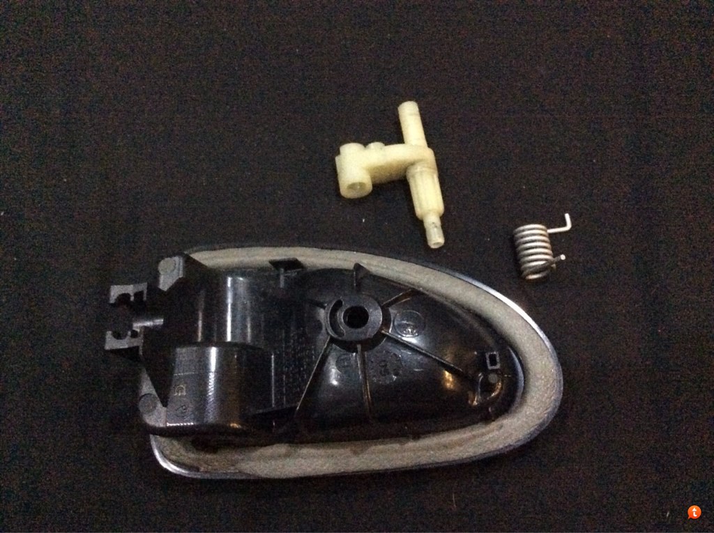

And you're done!
