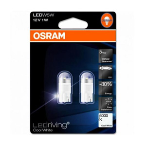

Think i might invest in some of these..
Reviews claim their the business, if a little expensive

Cant see anywhere on OSRAMs site that they suit dimmable or CANBUS systems. I would be worried about spending £10+ and then them being no better than £2 Chinese specials!
I've accepted loosing the fade in/out (dimming) feature is probably going to a given if i want more light output.
Buying LED's off eBay is always a bit hit and miss. Least if i spend a bit of money on a decent product that's been engineered for the application intended i might see better results. I could end up spending more than that in the long run looking for something suitable :)
  '05 BG RS182 FF
I'm pretty sure i've read somewhere that the Osram LED's don't include the CANBUS resistors.. That's not a problem for the Clio though :)
These 501's are designed for interior applications only
loggyboy

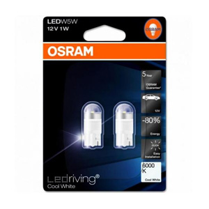

I think its more that they are NOT designed for exterior applications than designed specifically for interior. They have used the interior caveat to cover themselves, as changing colours/types of bulb would technically void any type approval.
