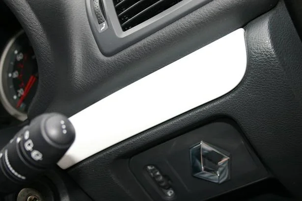

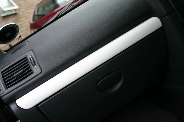

When i did my plastics i used:
Acid 8 primer - Allows the paint to really stick to the plastic
normal plastic primer
colour paint
laquer
