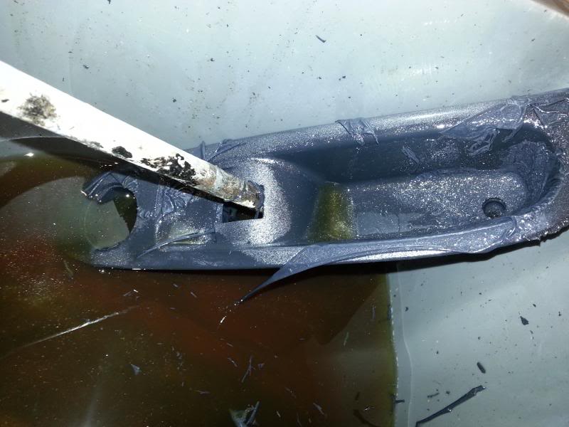

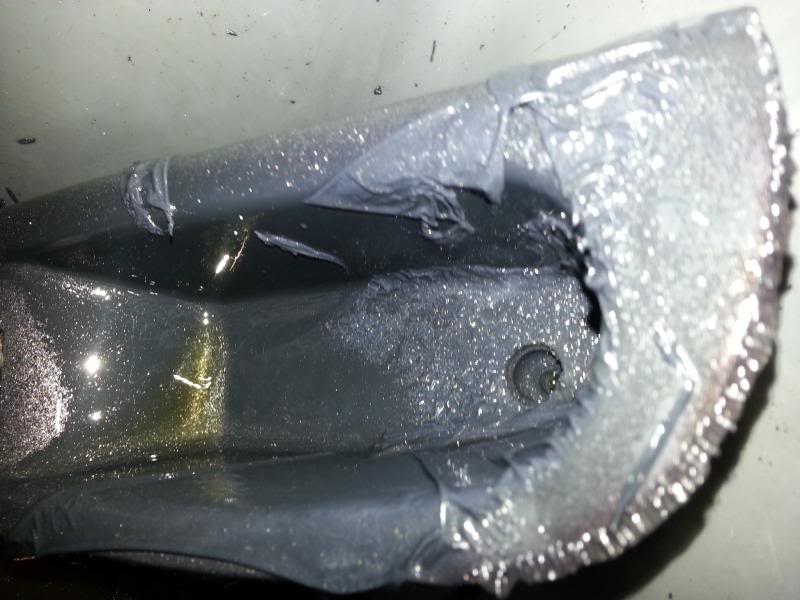

The interior door handles . You can either buy some from a non sport that don't have the rubber coating . Or you can remove the rubber coating and then spray them . To remove the rubber coating , put then in a washing up bowl or bucket with Dettol covering them and the rubber coating just dissolves . It has to be Dettol though not some cheapo disinfecant. You'll see whisps of smoke come off as the chemical reaction gets to work on the rubber coating .

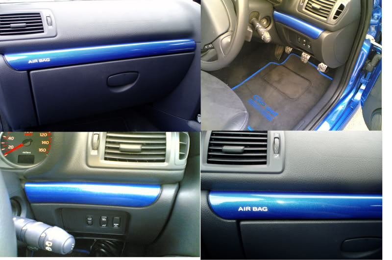

Yeah underneath the dash trims are silver . Lots of people spray them and colour code them to their car .
I did mine donkeys years ago .

That's really smart, I liked that blue theme in my 172 cup aswell, so might just take it back to silver, as it would break up the black of the dash, the carbon fibre look is ok but it just makes the whole dash very dull
