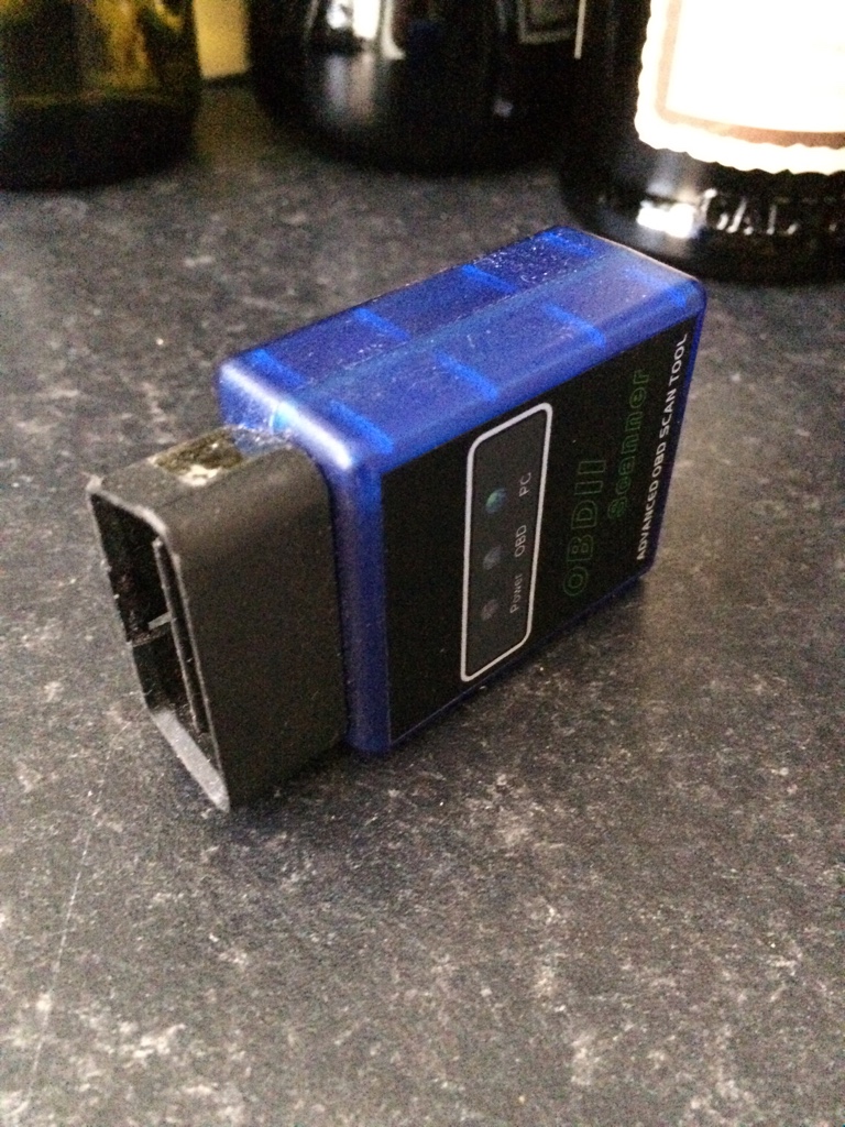

Does anyone use one of the cheap eBay Bluetooth obd readers in conjunction with an iPhone to monitor live data?
Before I waste money on one, wanted to know if they are any good.
Would like to be able to monitor coolant temps on the go ideally!

I think these really only work well on PH2 clios 172 / 182 with can bus systems . That's my thinking alway .
  172
Cool ordered a £10 dogleg from eBay.
Will give that app a try, just need to keep an eye on a few things easily, sounds like a good solution.
Only interested in basic stuff don't even need it to read codes just tell me temps and stuff
