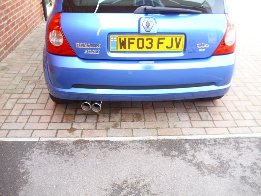

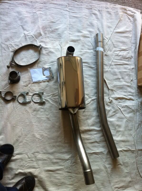

A ktec stealth I presume?
I like stealth systems on 172's. Its the only option I looked at for my ph1. I just wish I hadn't of gone for a ktec. Boomey, droney thing it was.
gotta be the exhaust mount is knackered, pics of the mount?
Also, am I the only one to notice the awful sock/sandal combo in the second photo. :dead:

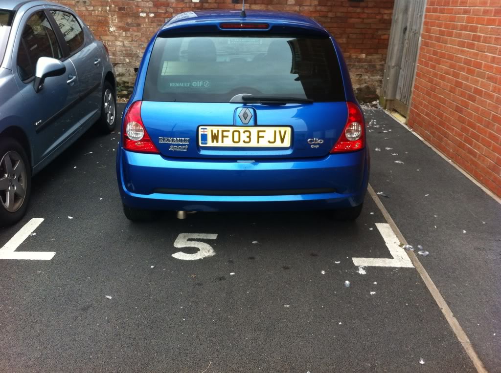

lol. Who fitted that?
You need to: Undo bracket between rear box & centre section. Twist rear box. Tighten bracket.

Good looking Clio 172 Cup but that exhaust is hanging too low to be honest, needs twisting right and upwards, a visit to Daves garage will sort that in 2 mins. Cheap as well ive heard. :rasp:
