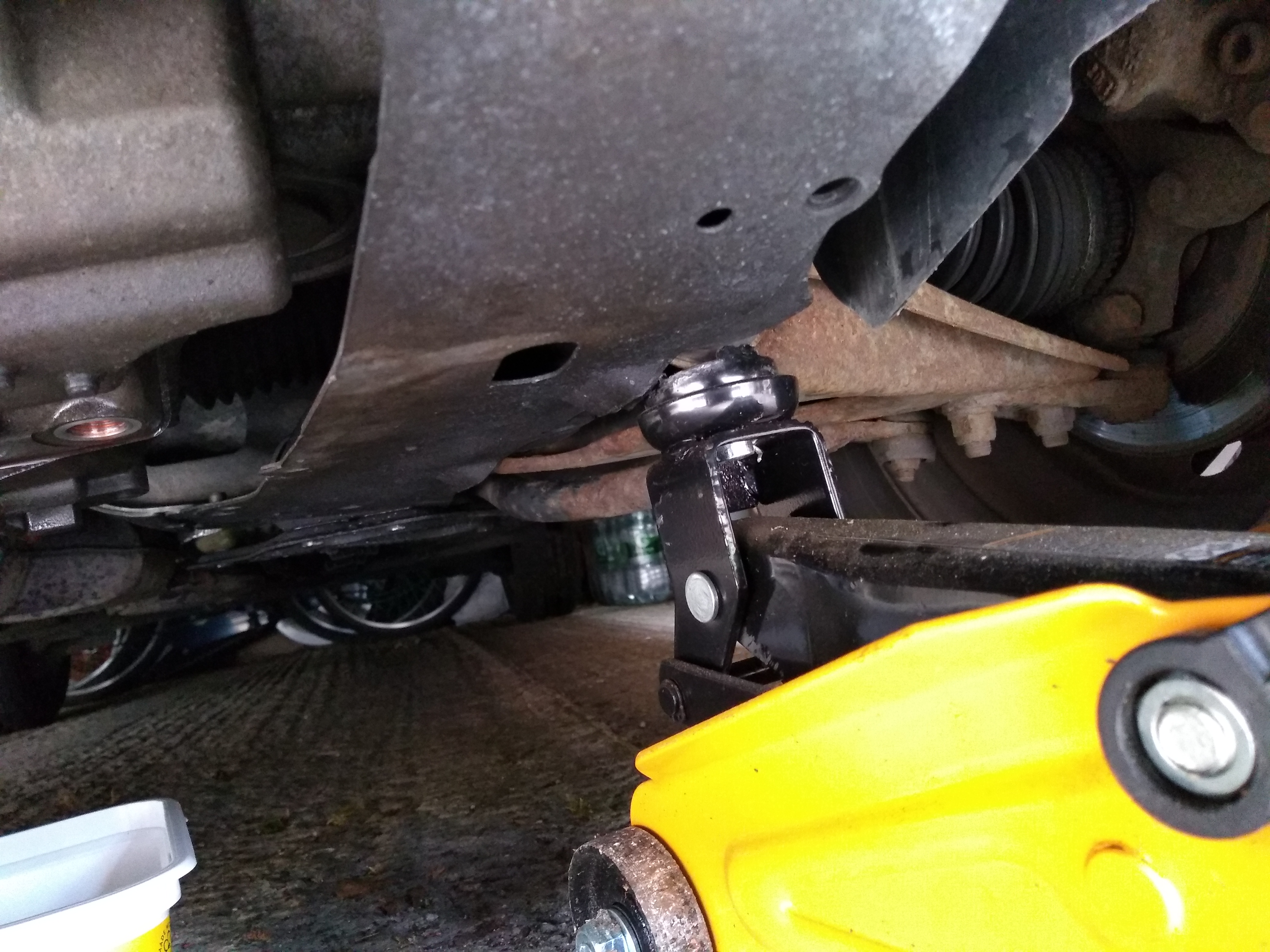

Is this a good jacking point?
  Clio
Hi. Clio mk2 1.4 automatic. I just want to check if this is a good jacking point on both front sides, where the suspension arm joins. If not is a few inches left good?
loggyboy
I avoid the subframe, and prefer to use any of the 3 corners of the of subframe bracket plate just behind it (or the main rear subframe bolt.)
If you are gonna jack on subframe use a thick timber to spread load, and dont jack too high or it will slip.
