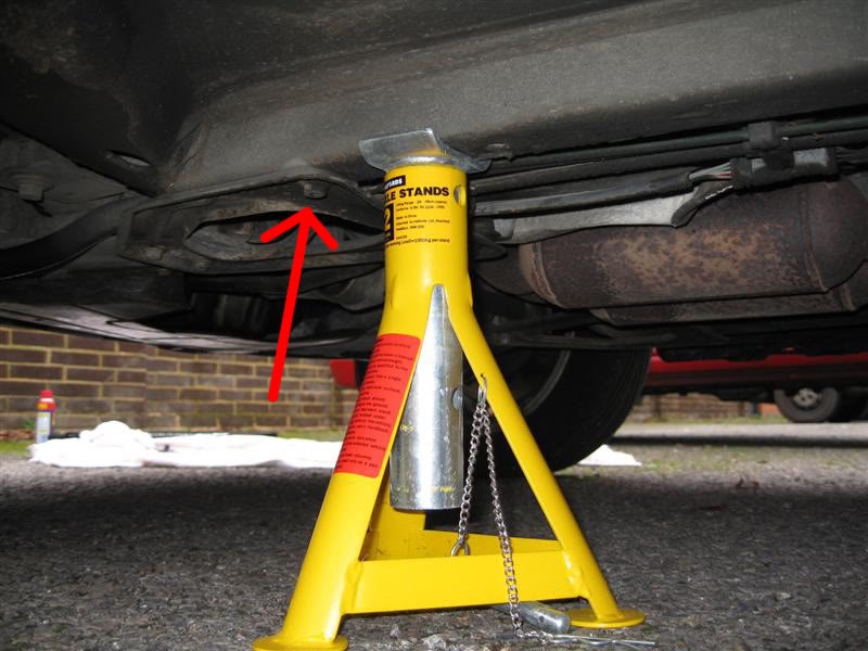

So all four of my 182's sill jacking points have been squished before and have since been straightened but still aren't in top form, so I don't really consider them an option for jacking from. Right now I only use the subframe support(?) thing as per this image https://cliosport.net/attachments/jackpoint-jpg.1305269/ except a little further in for extra piece of mind as the jack slightly arcs when nearing its highest point. Stand goes as far forward as possible.

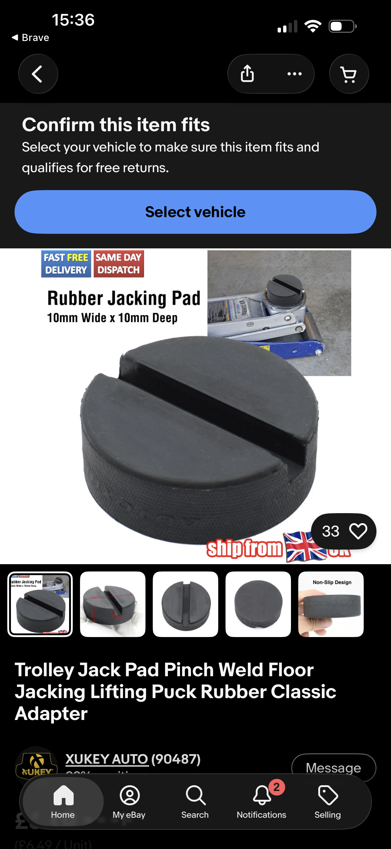

Get yourself some of these:
