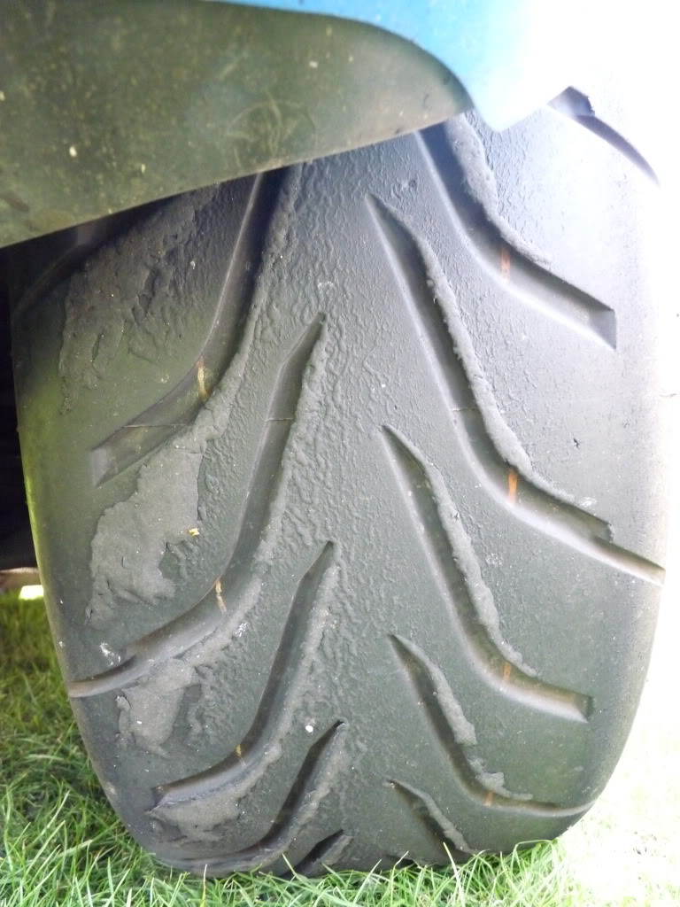

Done a few track days now and both at Oulton and Cadwell my tyres have blistered quite badly - especially on the rear.
Now I don't know if this is normal or whether I need to adjust my setup?
Any advice would be great as I don't want to shred my tyres apart!

Any pics of them?
What tyres are they?
What pressures were you running?
  Discounted 1*2 parts
And I don't know if it makes any difference but the pics were taken after an 80 mile trip home and when the tyres were cold
  172 cup
normal. Thats just where the rubber has began to roll off and then settled again after getting cold

Yea i mean the tyre tread depths seem to be ok etc and when this happened on my PE2's on the ph1, the blistering just wore aware with the road miles, however I won't be doing many road miles on these

Its not really blistering its just the rubber that is being worn off being pushed along the tyre. Just shows your trying hard ;)
