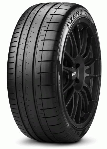

How sketchy is it running a daily on what are basically track tyres in the winter / wet?
My ST has P Zero Corsas fitted which seems to be in the same class as things like the Cup 2 (https://www.tyrereviews.com/Tyre-Tests/The-BEST-Track-Day-Tyres-for-2024.htm) albeit being a bit better in the wet and a bit worse in the dry.
But how terrible will it be in winter? I live in Norfolk so 'winter' really just means a bit wet and below 7°C and I haven't seen snow in years.
Will it be like running full-on ditchfinders, or just not quite as good as something like a PS4S at 10/10ths but perfectly adequate for the most part?

Ive ran semi slicks through winter years ago and they can be a bit loose in lower temps. You wont die if your driving steady.

They look pretty decent tbh

Yeah, it's a reasonable tread pattern and the fact it scored highest in that tyre test in wet conditions gives me some hope they'll be decent.
Might all be academic though if I use them up at CSF and replace them with a set of PZ5s or PS4Ss in autumn.

You’re not going to be pushing on if it’s cold and wet, but if you’re not careless and don’t go smashing through standing water at 70mph you’ll live.
I wouldn’t call semislicks in winter an enjoyable experience.

Concur with the above. Poor water clearing and the temps really do make life difficult (as you can’t put enough energy into the rubber).
Obviously you’ll be fine, but you certainly won’t be pushing on.

I guess my question was really, how much worse is a track focused tyre like the Corsa compared to a decent summer tyre like the PS5 when it gets cold and wet. Night and day, or only really noticeable above 7/10ths?

If you want to drive quick on non dry days then change tyre for something suitable for lower temps. PS4S,PS5 or whatever, grip will be much better.

I found that some tyres don’t like the cold.
PS4S and Contisport 5 were not lethal in sub 8 degrees, but certainly took some serious effort to get temp into the tyre.
They were excellent in the rain though.
Drive for the winter conditions and not expecting a dry summers day grip and you will be fine.

I’m speaking from the terms of AD08R and R888R, Maxxsport RB5 etc but those tyres are night and day worse than a Pilot Sport 4/5 when it’s cold and wet. Hands down.
But what you have is more like a Cup 2 where it’s a bit like a semi slick but designed to still have some road manners in adverse conditions because OEs don’t want to fit full blown semislicks on a car that they’re going to sell to a customer who’s going to drive it out of the dealership mid winter.

It's night and day the moment you get to a wet/cold/wet and cold roundabout and the car does nothing.
It's definitely noticeable at low speeds.
