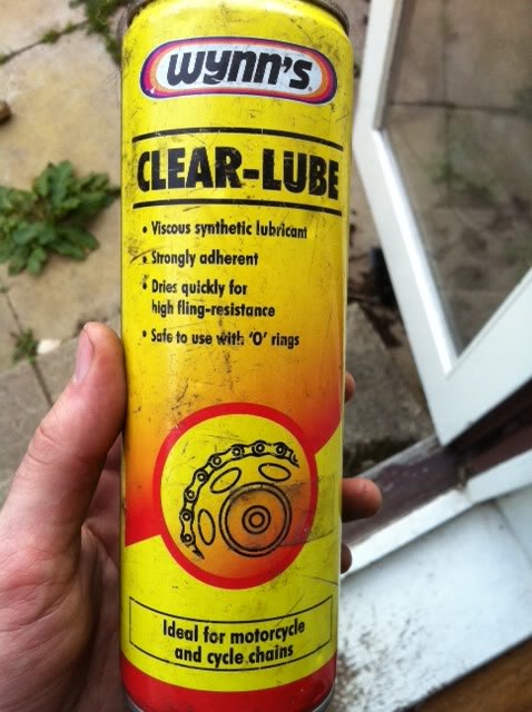

				Whatever it is, worked for me:approve:
Mate, can you post a pic or details of the exact lube you used in case its speshal
