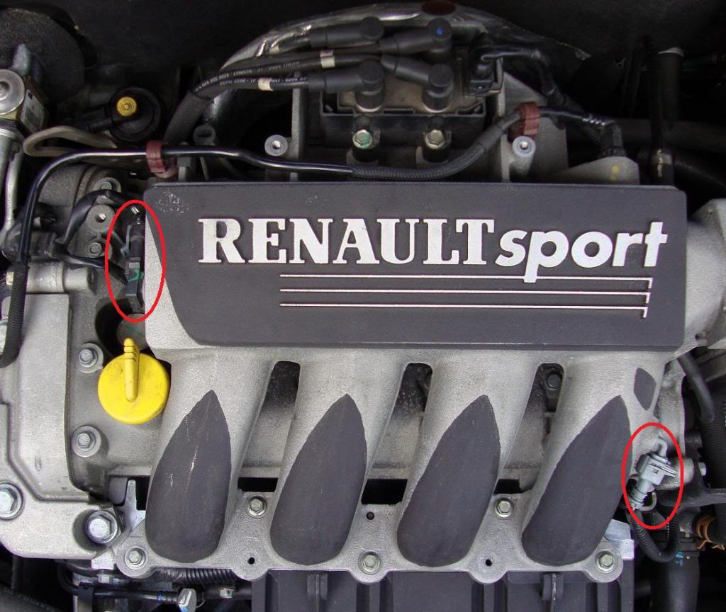

The red circle on the right

That isn't the coolant temp sensor lol why on earth would it be on the inlet manifold?!
to the op: I'd be investigating the lambda fault
  Clio 182
Exactly the same happened to mine when the coolant temp sensor failed. If memory serves its a bit lower than the part circled in the picture but the same area (ish), right near the thermostat.
