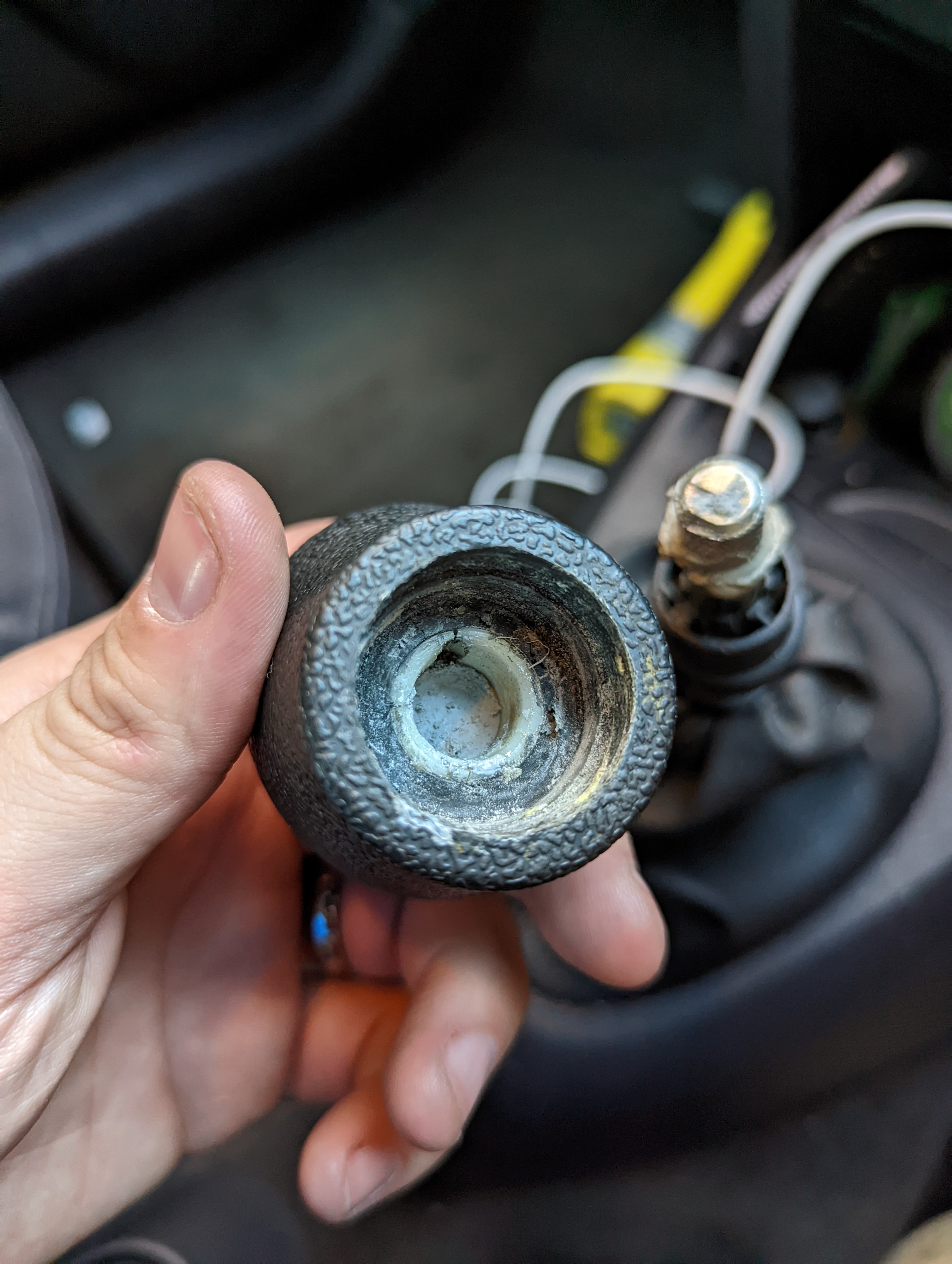

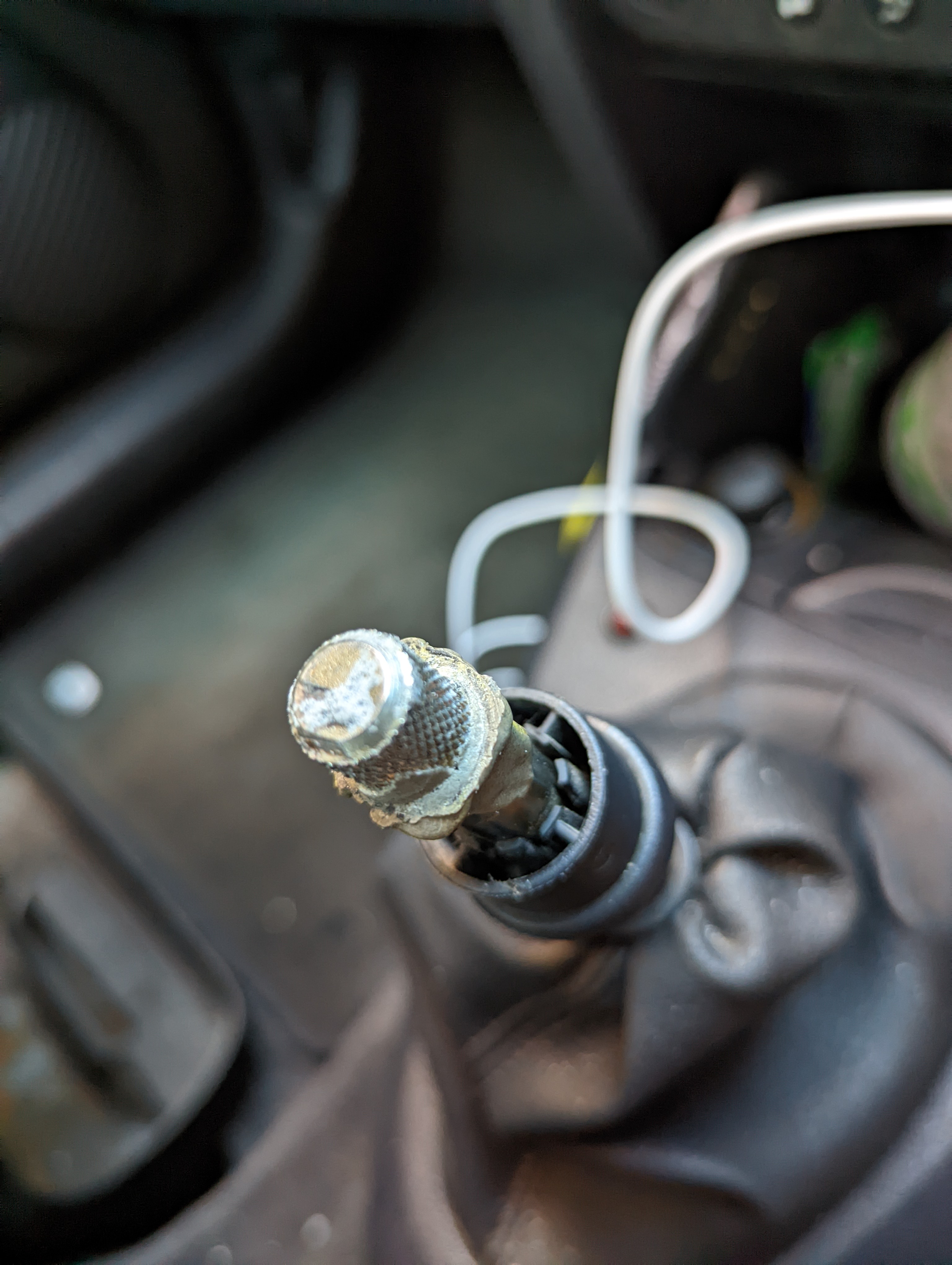

Only have two faults currently which im needing advice. First being an easy one, the gear stick seems to be bondo stuck onto the end which i assume isnt standard, anyone know a way of getting the gunk build up off (pictured).

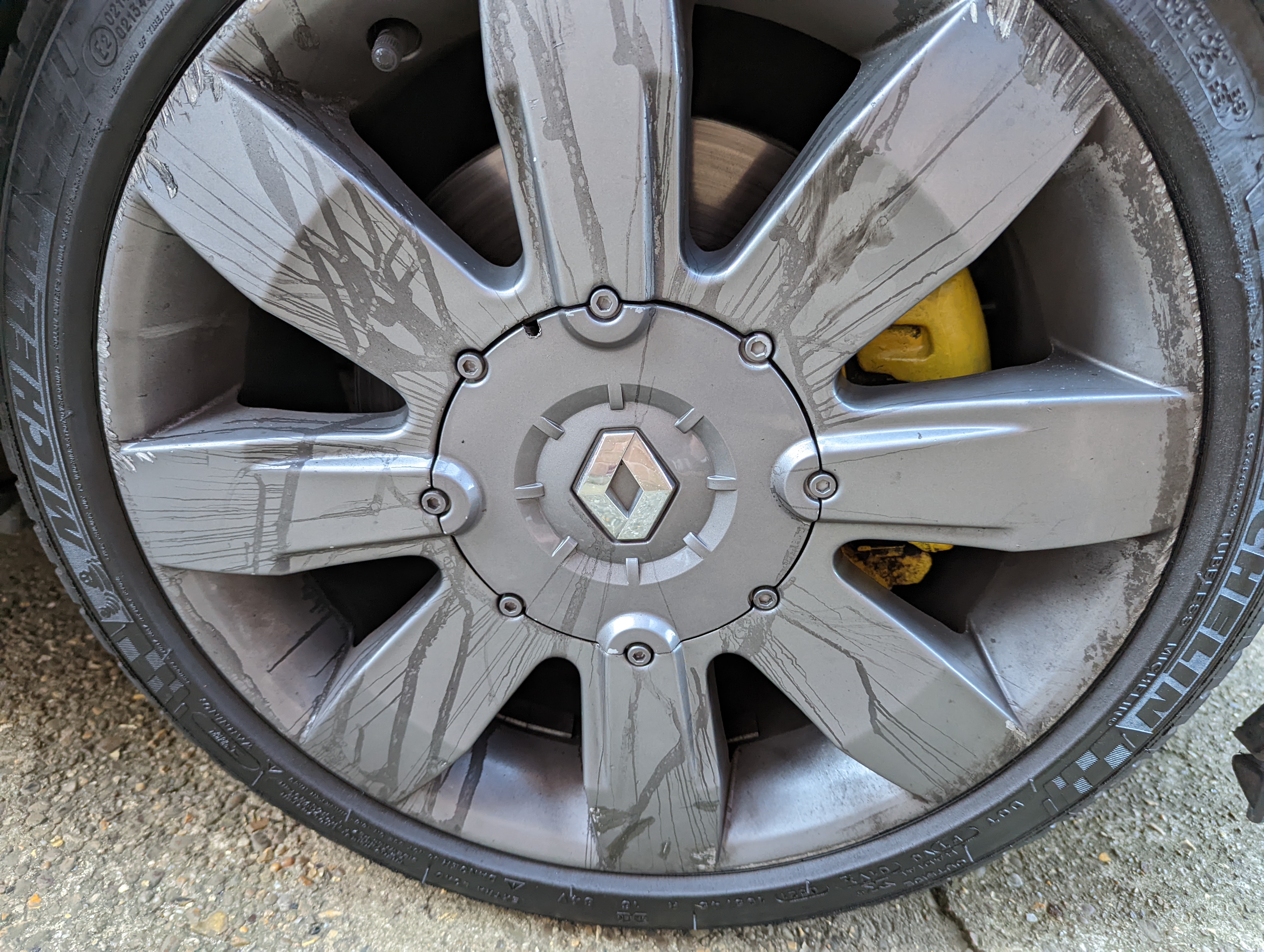

Second more pressing one is my N/S front has some form of oil leak coming from looks to be the centre of the rim. My intial thought being the shock as i have had something similar in the past on a different vehicle. Any thoughts or advice? Assuming if its shock will probably be wise to change both.

I’m glad your tinkering already, that thick glue is going to have to be chipped off with a sharp small electrical flat head screw driver or alike, normally with glues I try using alcohol or nail polish remover to remove residue but that looks nasty I can’t see that budging with solvents. Beware if you sand it and wear away the metal a new gear knob might not grip and then your back to glue again.
in terms of an oil leak trace you will need to wash engine bay first to trace it as oil travels all over the place if the leak is high up.

I will get busy with a screwdriver and hammer ! as you said worst case scenario a new gear knob is getting bonded on

Is that definitely oil and not some over zealous use of tyre shine?
Quite possibly now youve said that. The gent i picked it up from gave it a full clean and went to town with tyre shine. I will give it a clean down then a run out see if it comes back

Oh the wheel picture is the oil? Yes I agree that’s auto smart tyre shine painted on with a brush by the looks of it

Awesome will give it a wash of tonight and hopefully wont see it re appear !

Definitely looks like over use of the shine, nothing to worry about just wipe off and see if it returns for now
