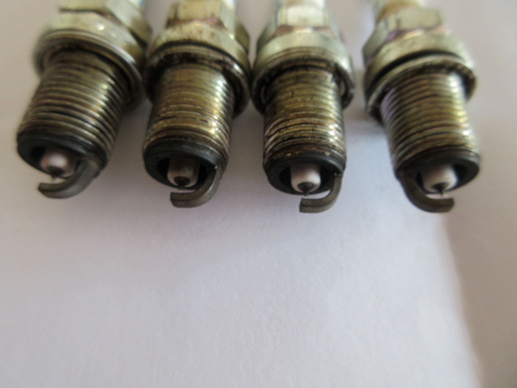

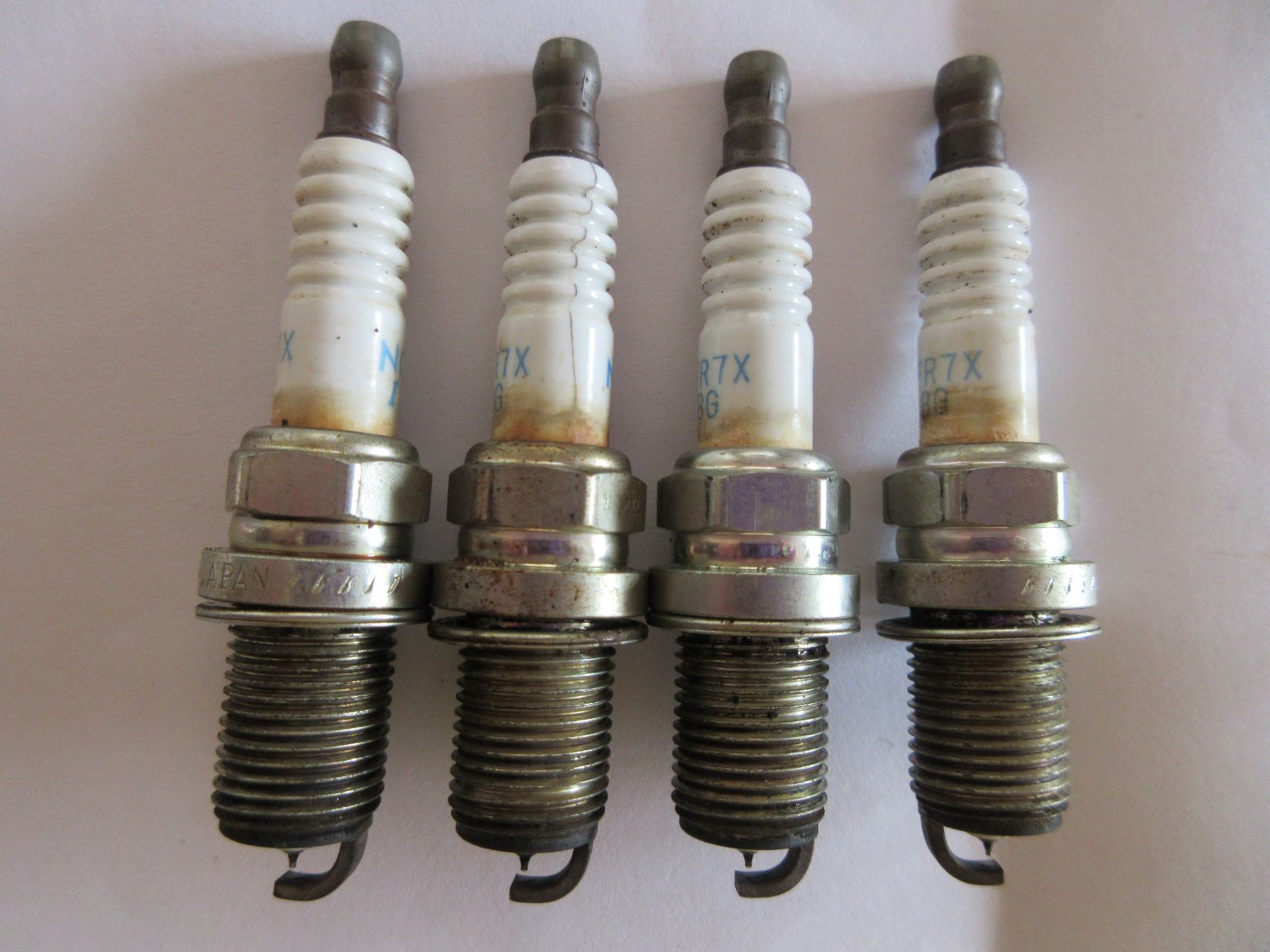

Right then after a few months of tiny hic-up every couple of weeks. Finally started misfiring badly about a week ago. Threw up a fault code on misfire on cylinder 2.
So took to local mechanic not one that serviced it last. Had a cracked plug.
They were suggesting to me that they don't think the plugs were changed 3k/6months ago and were missed at last service because of browning on the ceramic part (says they were in service book & receipt) . Don't know what people think? Actual electrodes look pretty good even the duff plug. I do a lot of short journeys sitting in traffic idling not sure if that will prematurely make the ceramic look old?

You can't say for certain if they were changed last. Have you checked the other stuff that was supposedly done?
Those weren't new 3k ago IMHO.
That said, they also shouldn't have needed changed on a 22k car, from the electrode shape they're iridium or platinum or similar long life plug - Google reckons ILFR7X8G which fits with the picture. Change interval on a stock car should be 40k+ miles.

To be honest I am not that Mechanically minded. And I am changing stuff so much earlier than service intervals (miles) that most of the time it probably don't look worn.
  LY Meg Cup-S + MX5
Plug number matches the OEM ones on RPD. But that could be either way either originals or replacement set. No date makers?
Option 1 - They did not change & I started having problems on an untouched plug at 20k that did not need changing for another 20k. On a standard car that is driven gently.
Option 2 - They did changed them and there was one duff plug either manufacturing fault or dropped that started giving me problems after 2 months, 1500 miles.
Actually Option 2 seems more plausible. Life experience taught me that things these days usually break straight away or last way longer than they are meant to.
......and option 2 makes me feel like I have not been stitched up.

I pulled plugs out of mine due to a misfire - they were 6 months old but only 2k and they looked worse than that - good chance they were indeed changed.
Of they were fitted by a weapon its not that difficult to crack the ceramic, or if the mechanic dropped one on a hard floor before installing etc.
