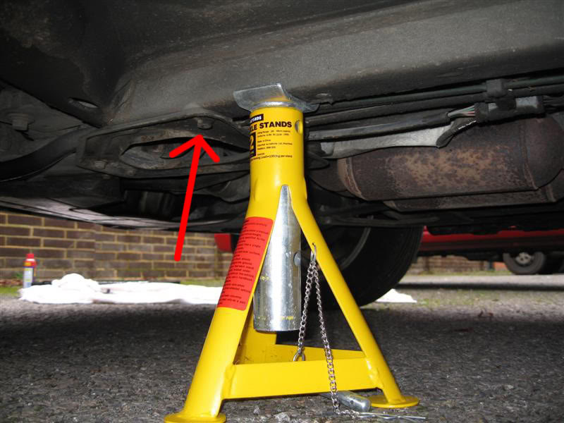

I'd recommend jacking the front slightly further up. If you follow the rail to the front there is a bolt in a subframe brace or whatever it is called. Jack from there and it is less likely to slip.
Here -
Thanks, where would you recommend for the back of the car? It seems some say the beam, others definitely not the beam.
  Clio 197
Jack it on the wishbone bolt and an ice hockey puck is a good thing to use between the Jack face and the underside of the car.
For the rear , Jack it on the underside of the damper. The rear end is very light though.
dann2707
Here -
Spot on lad. Always put the jack with that bolt inside the jacks cavity so it doesn't slip. Works perfectly
