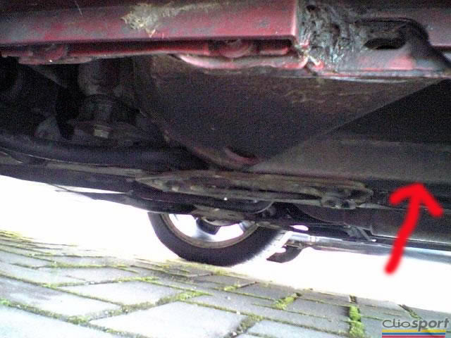

Is this a problem anyone else has faced, it would seem mine had started to bend up towards the car - distinctly unhelpful seeing as i need to do the oil this weekend - can i jack the stupid thing off the chassis rails?

NEVER EVER EVER jack them on the sills, VERY common problem, always the chassis rails!
thats the box section bit under the car

ta dar

Once the cars on axle stands on the box section the fooker should go no where! its never let me down & i've jacked my car & many other clios that way & never had a problem

They are known for being a bit weak and folding, but the strength is still there. If possilble jack up and place stands on the chassis like Fred has showed you.

A bit of a technicality, but those bits aren't "chassis rails", Clio's don't have a chassis as they are a monocoque constuction. http://en.wikipedia.org/wiki/Monocoque
If they did have a chassis using a trolley jack would be easy. Those rails are nowhere near as strong as proper chassis rails and I personally won't be using a trolley jack on them on my RSC. But no doubt Fred has jacked up a few Clio's in his time and it obviously doesn't cause any serious damage.
I went to help a friend jack up his 172 a couple of weeks back and the front RHS sill jacking point had been folded :( - it's only ever been serviced the the local dealer as well..... Even after bashing it straight it started folding straight away when the factory jack was tried.
There is actually a strengthened part of the sill, its got 2 layers of metal and is where the hole is on Freds picture...

mine were bent too dave,spent a morning at work up onthe ramp with a pair of mole grips, a hammer, and obviously a clean and coat of hammerite mine are back to normal

We spent quite a bit of time straightening the one on a friend's 172 only to have it fold straight over again when we tried jacking it. :(

Yeah, on my cup as it didnt come with a jack,some numpty had decided to use a vauxhall jack to jack the car, found it in the boot when I bought it last year! it has a hump in the middle so doesnt do the jacking points much good, they are slightly bent with lip folded up:-( Are these easy to straighten up?

i have 1 bent on mine! tryed to unbend it the other day looks slightly better but never like it was!

Bent mine. Destroyed the otherside when i come down a kerb. Copper hammer fixed them though:eek:
