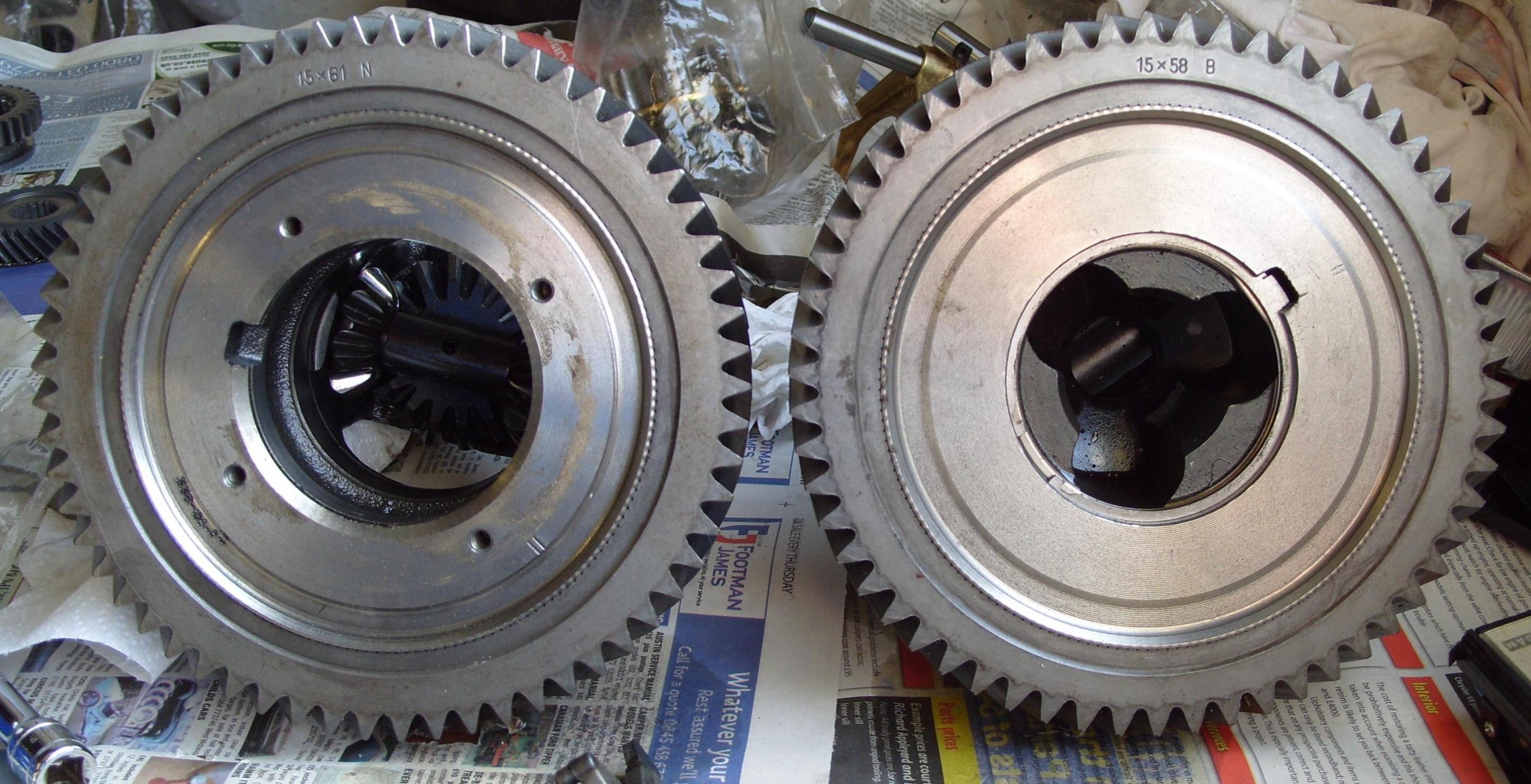

A Andrew Cooke Oct 10, 2009 #6 legohead01 said: does any one no if all gearboxes for clio sports and the same ratios? Click to expand... ratios are the same, final drives aren't, 089 boxes have 3.89 final drives (15" wheels?) all the others have 4.07. I think I'd like an 089.

activ Car 172 cup & 182 Oct 10, 2009 #7 129, 130, on the left. 089, on the right, Attachments PH2%2BPH1.webp 431.9 KB · Views: 206
