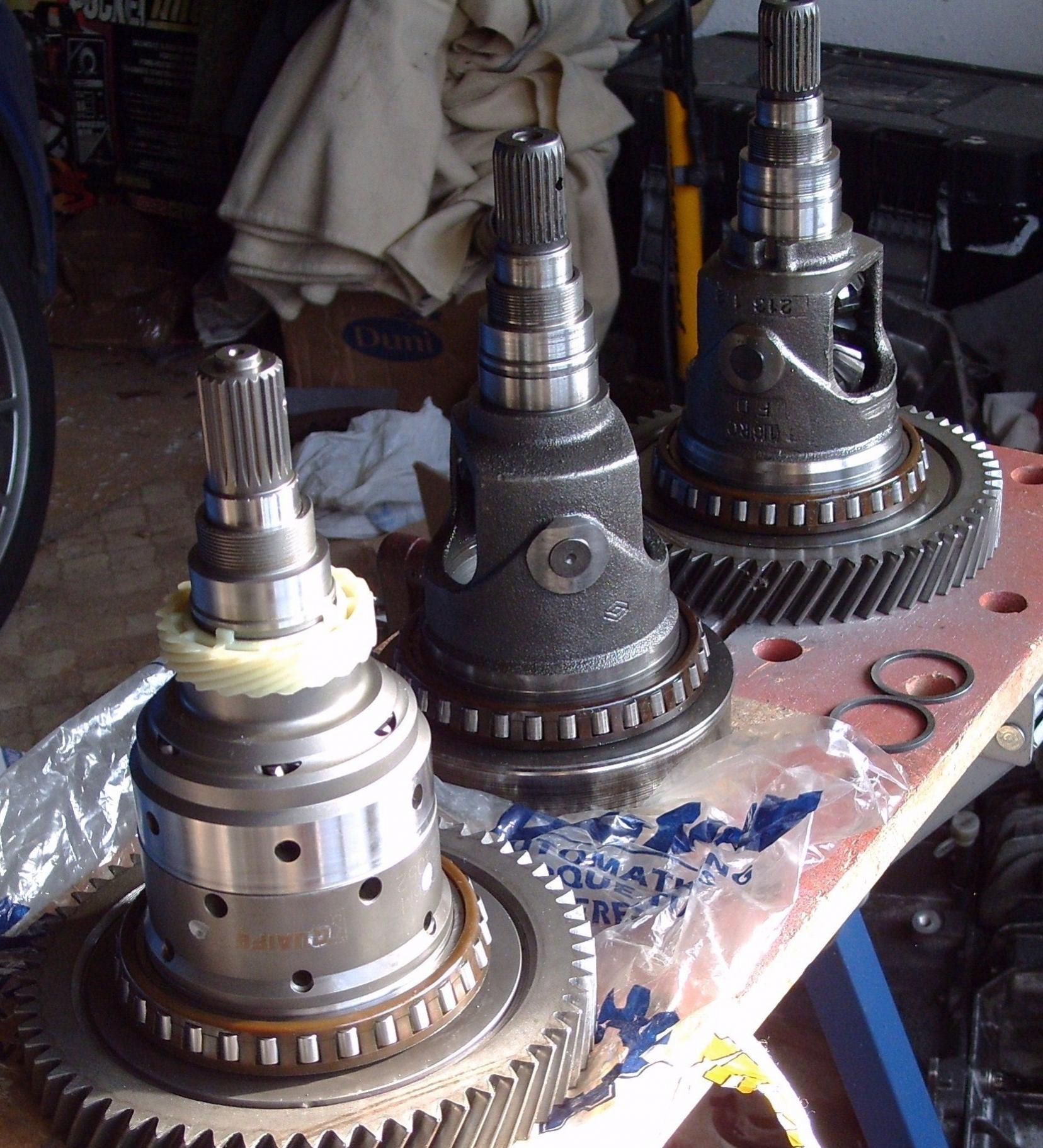

activ Car 172 cup & 182 Jun 27, 2009 #6 Yes, The speed sensor is driven from the nylon drive wheel on the diff, both the same. Attachments Quaife Diff 020.webp 325.3 KB · Views: 472
E en035 Car RSTUNER'ED-C&B'ED RS-1 Jun 28, 2009 #7 many thanks for the answers activ , it seems you have done this conversion before, and I see a quaife there as well. Best available.
