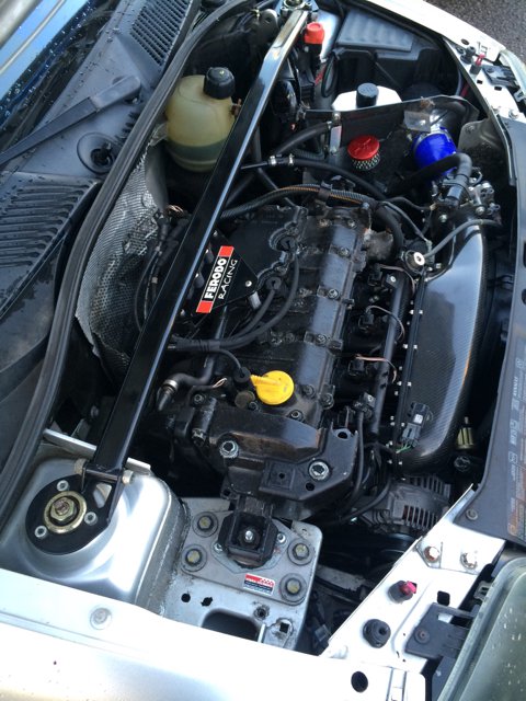

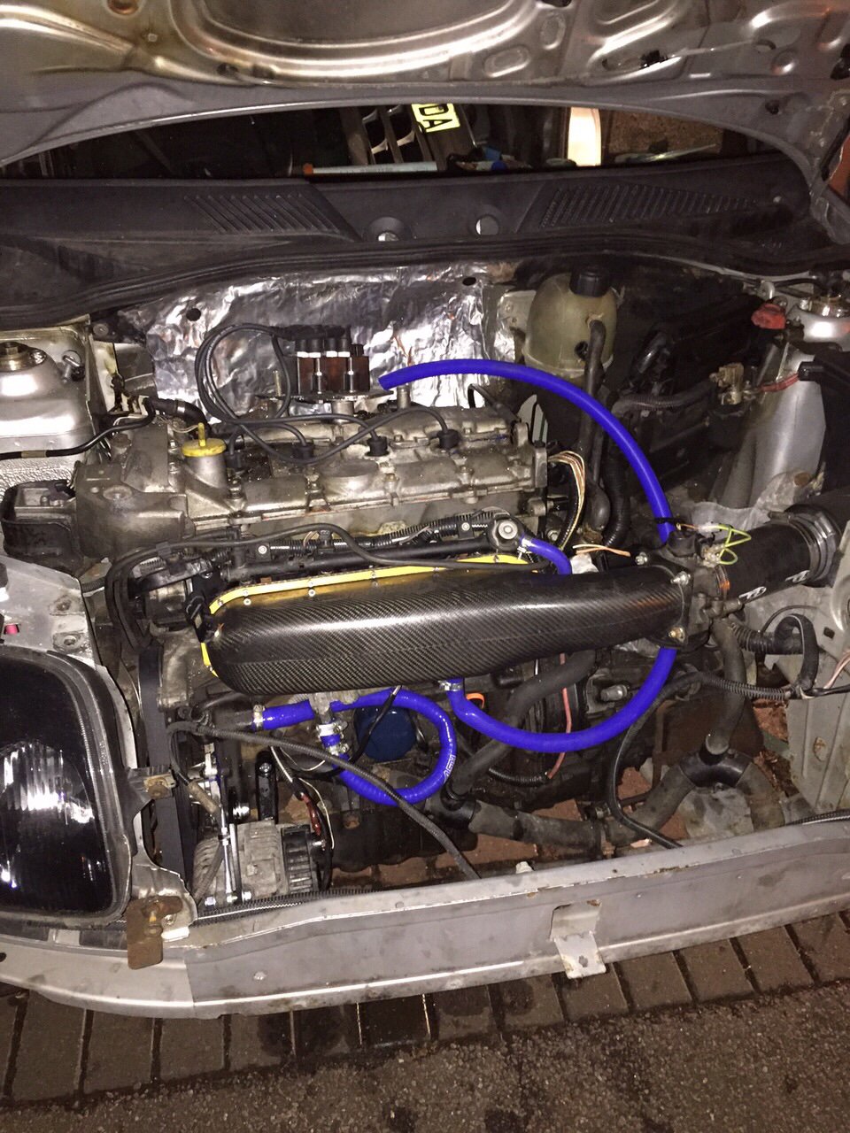

If you zoom in - as dave has said , blue pipe in pic centre goes to the servo pipe connection
But as you can see on my Ph1 with the RS2 inlet - my troubles were to achieve additional outlets for the idle valve and vac take off for the fuel pressure regulator . You have it easy [emoji23]

mine was similar, been on both but most recently on a phase 1 and I fitted it to phase 1, was dead easy just bolted it on and connected up the pipes it cam with to the services on the car they fell close to.

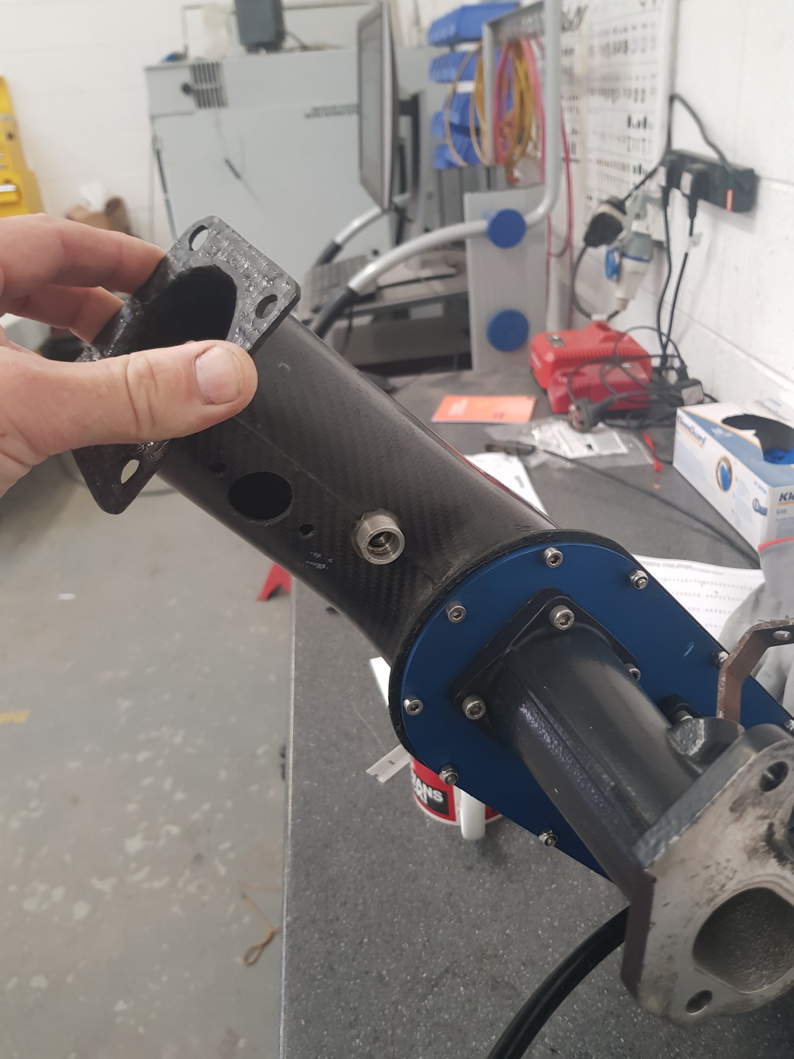

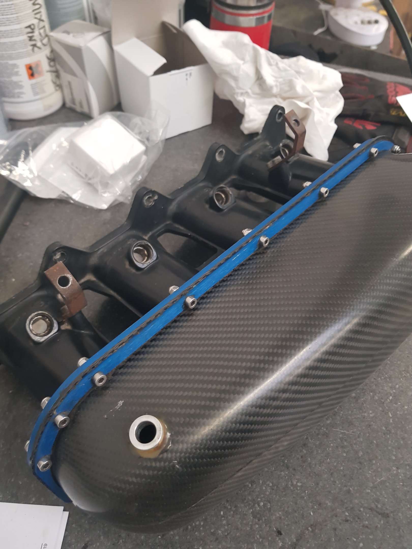

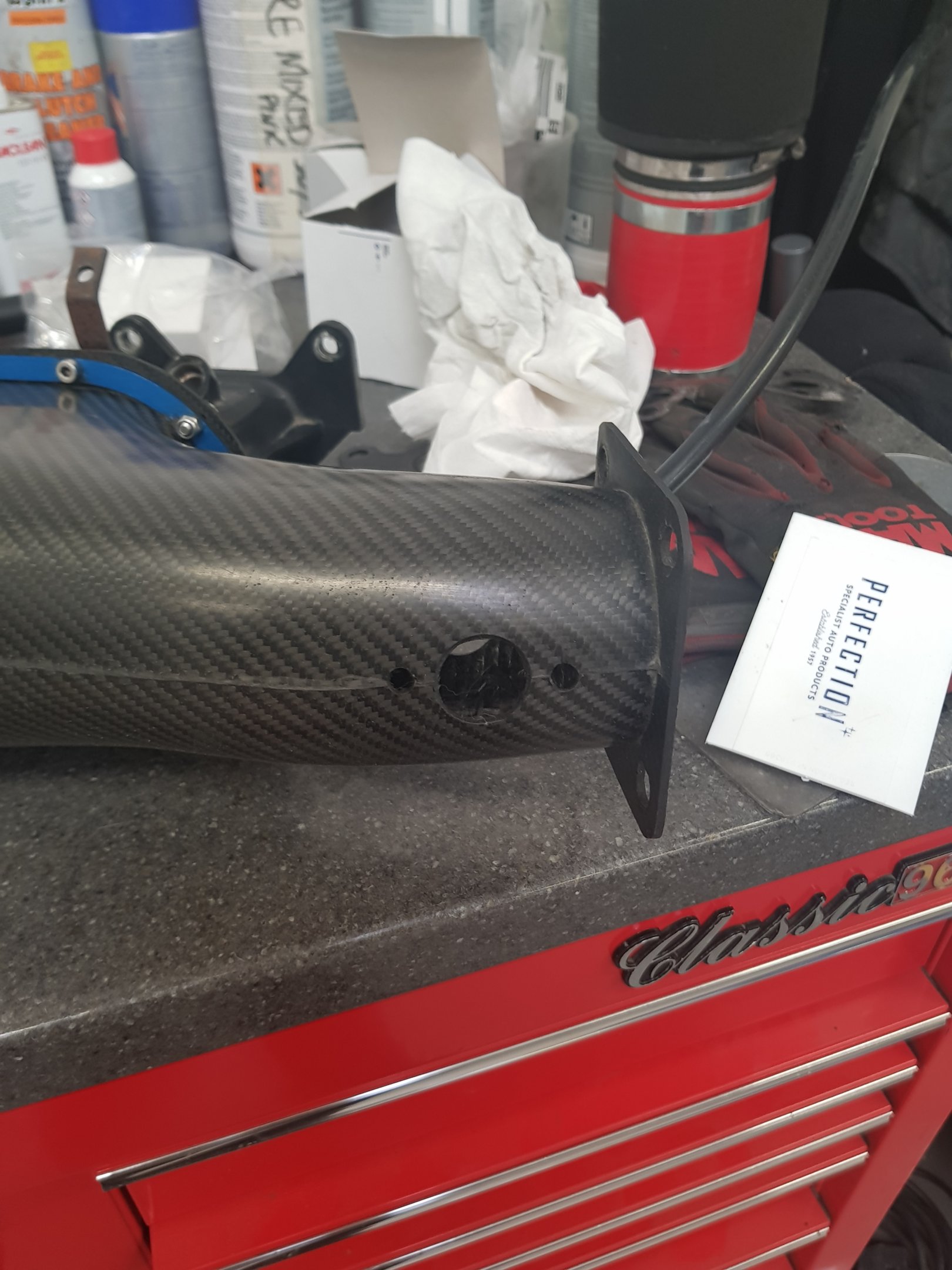

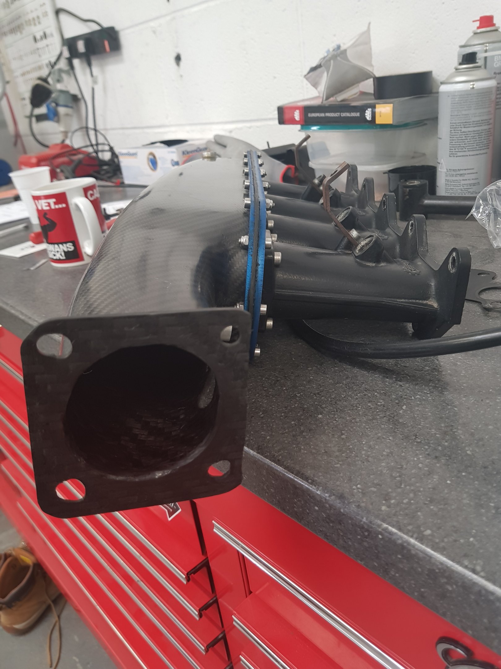

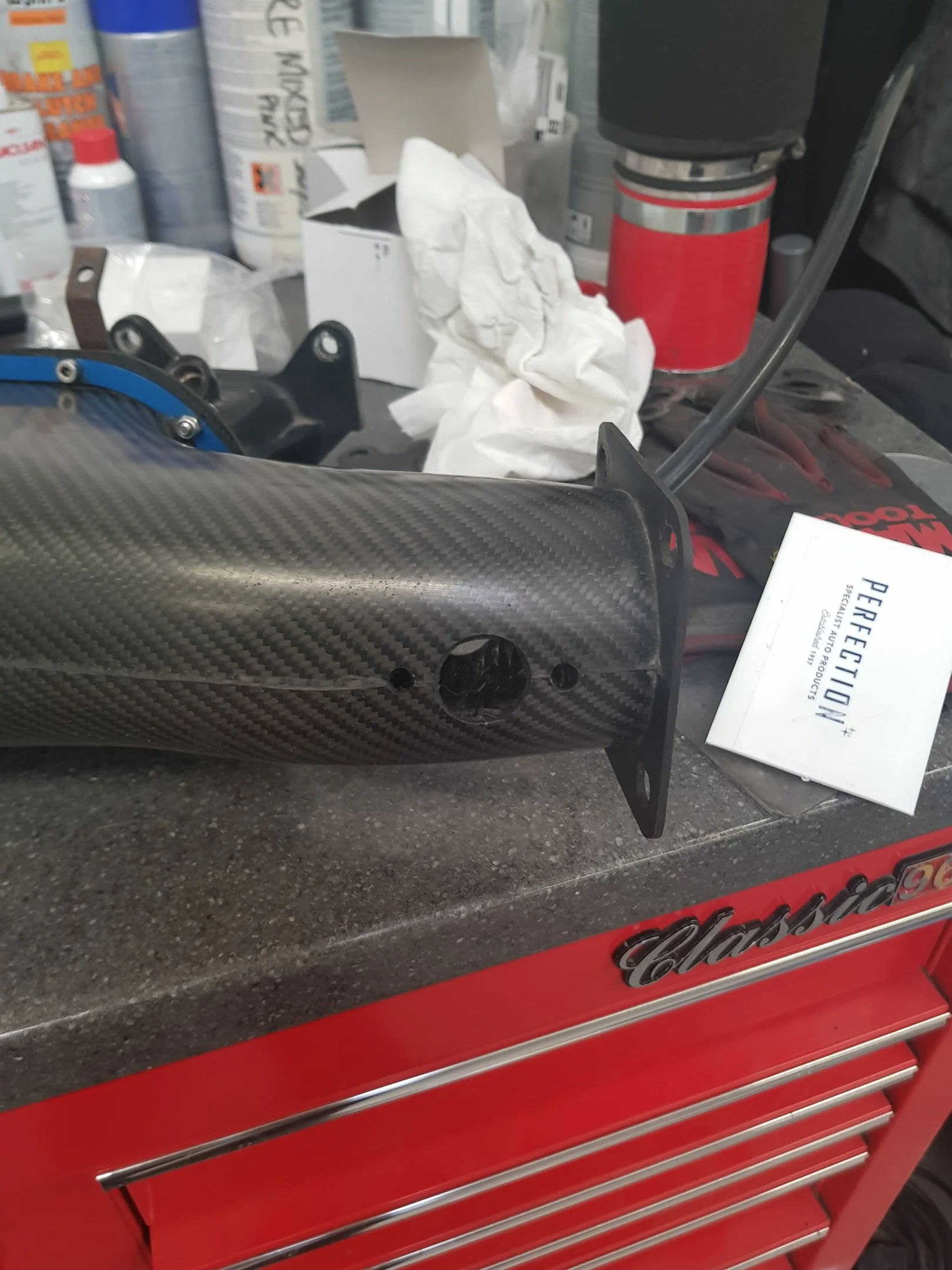

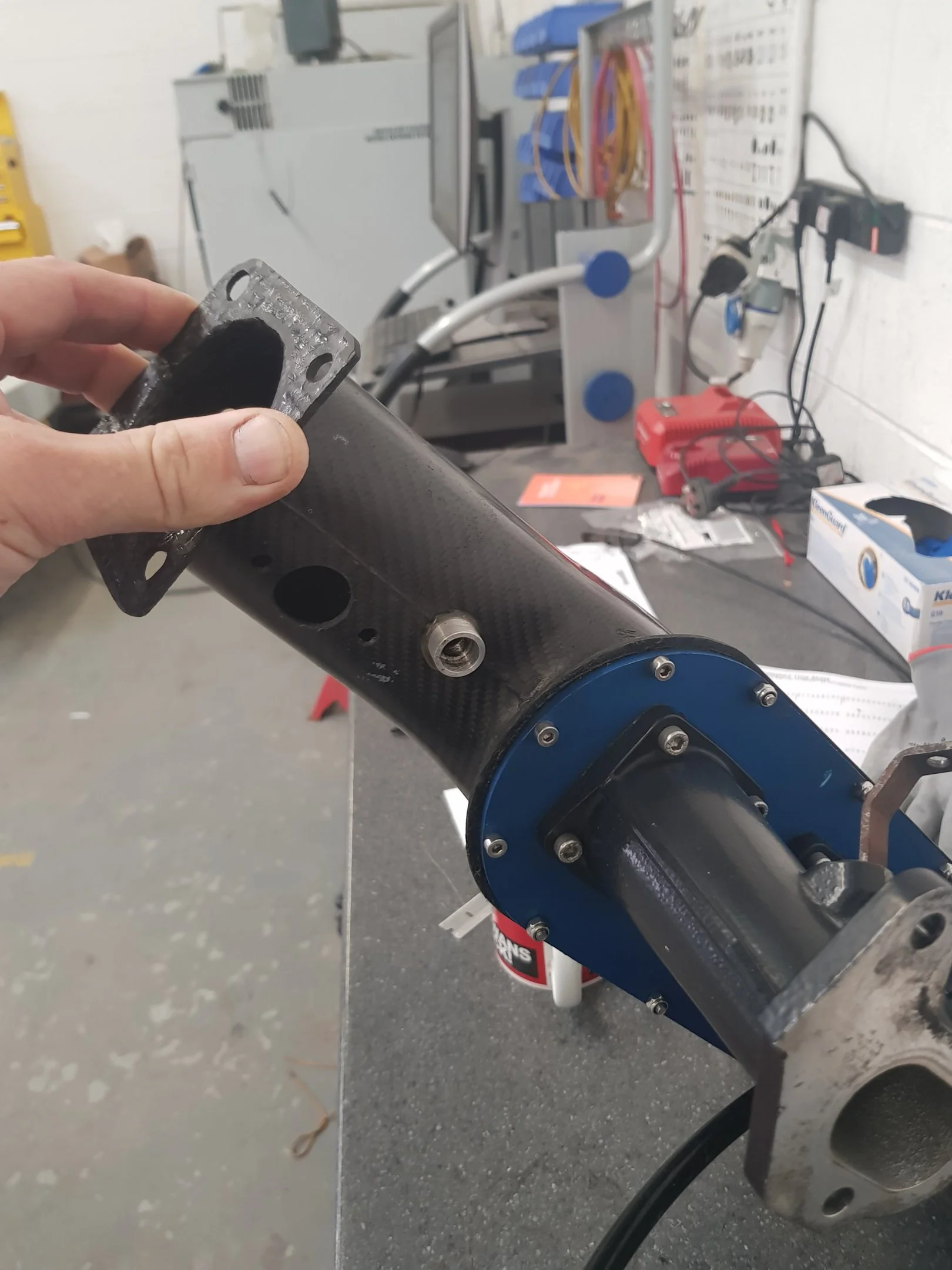

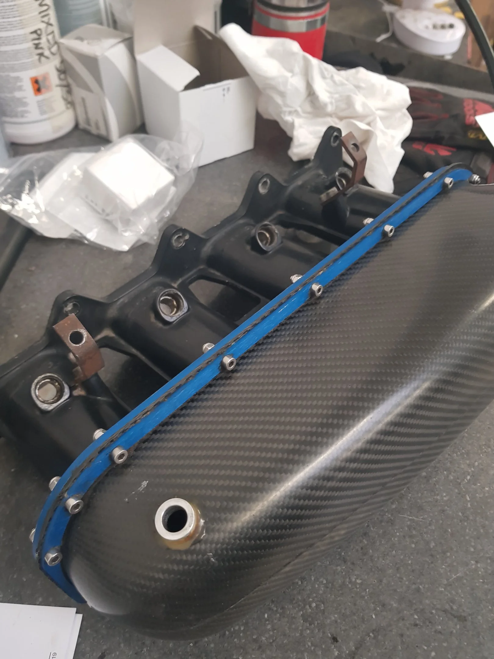

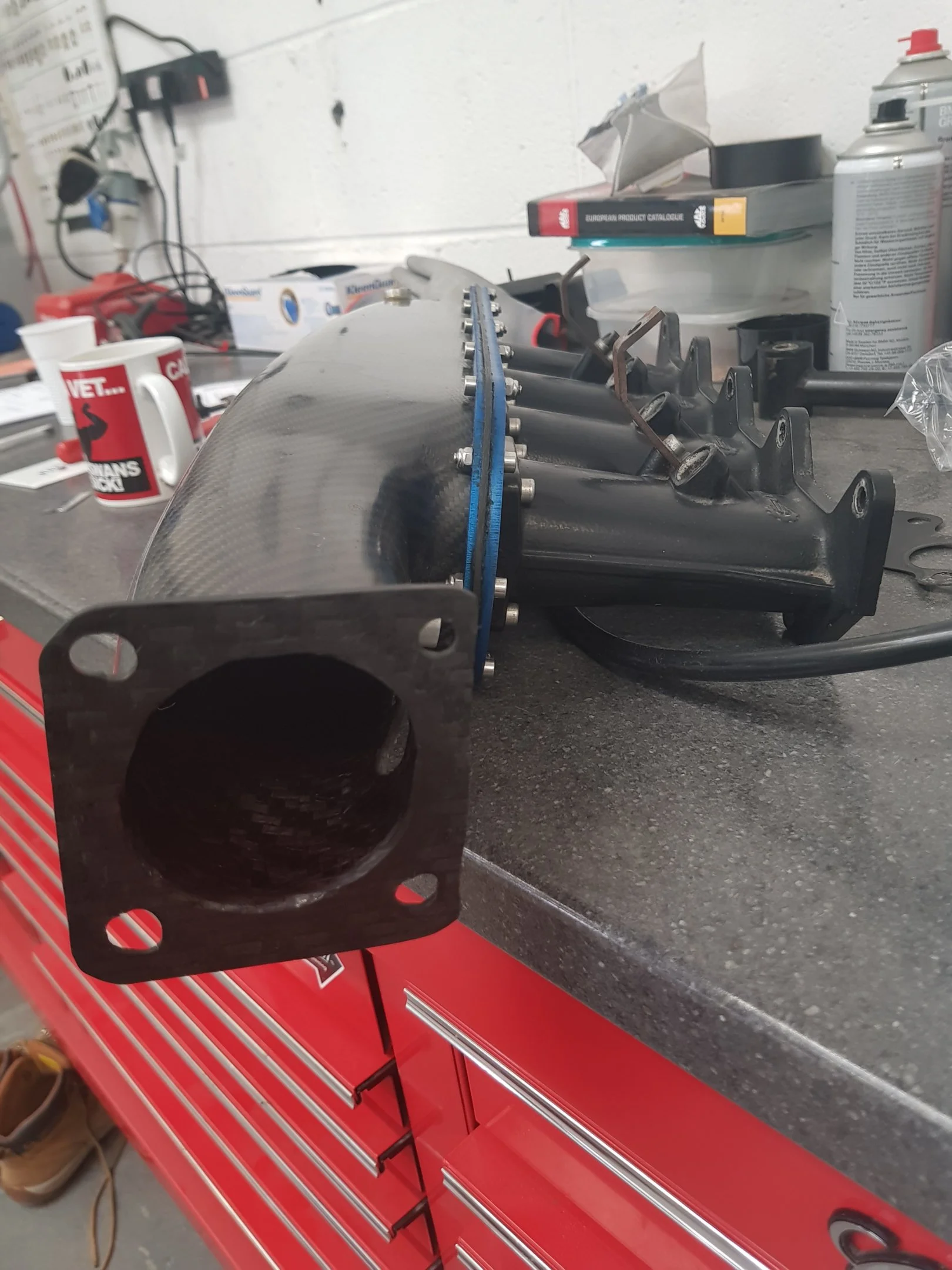

This is what I have

Christ , it's got a big hole where the idle valve went [emoji15] . Looks like no resale thought went into that when they did that lol. That'll need sealing . Good luck with that .
Or I spose you could just put an idle valve off a Ph1 to seal it up .
ah Christ that's been butchered, mine uses a small hole and a adaptor tube off the idle valve, didn't have the valve bodged directly onto the manifold!

That's why I did what I had to do to get mine running without touching the manifold itself . Resale will be plug and play if it's for a Ph2 owner .
