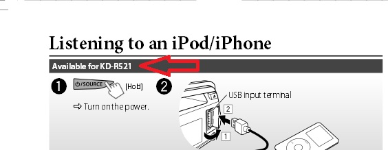

since i have nothing better to do i looked further into this for you, the 421 is not compatible with ipod (i remember something like this when i used to sell them - as i was honest in telling people :p), the instruction manual section that states about ipod compatible models under the title for the page that the ipod stuff is only related to the 521 model.
the manual covers models -KD-R521/KD-R422/KD-R421/KD-R45, so covers functions for all the units, but a load of '*'s and small text states which model each feature applies too.
sorry for being the bearer of bad news - and the laziness of using paint instead of photoshop
