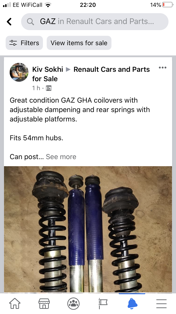

  Whichever has fuel
Thanks for your response! I'm glad I asked the question now as all the feedback seems to be pointing the same way! I'll look out for Gaz and BC coilovers to see if any come up second hand 👍
There’s a really clean set just come up for £350 on Facebook market place. 54mm fitment.
