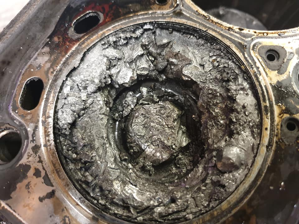

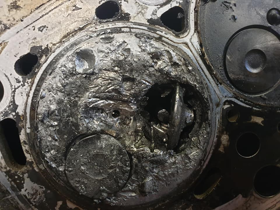

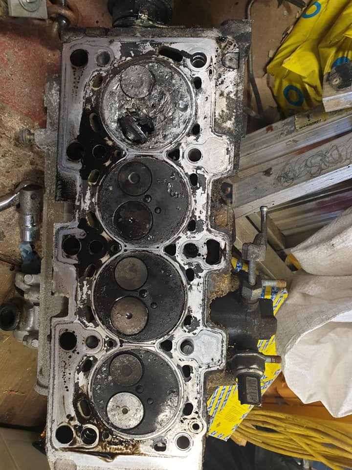

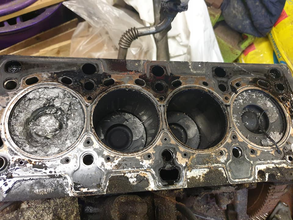

Here are some pics of a dCi 100 I pulled apart that decided it didn't want to live anymore
That's the aftermath of dropping a valve at 80mph and then leaving it to lock itself up until it has so much tension on the belt that it melts the tensioner roller too (the lass that owned it was oblivious to the fact that it even dropped a valve and started clattering like an orchestra of tamberines)😂😂 It destroyed absolutely everything on that hole. I didn't even bother salvaging the block or the rods because of the state of it
