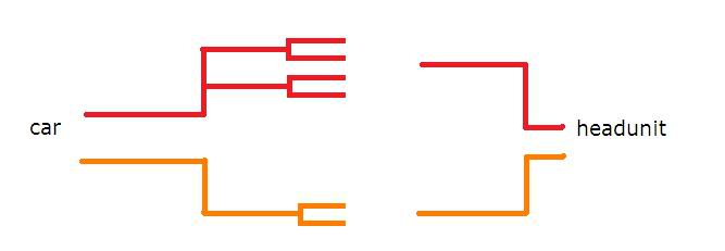

OK, have a kenwood headunit. Used to be able to get power without turning the ignition can't seem to do it on this kenwood.
I have two leads coming from the car. One red and one yellow. However the red lead has two power attachments.
Coming from the stereo side, again one red one yellow plugins.
diag...
current connection is yellow in yellow, and red in red (doesn't make a difference which red, still needs the ignition)
Any ideas how to get constant power?
Thanks
You switch them, my sony was fine like this but after installing the stalk controls I had to switch them.
