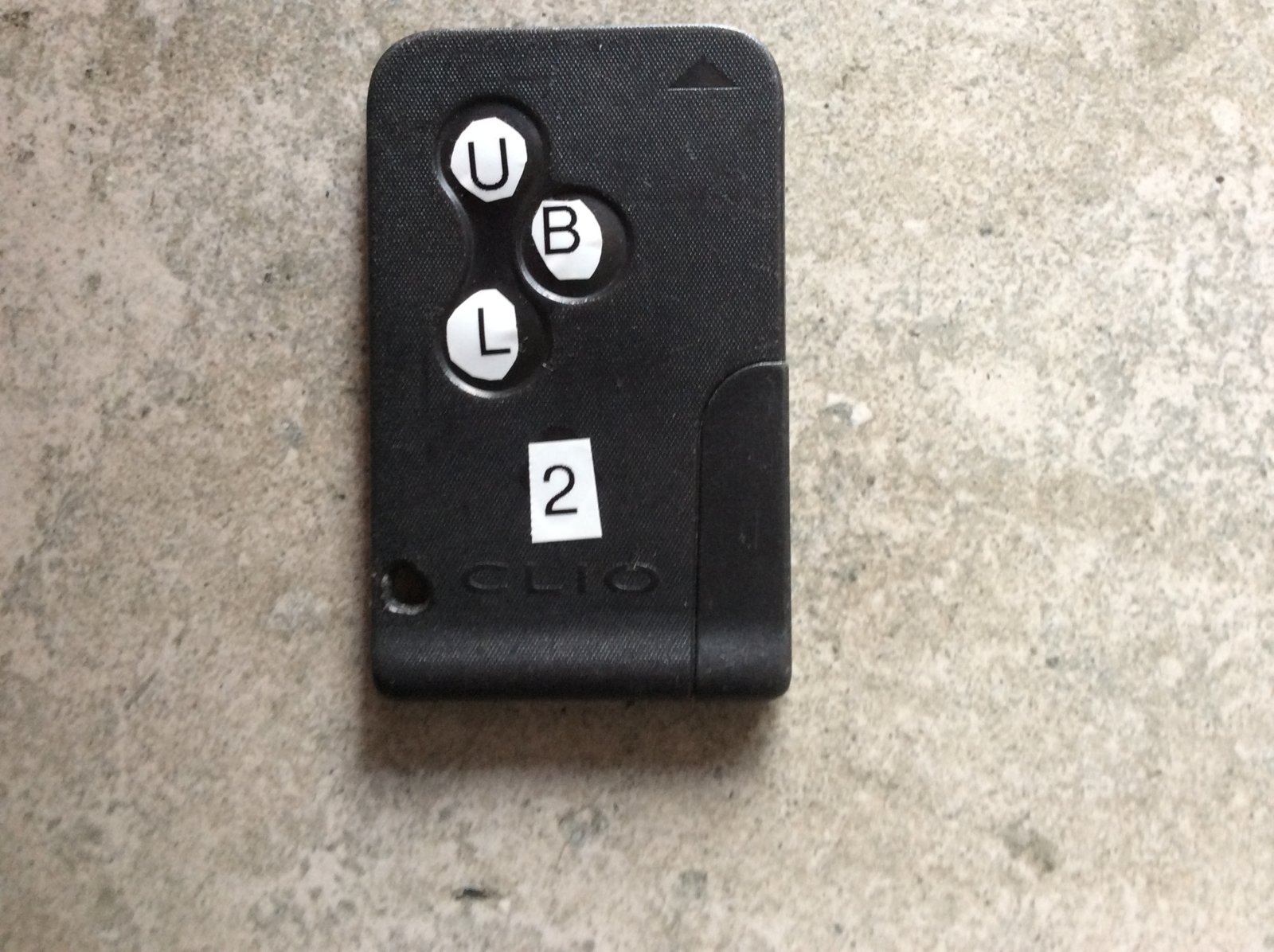

Hi Guys I’ve only had the 2010 Clio RS one week then the key card was not recognised! I had the spare key card at home and that one worked
I’m sure this is a common problem can you suggest a fix ? I have put in new batteries ... is there a page on the forum?

Here it is take no notice of stickers?
oh the classic Renault keycard!!
we have the same ones on our 08 grand scenic and all I can say is they are the worst car key ever invented. we have had nothing but issues with the shitty things.
don't bother trying to repair, buy two new ones, go the renotech in chelsmford and they charge £25 to reprogram the cards there and then.
no recognised means the coil is no longer attached to the board inside

Ok thanks for that :( I’m new to the key card game!!
I made a post about mine on here a few years ago.
once you rip it open to repair, you will never ever get a proper case that stays sealed again.
you can pick up a new key card for 10-15
