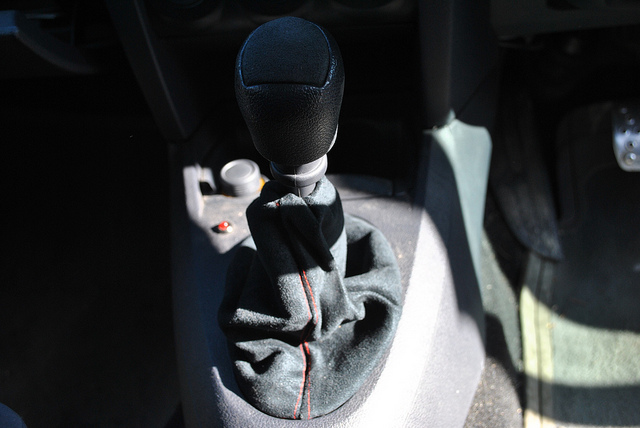

When i replaced mine with some faux suede i drew the template of the original gaiter then added a few inches to the top of the cone and left it big enough to slip over the knob then cabled tied the excess to the stick. Works wonders :)
This is what it looked like
