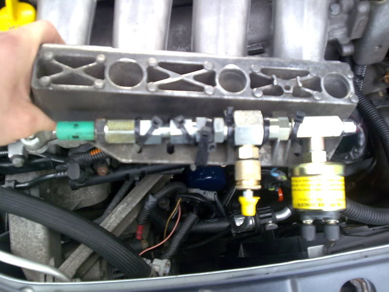

I was checking today to see if my standard oil pressure switch was leaking at all (and its fine) as i refitted in back to it original location on the engine block yesterday as my oil gauges are disconnected the now as my oil pressure sender has started leaking oil where it screws into the t piece i made up :(
