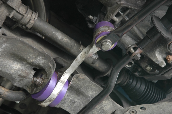

Dog bone is located under the car. It joins the lower part of the gearbox to front bulkhead. The bushes wear and allow too much movement at the bottom of the engine/transmission. The symptoms are usually a knocking or clunk on pull away. Its the exhaust manifold hitting the bulkhead as the bottom of the engine moves too much. I polybushed mine with some powerflex purple bushes, £50 ish and it went straight away. Was an easy job and it makes the gear change a little sharper.

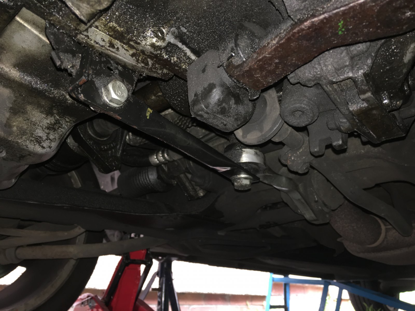

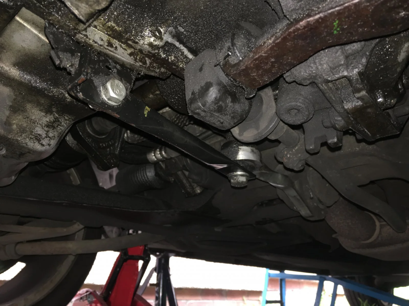

The bush that connects to the dogleg to the straight adjuster is split and not great, can't get the bigger bolt off the dog leg so unsure but doesn't look amazing in there,
Also how do you tighten the adjuster up ?

Ah ok, so when tightening it up how do I pull it forward closer to the front of the engine to stop the banging noise ?
Found this guide:
So I don't have to worry about doing anything to the black bar nearer the engine ?
