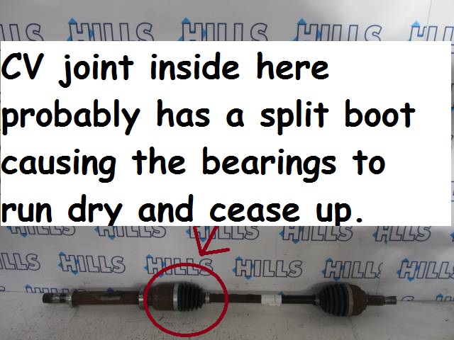

I have a knocking (and have had for a year and a half, no garage can find the issue and I mean specialists aswell..), happens when I'm braking and turning slightly. Also happens when going fast on motorways for example and turn slightly, and also happens when driving slowly and turning left. Knocking is from the right side. Can feel it through floor and steering wheel. If anyone can help, it'd be brill.
Had balljoints done, track rod ends, calipers, slider kits.
  Astra GSI, 172, Golf
feels almost like a badly warped disc ? and can feel it through the steering wheel ?
just re-read what you said... my guess its this.
  Suzuki Ignis Sport
Hi guys,
Had new discs and pads, also new calipers. Why has nobody ever picked up on this CV joint issue? Ive done over 20k miles with this knocking. How much is it to replace the cv joint? Or is it a new drive shaft? If so, how much would I be talking for a new driveshaft fitted? :)
