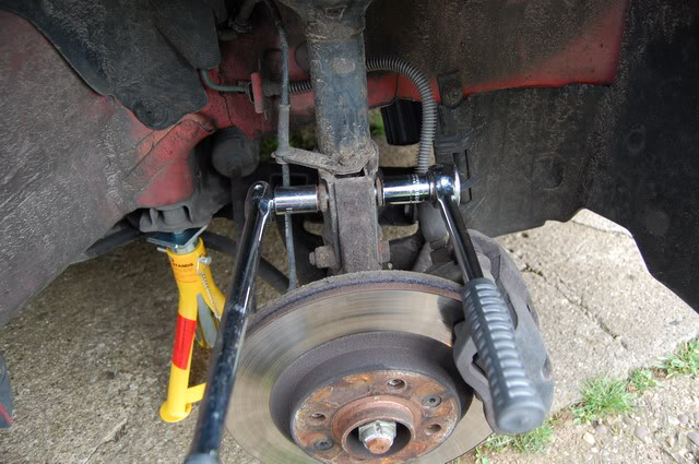

The bolts haven't been tightened properly at the wheel Check these,

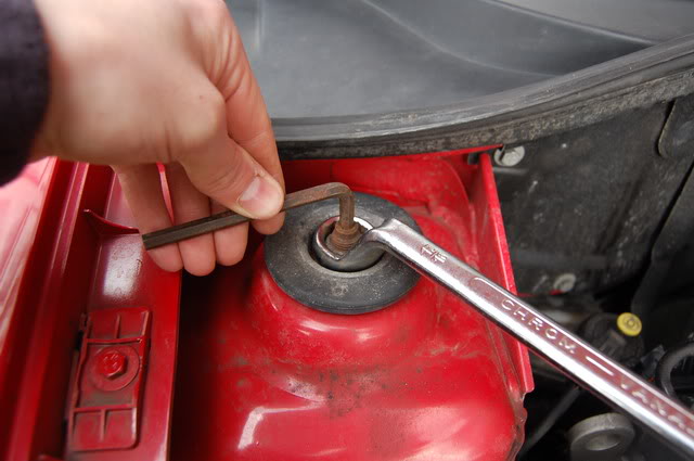

Was the shock arm taken off? The top bolt on top of the arm under the bonnet could be loose, check it and tighten that too:

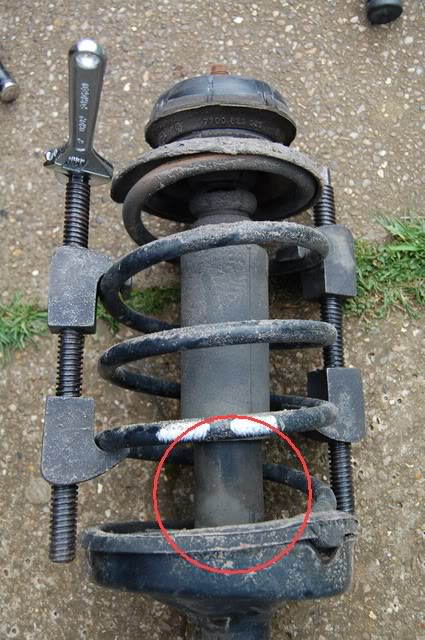

If the shocks gone check for signs of wet parts on the arm or covering that looks like 'oil like' fluid,
if it's gone that'll be the tell tail sign it needs replacing.
