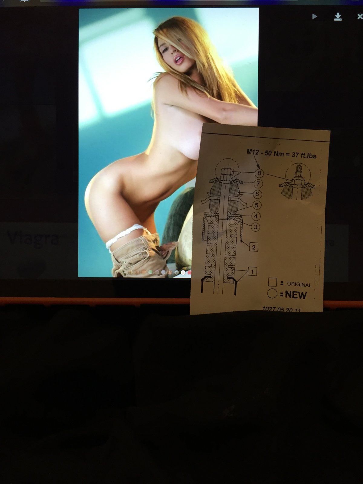

Can someone please enlighten me as to which order all the bits go, such as washers dust boot ect
Thanks

If its the rear koni damper your on about then from where the piston goes into the damper,going upwards im sure its....
White washer
Original bump stop
Circlip
Small washer with grove down
Big washer
Rubber with round facing down
Car
Pyramid rubber
Washer
Nut

Thanks for the help chaps, forgot to mention it was the rears,
just got In from fitting them it turns out I had every thing in the correct place just couldn't get th nut to start in the car and needed my dad to start them while I pushed up from the bottom. :up::up:
