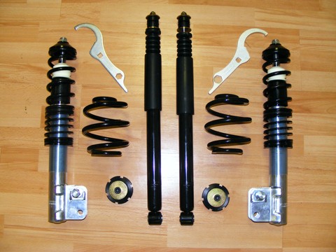

SPAX coilovers:

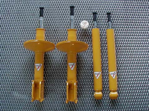

Koni with eibach pro:

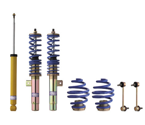

K-Tec Coilovers:

i have the koni and pro combo
i love it
adjust from soft to hard - works good on the track also
  Charged Superleggera
i would probably stick with your current set up. i had prolines on standard shocks and i was very happy with them so with konin's it will be even better. if your looking to lower the car more i would go with spax.
Wouldn't touch Spax with the proverbial. Sounds like you've got the best pick of the bunch with what you have already.

I have koni and eibach sportlines on mine, at the softest it's a bit harsh on the poor road surfaces so round towards the firmest settings I imagine they'd be good on track.
K-Tec Racing
ClioSport Trader
  172LBT-172HBT-197-R2
The spec of our kit is very similar to that of the FK kit and the KW V1.
I hope this helps and the fact we had to have 100 kits made means we are able to offer them at such a good price. If we were to only order 10 sets at a time the price would be closer to £500 for the kit.
David.
