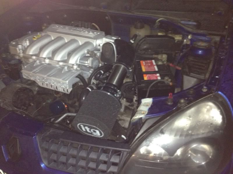

​this sounds the dogs mate, where do I get one ;)
Its one of these filters; http://www.ebay.co.uk/itm/ITG-Maxogen-Air-Filter-Cylindrical-70mm-Neck-ID-/400409609855?pt=UK_CarsParts_Vehicles_CarParts_SM&hash=item5d3a45c67f
And then just order the silicone hosing to make it go where you like, i run a polo rad so mine sits above it as below. But you can use two 90' bends and make a ktec style induction kit if you like, or use 3 bends and put it behind the fog light. That parts upto you :)
Outside vid of the noisey bucket.
