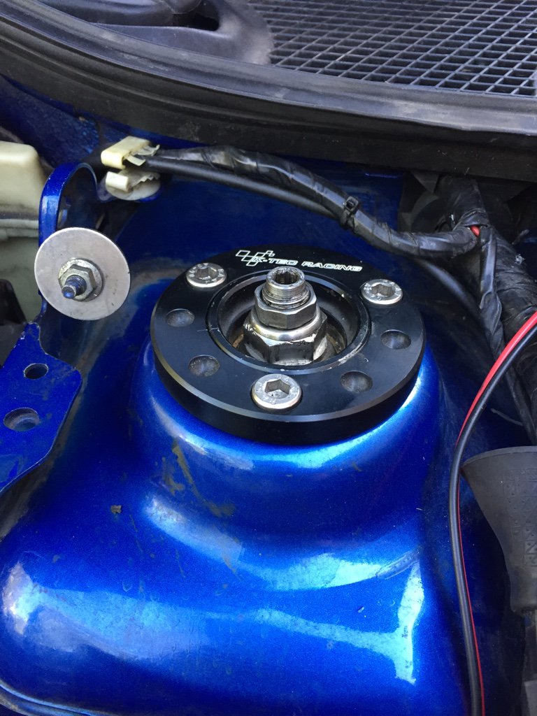

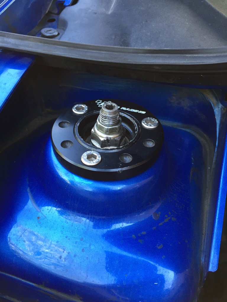

Fitted some KTR top mounts today and have ended up with different length threads at the top even tho both sides are as side as they can go.

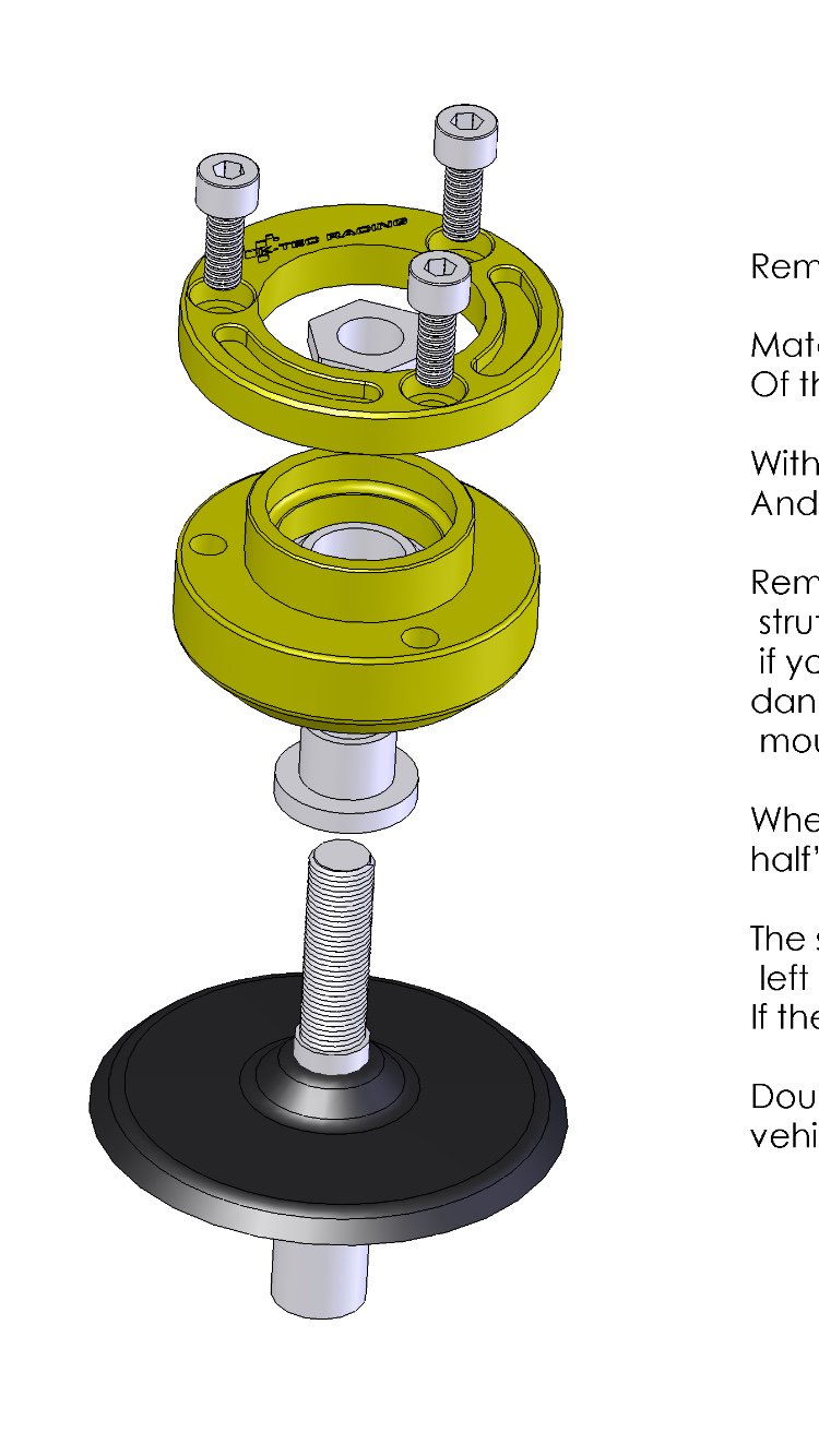

I don't know if I'm going mad but the instructions K-Tec sent me show a little tophat shaped insert that goes in between the spring top cap and the lower part of the top mount.
I'm not sure if I'm going mad but I'm sure that this part came off of the OEM top mounts and does not go with the KTR mounts.
But these instructions do look like they are for the older style KTR mounts.

Yes going mad! Missing the top hat spacer on one side which explains the thread difference.
Hopefully be able to get hold of the spacer!

That little nut I just added as a locking nut which I read about in other threads.
Hopefully spacer will be sorted soon.
