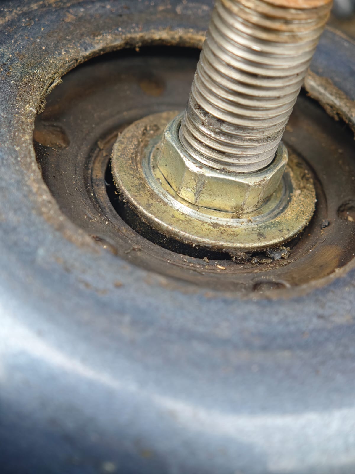

Good afternoon,
I've had my clio 1.4 16v on the lift yesterday and found quite some up and down play in the wheel. It moves the whole control arm with it, so I believe it narrows down to the top mounts.
The top mounts have been replaced about 2 years ago, or about 50k km ago, when I replaced the struts and springs.
This thread has been very helpful for me. I believe i have the old style mounting with the new style top hat (with integrated lock nut and extra protrusion on the bottom)
https://cliosport.net/threads/172-new-top-mount-modified-spacer-issues.641094/#post-9294810
Are the doughnuts known to be of bad quality and sag through, creating play? are there any better quality parts available?
MOT is around the corner and I think it will fail because of this.

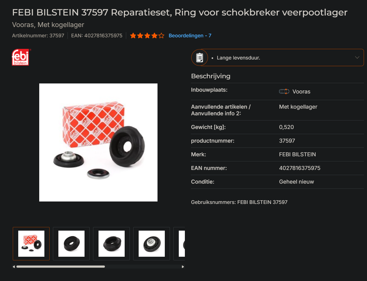

These parts are the ones i have used in the past:
https://www.autodoc.nl/febi-bilstein/7106425

You can improve the suspension but with different bits , you pointed out a thread where someone was showing different part to fit so you don t have that up and down play anymore and the tolerances are a bit thight , im running the same stuff and i can tell you the difference is massive .

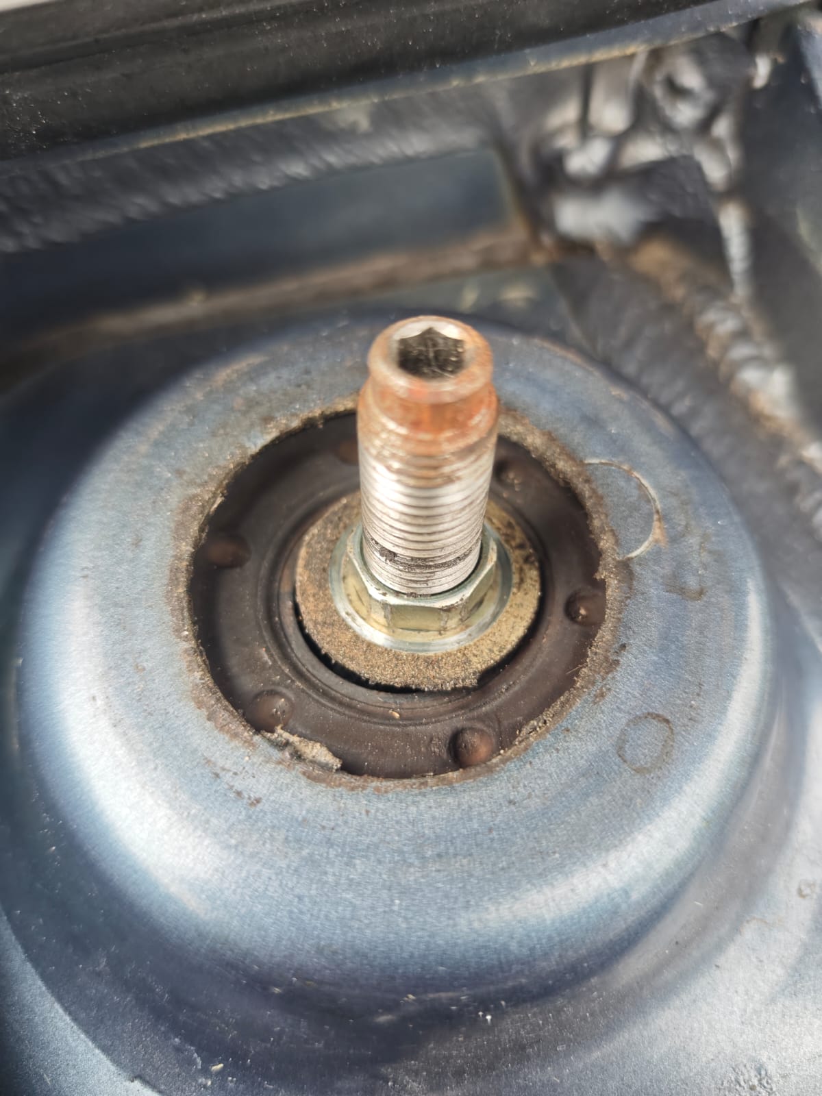

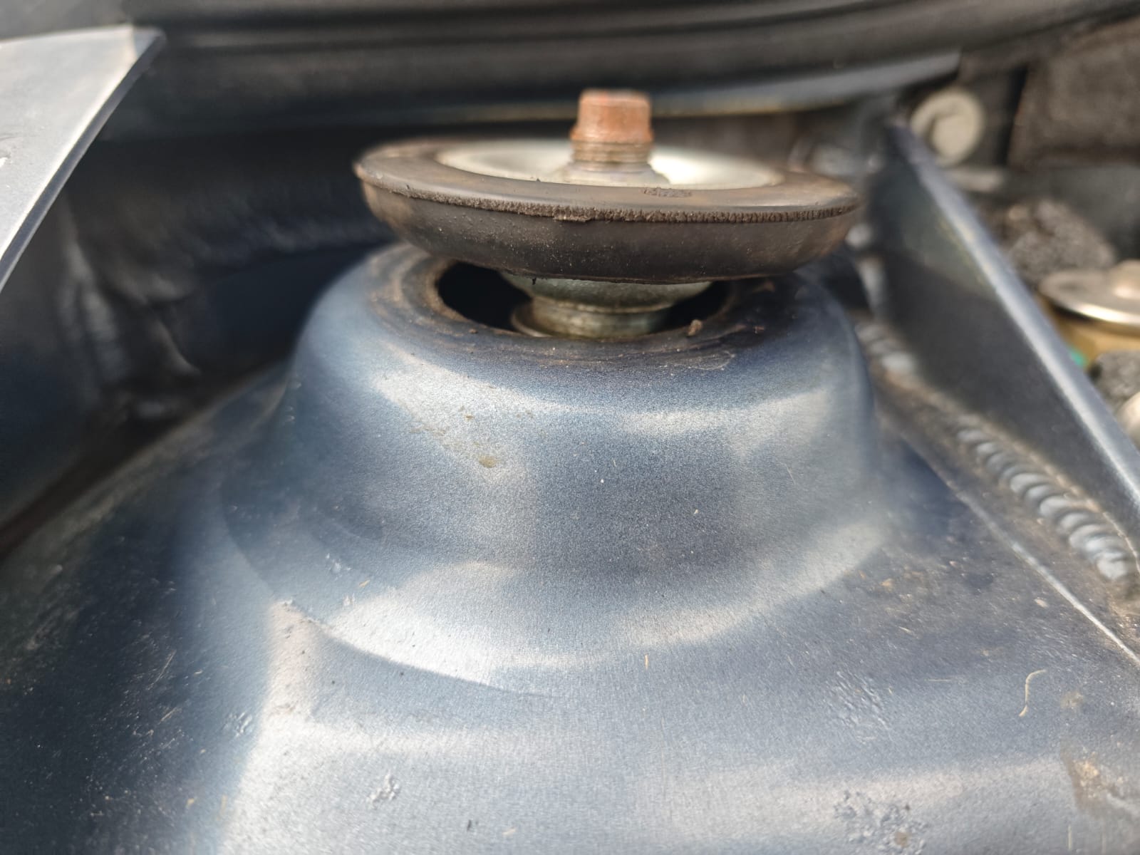

What modification do you mean? Im fitting the new top mount and bearing now and the play is still there. Im tempted to turn a few mill off the bushing to get it clamped on the rubber.
Im sure once in the car it will stay put under its own weight (until the rubber gets deformed again). Still how can this design be any good!?!

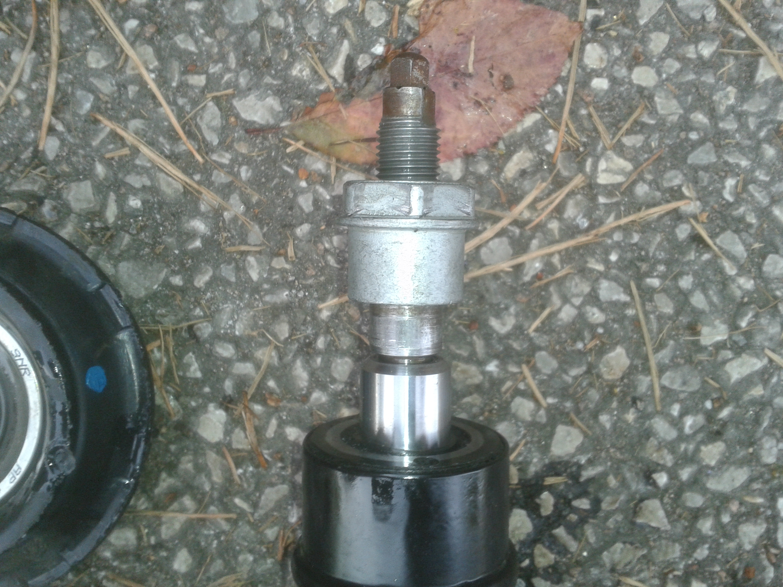

You got the tiny nut that holds the top mount and under it theres a spacer , the uprated version theres a 22mm nut with spacer included also the top mount has the middle hole made for that 22mm nut .
I will post some pics so you understand
That s the uprated nut and has the spacer included for that thing you need a top mount also the top hat that you put on the outside there s 2 versions , one the is flat and one that has like a spacers that is curently on your car .
Hope that it helps , sorry english is not my maternal language .
