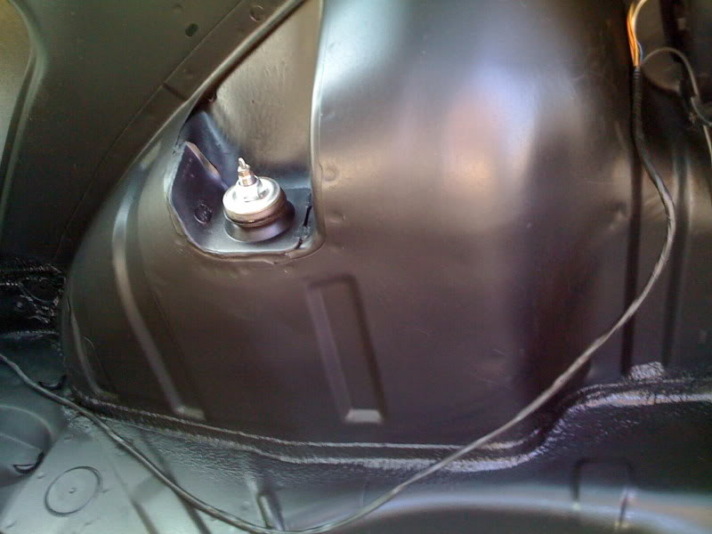

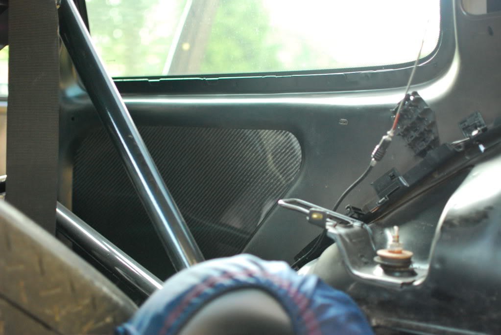

Any use?
Actually, no. That's not in car at all is it..... :o
If it's the top mount you're after I don't think I've got anything.

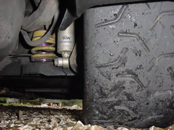

They are the two way competition kit, I'll see what I have, but the car is in birmingham and I'm in essex at the moment....
That's the best I can do I'm afraid.
It's been like that for a couple of years and a lot of track days if that helps any?
