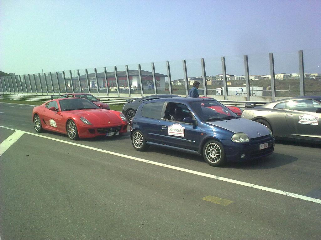

V2s are perfectly adequate if you use road tires on the track. Even with semi slicks such as R888, Pilot Sport Cup, they're still ok, although slightly harder would be better in that case, from what I've experienced.
For even better performance with semi slicks such as R888s, KW Germany advised me to change the front springs to 80N/mm (standard they're 60N/mm), I might do that in the future.
Here's mine with KW V2s + rear anti roll bar + Pilot Sport Cups
I found you can't have the car sitting too low either, to avoid rubbing. Any lower than this and my tires rubbed in corners:
