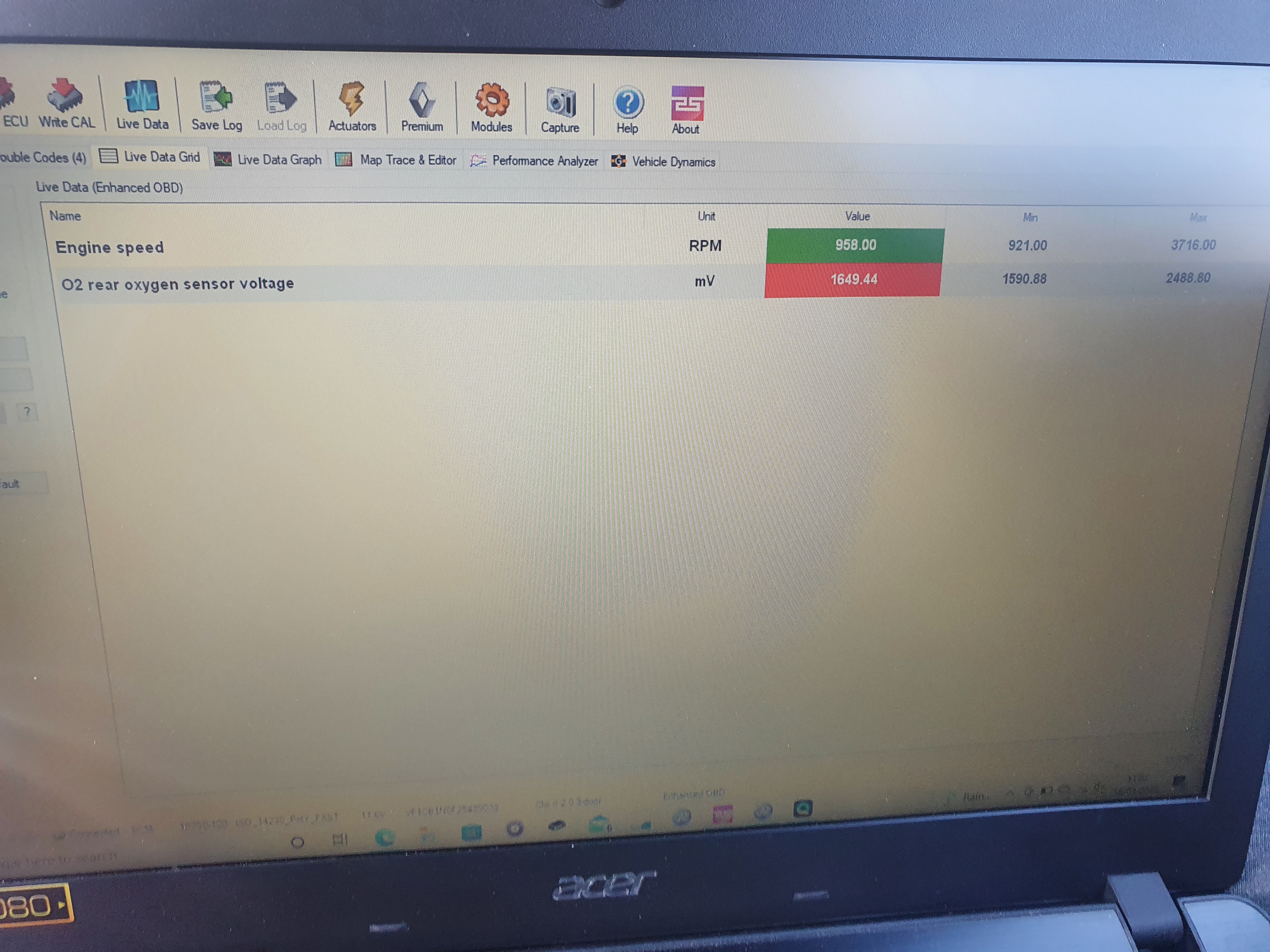

Anyone know what they are looking at here?
The fault is popping the engine management light up, I can switch it off but will come back on after a while.
Is it a problem with the sensor ir wiring or just the fact I'm using a sportcat that it's coming up?
Louis
I Park Like a C**t

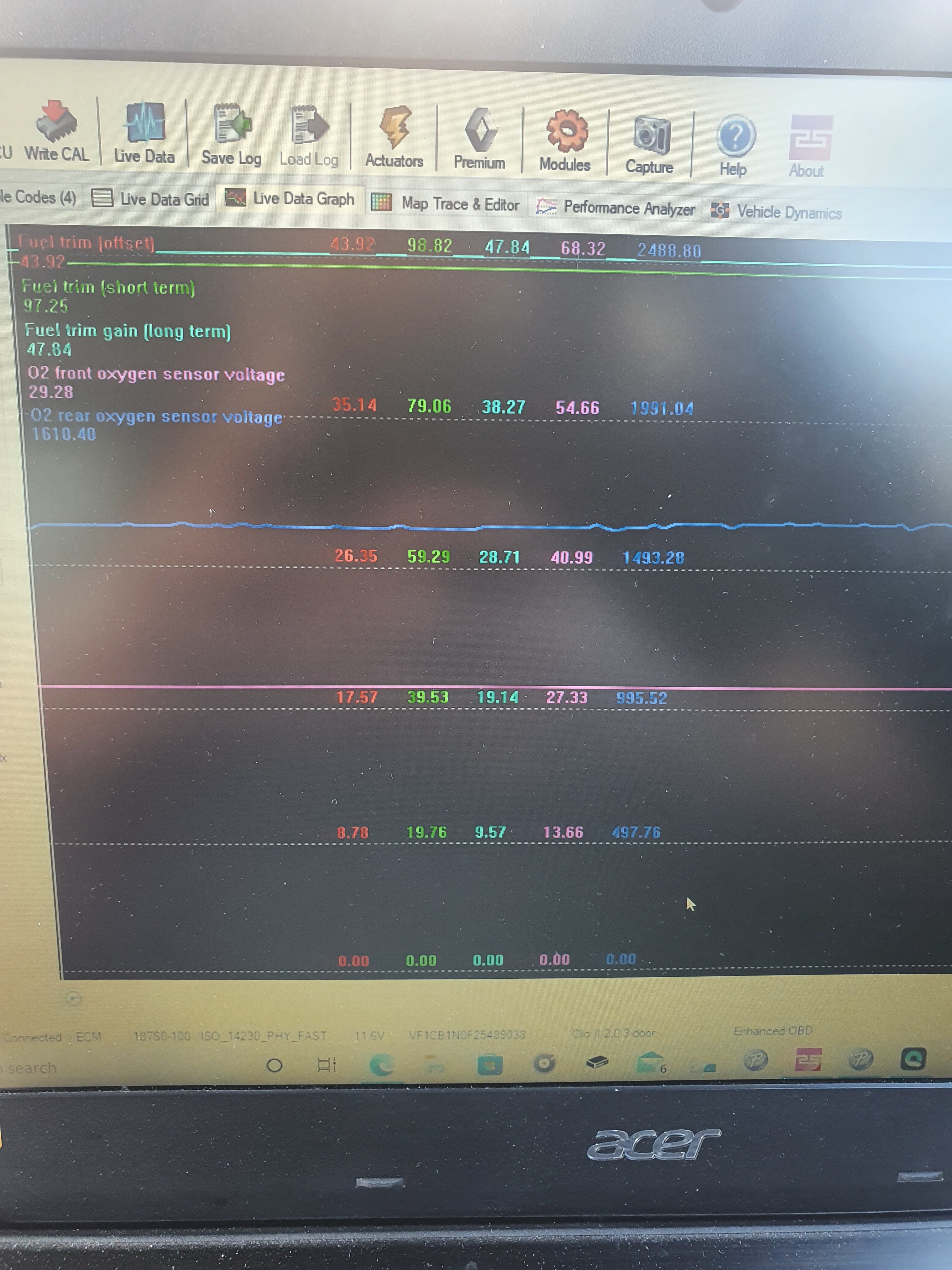

Looks like rear wiring is fucked, is the sensor new? Front should be constant voltage and rear tracking
RichValver
  Clio 16v/172 daily
Probably just the sensor that's dead, should be between 0.1-0.9v.
Also, your battery voltage is low too, 11.6v with the engine running isn't enough ;)
Iv not been using the car at all really, where am I looking for those figures. Noob here 😂

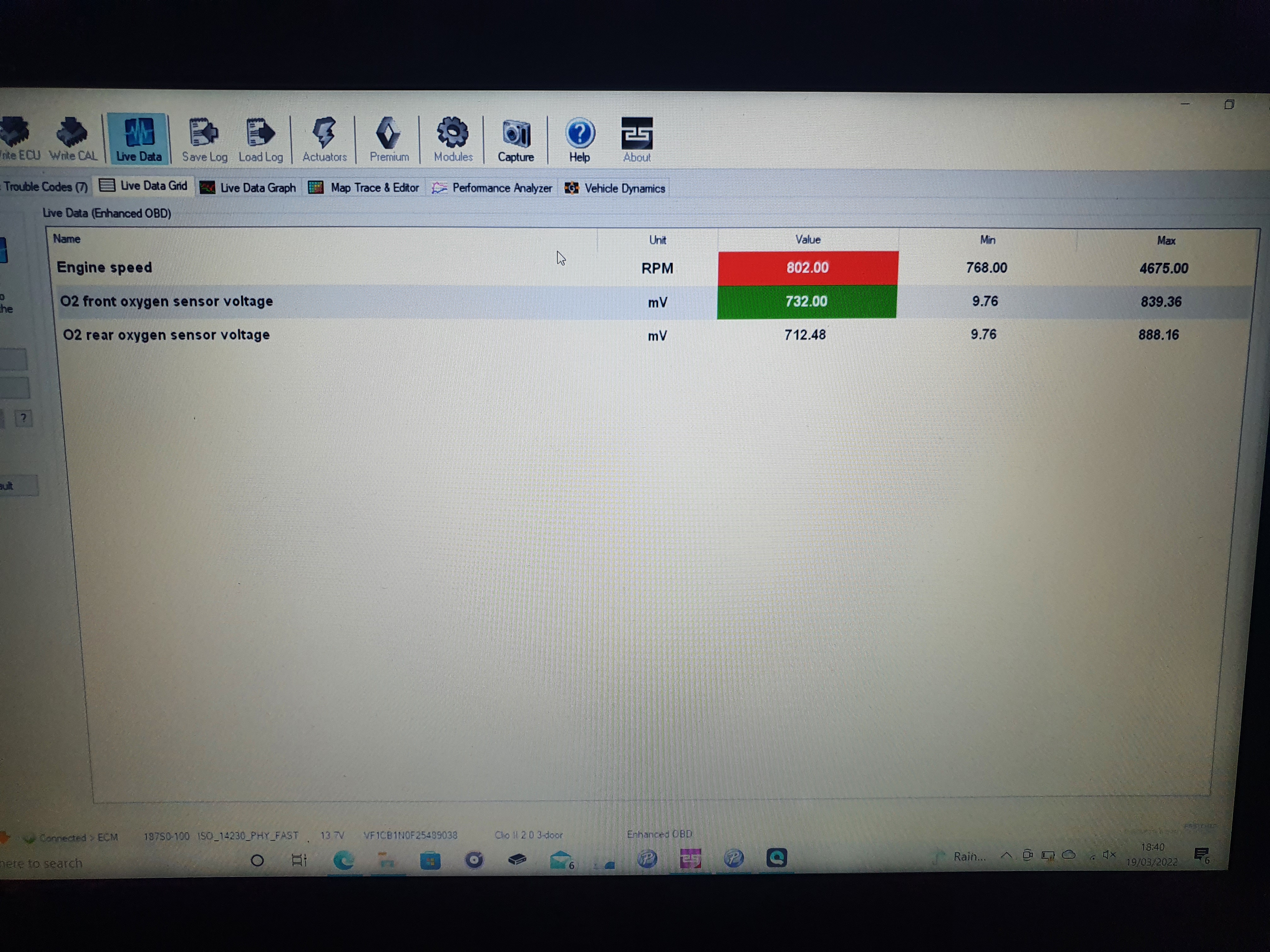

Replaced the sensor, hopefully this fixes the issue. Both sensors seem to be around the same figure now
