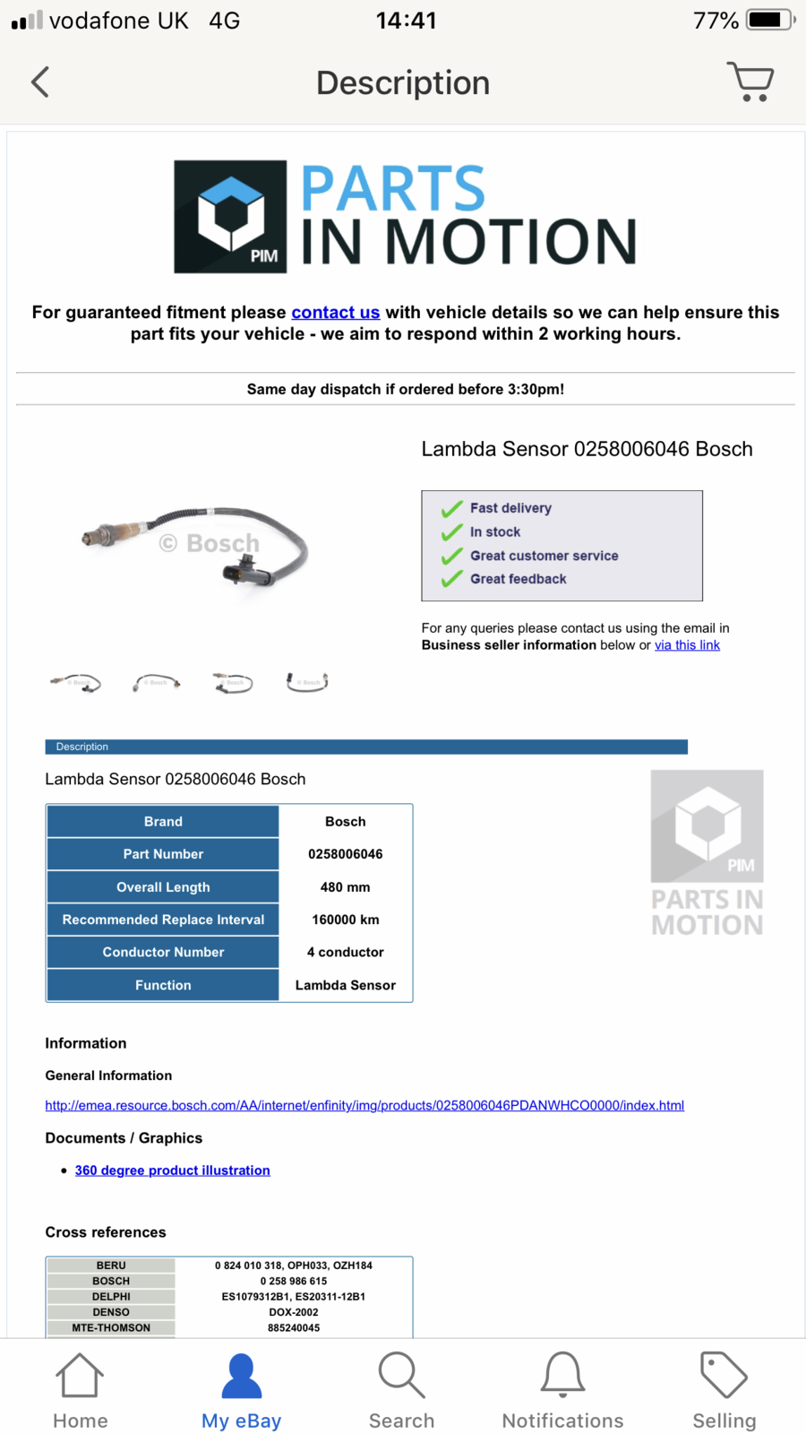

I bought a bosch one the other day for my 182 (pre cat). 480mm. £40 from Opie Oils after the 15% discount at the time.
Wasn't working and didn't throw up any error lights.

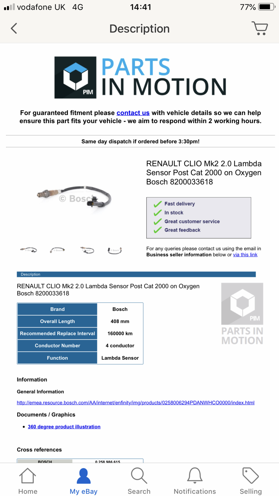

Hi Martin... I’m sue the 480mm is the post cat sensor?
The cables are both the same length.
The pre cat goes to where the subframe is and the post cat plugs in up where the heat shield is on the front section.
I’ve seen 408mm... 420mm... and 480mm for sale.
I’ve yet to take mine off to see what it is 🤷🏻‍♂️

Both the Pre cat and post cat sensors are the same. The only difference used to be one cable was longer than the other.
